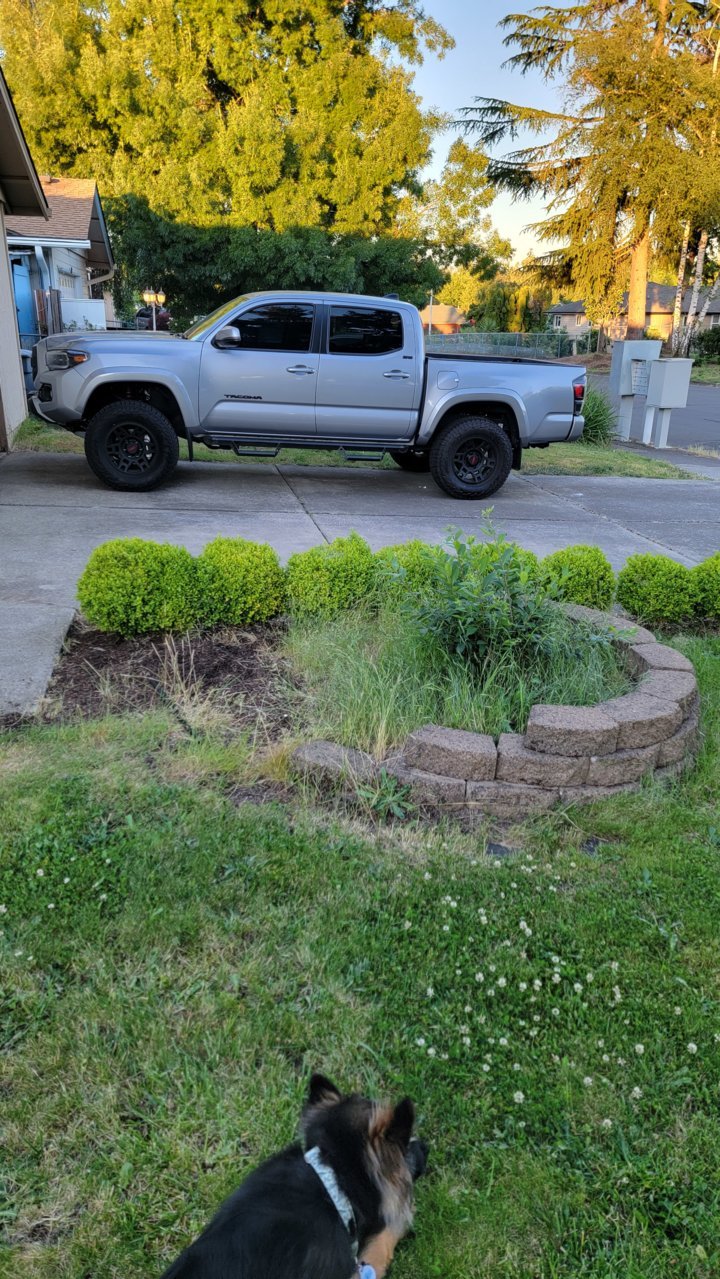

    You want 0 or negative offset wheels to get that poke, or use spacers. Lots of ppl around here use FN or method or TRD Pro wheels
    I have this TRD Lift Kit and I run Trd pro 4 runner wheels on mine, which are 17x7 +4mm offset. And I went with 275/70/17 falken wildpeak at3w tires. No rub at all. Little bit of poke. Happy customer

    That’s a great looking set up.
    How do you like those tires? What’s the road noise like? Did they effect gas mileage as compared to stock tires?

    Road noise isn't bad at all, or maybe im just used to it by now idk. My gas milage took a hit because the tires are heavier and I upgraded the wheels from 16" to 17". Bigger wheels and tires usually affects gas mileage and speedometer. Trade off is my truck looks better and actually feels like a truck again. I ran 275s on my last truck which was a Nissan Titan
    Main reason I went 275/70/17 Falken wp at3w was because they seem to do better in the rain than ko2s based on feedback from friends and potentially bias reviews I read online. It rains alot in Oregon and I have zero complaints thus far
