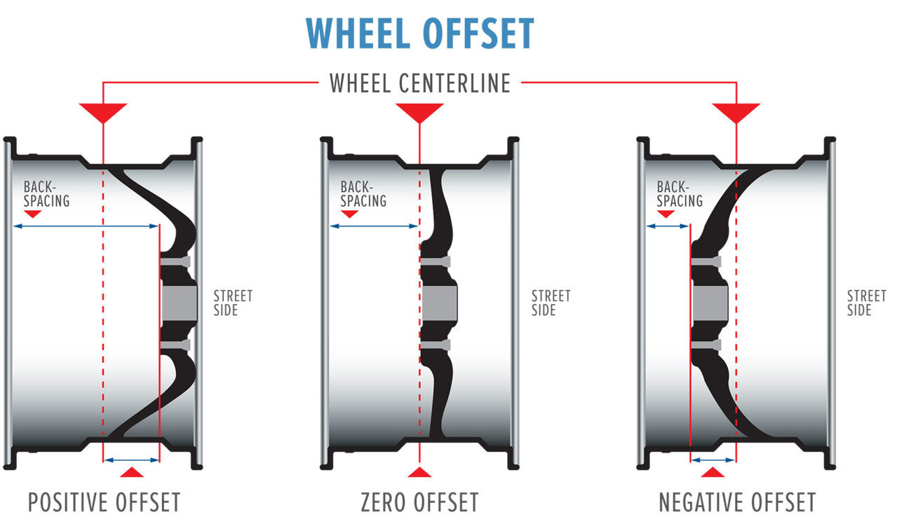

    You’ll find a lot of times while on the subject of wheels that offset is always tossed around and you’re less likely to hear what the width of the wheel is. I’m by no means an expert on this subject but these two details, width and offset go hand in hand, and that determines the backspacing. Here are some wheel specs I found when I was in the market.
    TRD OR 16x7 +25 5”BS
    TRD Sport 17x7.5 +30 5.5”BS
    Sema 4Runner 17x7 +4 4.25”BS
    Fuel Vector 17x8.5 +7 5”BS

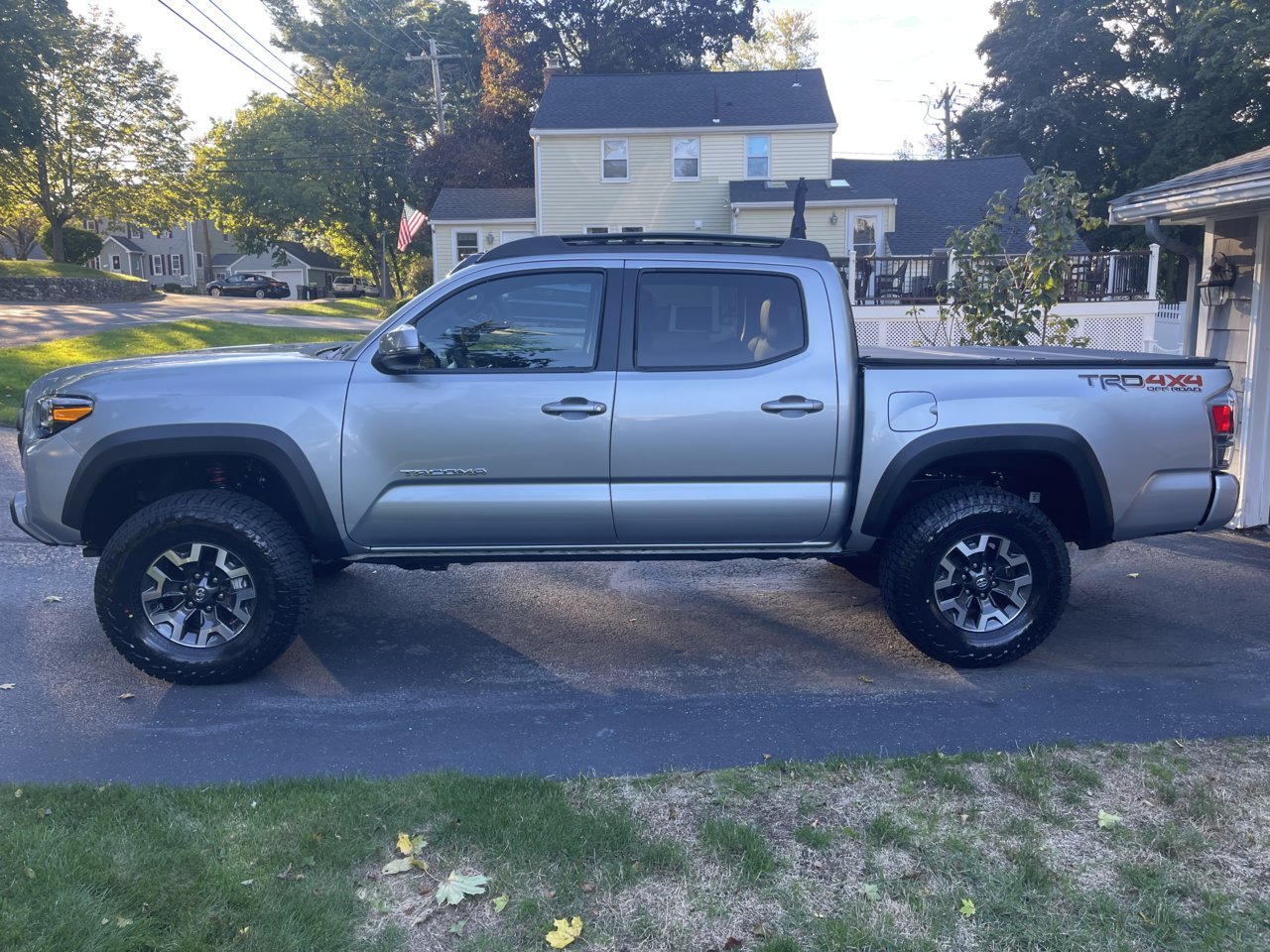

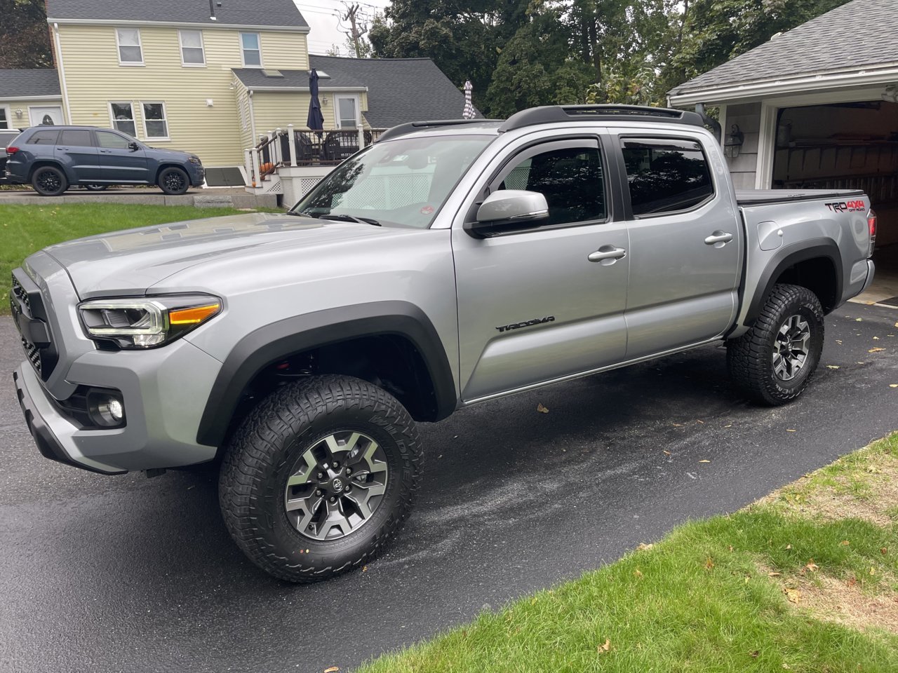

    TRD Lift Wildpeaks 265/75/16
    TRD Lift with 265/75/16 Falken Wildpeaks
    RCrumb, grogie and 69 Jim like this.

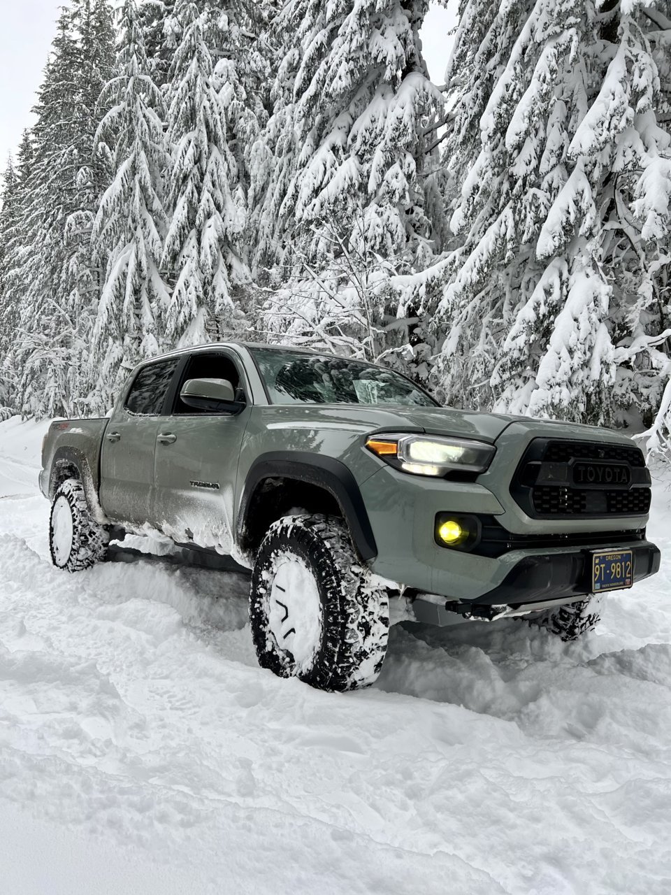

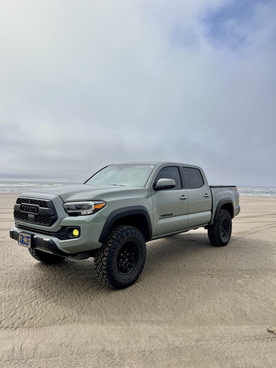

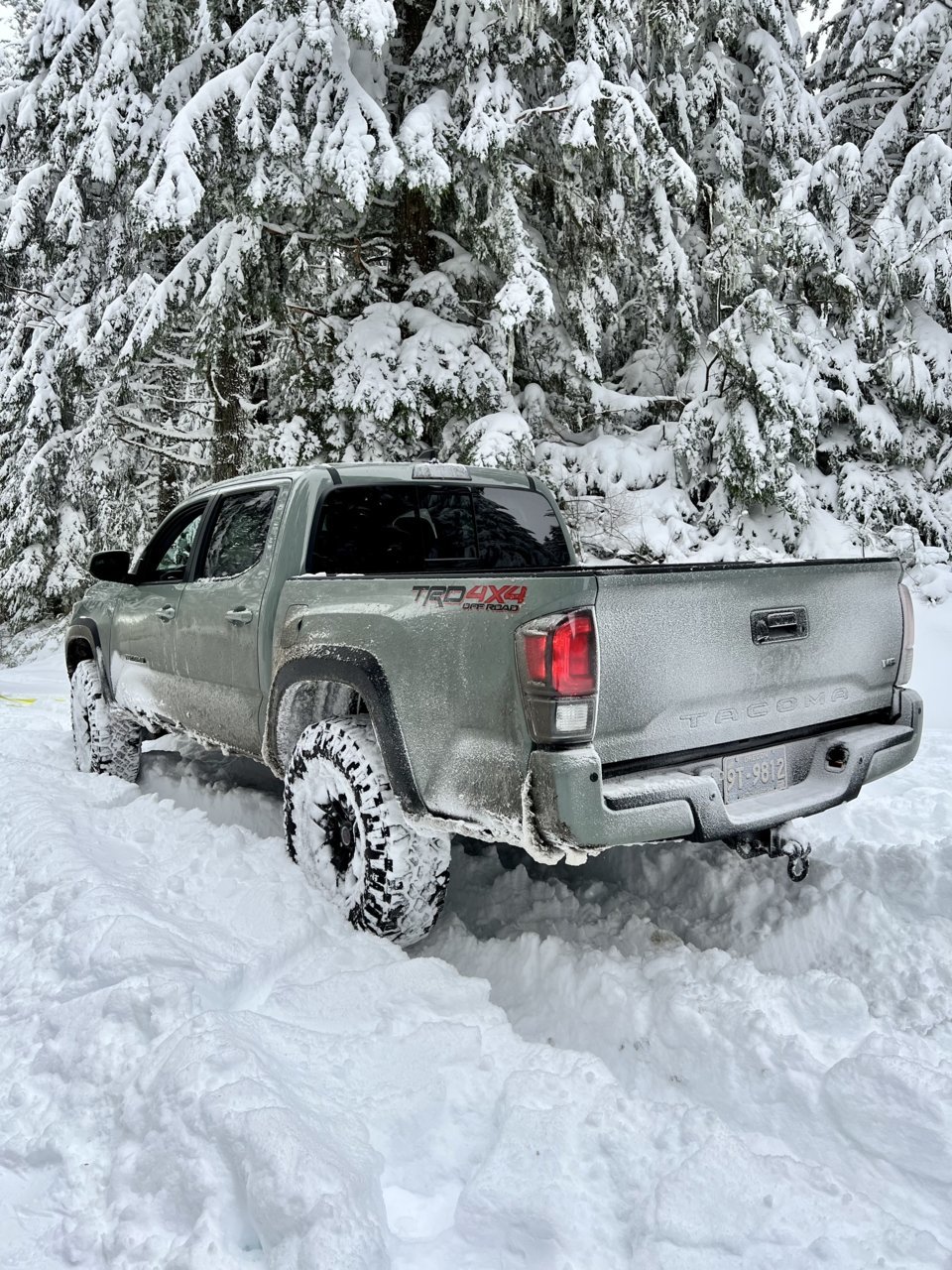

    I’ve never had an issue with rubbing on my trd lift with 285s/75/16 duratracs and the pro wheels. Got the lift installed December 2021, not a single complaint so far.

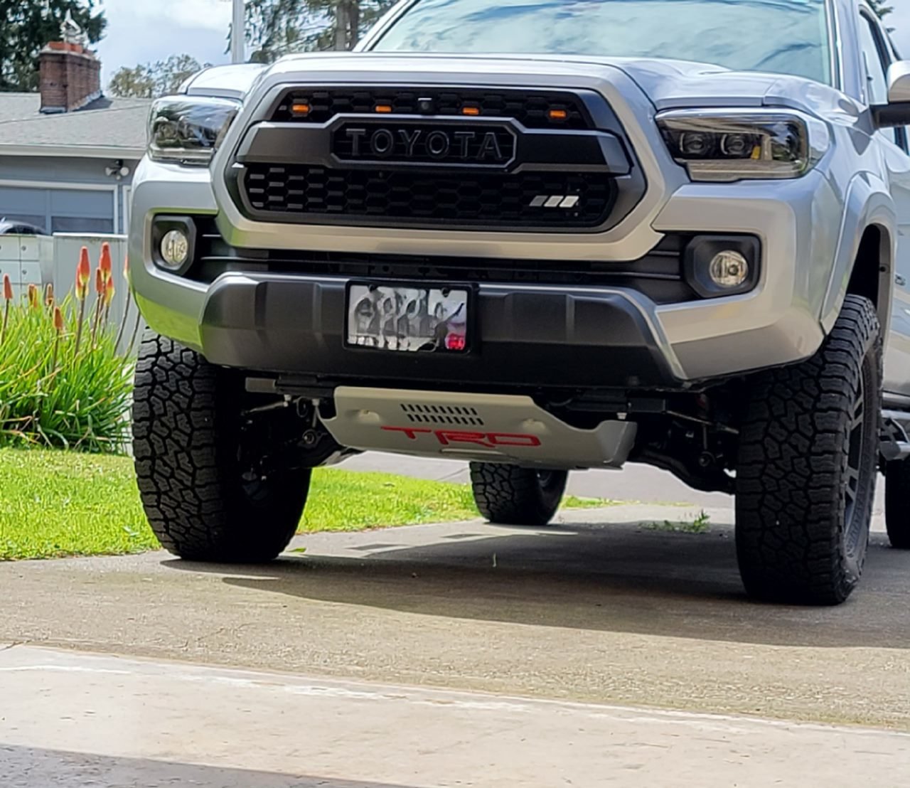

    Curious what it looks like from the side… Could you send a pic that’s the exact set up I want to do to my truck but I’m debating between 265s and 275s

    Can you post a side pic on a level surface? Just got my shocks trying to decide if I want to add a 1inch block or leave the rear stock and set the front at 1inch
