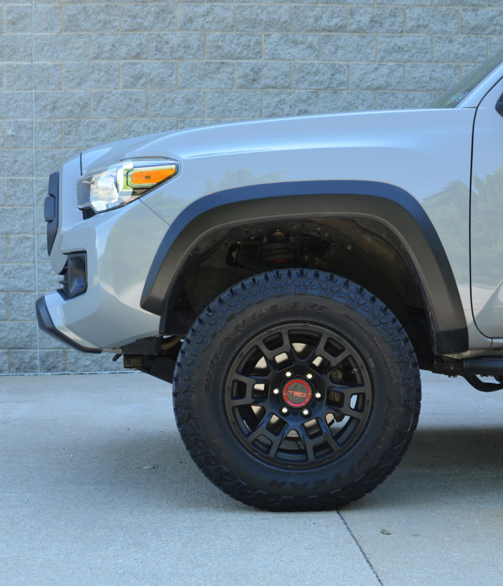

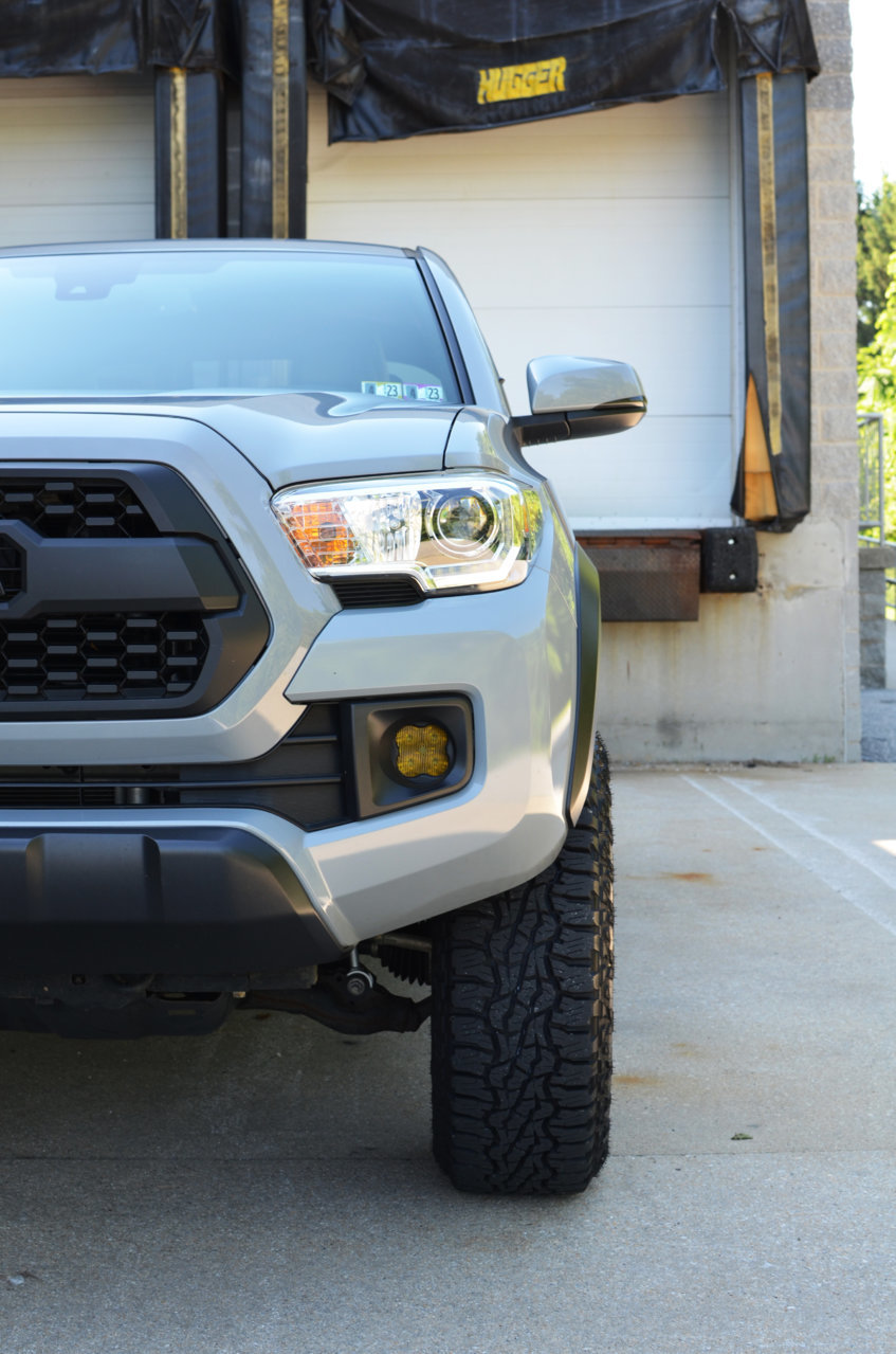

    683
    York, PA
    2019 Cement Tacoma TRD OR
    My truck sees its fair share of trails during hunting season, but that's mostly it. Really just comes down to your personal preference on the 16" vs. 17". Want a little bit more sidewall? Go with the 16's. If you're staying w/ a 265 tire there's a lot of options available for both 16" and 17" wheel sizes. If you're bumping up to a 285, maybe consider the 17's. I wanted the new T4R style wheels, which are only available in 17". Really pleased with them. I also wanted a wider wheel with a more aggressive offset that sat more flush with the fender flare. 265/70/17 Ultraterrains on FSW 17x8.5 +0:
