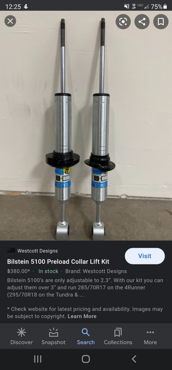

    Perfect! I like the kits Headstrong have. I've used All-Pro Offroad for a SAS for an old 87 Toyota Pickup, and feel I will get the same good quality from Headstrong.
    One thing I want to ask, I am not sure what you mean by "preloaded shocks". When I ask dealership that, what am I looking for exactly when they answer?
    Last question here, recommend 885 or 887 coils?

    I'm not sure exactly how you should word it but here's what I mean by pre loading the shocks.
    If you look at this picture of bilstein 5100s (from google) you see that there are multiple notches to put the lower spring perch on. Which one you use determines how much lift you get. The reason for these notches is so you can use stock length coils to lift the vehicle, otherwise you would change the shock and your truck would be the same height, because the coils support the truck and determine the height, not the shocks. By raising the spring perch on the shock, you can raise the whole position of the coil which in turn lifts your truck. The sacrifice there, is that your shock shaft will be extended more in a resting state than it would be if you left it stock or used longer coils. The longer coils make it so you can get lift without reducing the travel range of the shock shaft.
    So that's what I mean by pre loaded. Sorry if I've been redundant or obvious with that explanation. Again I don't know exactly how to word it, but you're trying to find out where the additional height that the lift gives you is coming from. If it's coming from putting your stock coils on a spring perch that extends the shock shaft, then that's the same scenario as with 5100s and stock coils and would have all the risks we've been talking about already. If the way it lifts the truck is because the shock body is longer then that's a different story because then you'd retain the full range of travel on the shock shaft. I hope this helps.

    Man, that was perfect. I understand the 'why' now. I was thinking the shock was going to come preloaded with something. I'm on board now. I wonder if they have that info? When I called the dealership, they didn't know the kit existed. So they may not have that detailed info? I will give them a call once more to check that out.

    I talked to the foreman of the shop, and he said they do come with multiple notches. So, like we have been talking about, the shock is extended further and reducing travel range. I'm a sucker, or an idiot, either way, I do like this lift. Unless someone can think of an absolute reason to not go that route, I think I am going to go with this kit, then snag the longer coils and AAL from Headstrong. With adding a leaf, I shouldn't need more than the one leaf if wanting to keep the truck level, right?
