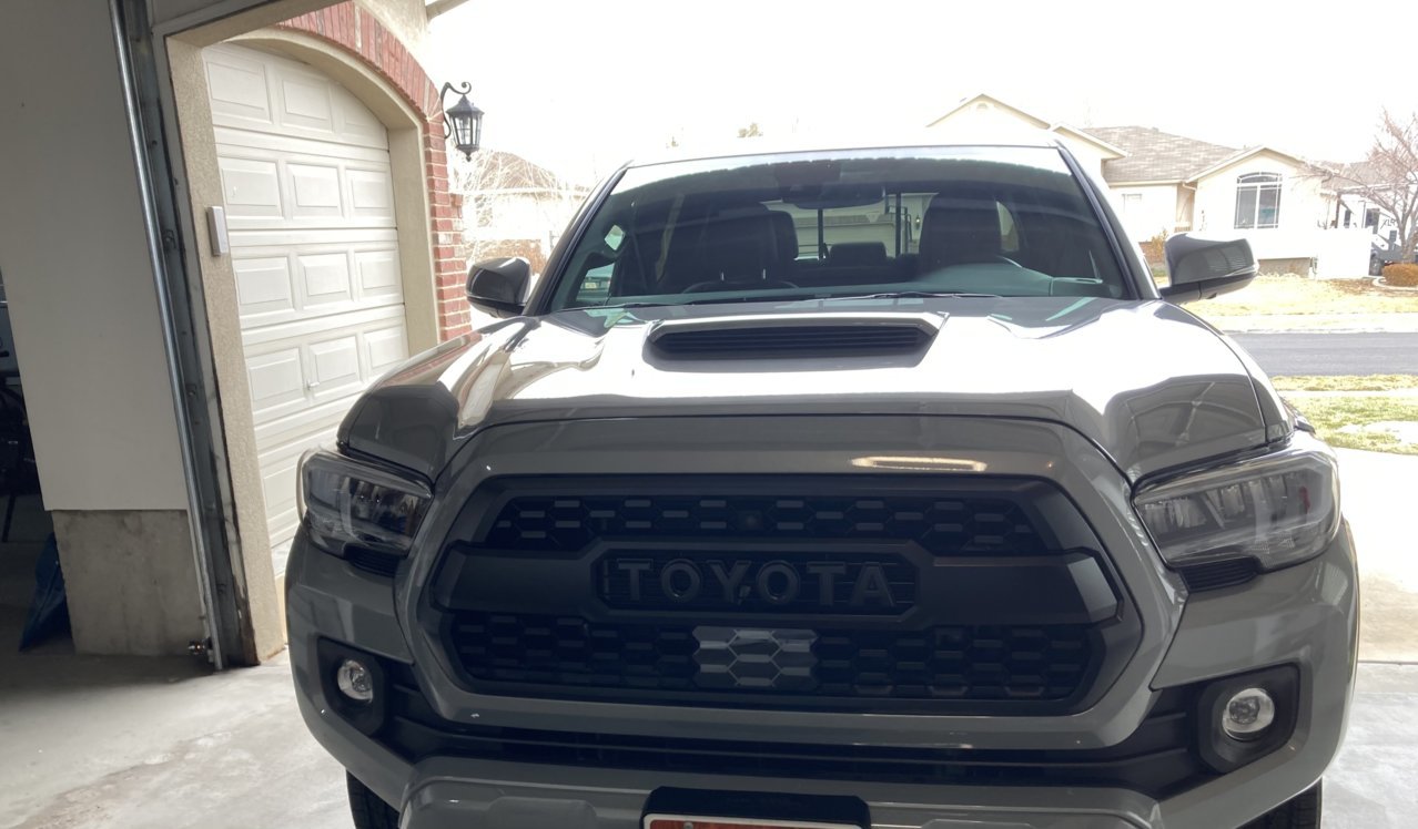

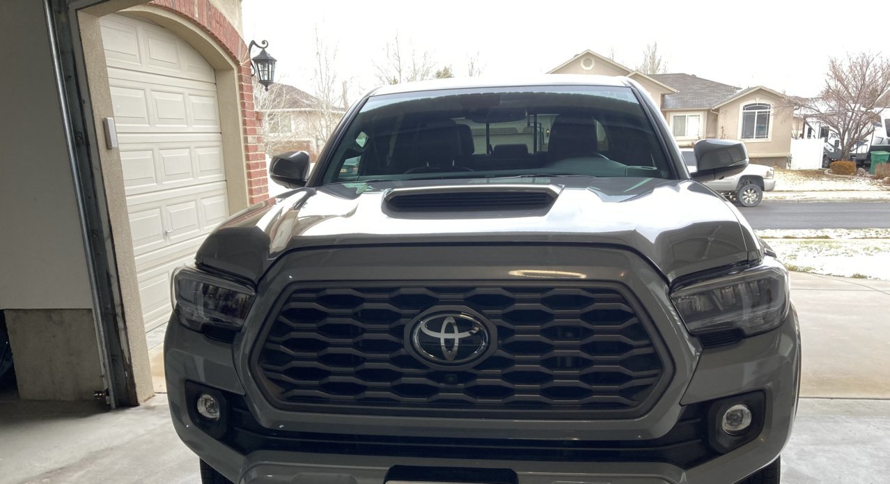

    Huge thanks to this community. Nearly all of my info was listed here on different threads, great info which helped me get all parts and be fully prepared. First time Taco owner, second mod. (First was bigger cup holders). :) Just swapped my grill out this morning.
    Up next, rims/tires/leveling kit, to complete the TRD Lift kit without the $3200 cost.

    What do you mean, specifically, by "leveling kit" in this context? I'm taking notes because I'm going to want a lift on my TRD Sport.

    Sorry. I did use different wording. what I was referring to was the 2” front 1” rear that is done with the TRD Lift kit.
    I’ll be doing Bilstien 5100 all the way around with either a 1” block in the rear or 1.5 inch AAL (haven’t quite decided).
    It’s basically the same thing that comes with the TRD lift.
    From my research, I’ll be able to fit 275/70/17 tires with 0 offset rims, which shouldn’t have any sort of rubbing or trimming needed.
