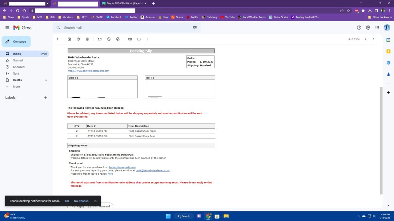

    I just ordered some from BAM and got ship confirmation today! lol

    The date on that says it's placed 1/10/23. I'm glad you got them. You must have ran them out. :)

    Initially they said could take 3-5 days and asked if I wanted to cancel.
