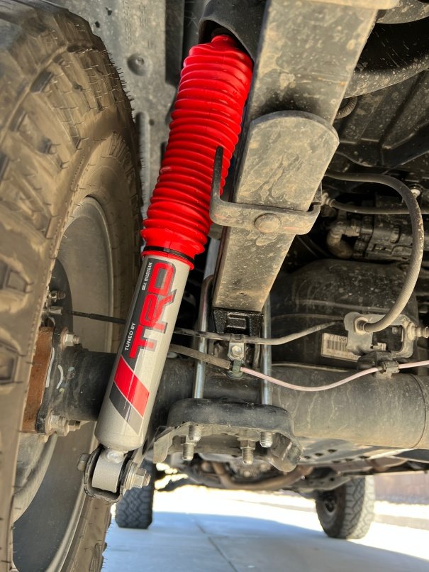

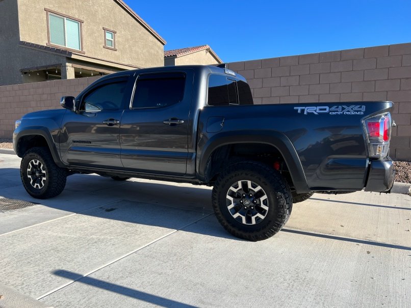

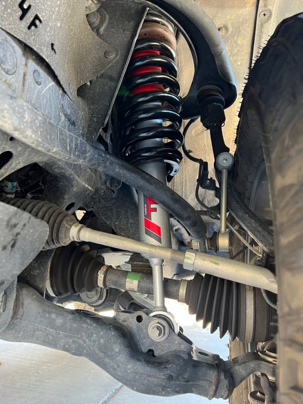

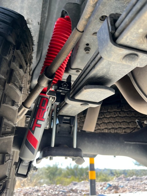

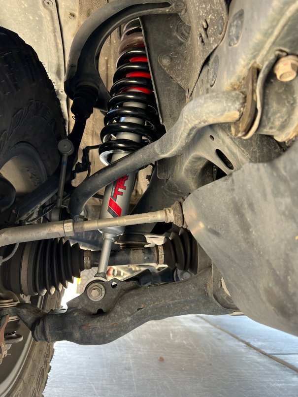

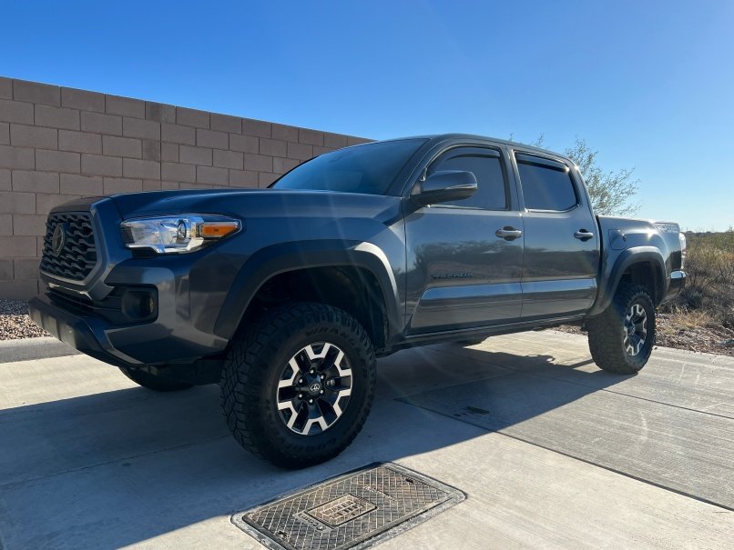

    Just got my factory-ish lift finished up. Shocks and struts from the factory kit, then the Headstrong 3-leaf AAL in the back instead of the factory block. A buddy and I installed it all in an afternoon in his driveway, it was super easy and saved me a bunch of money. I'll get some better pics when the weather clears up.
    Specs:
    • Factory TRD lift (just the shocks and struts)
    • Headstrong 3-leaf AAL with their .5" block added as well
    • AGP Pro wheels (17x8 et+5)
    • Nokian Outpost A/T 275/70r17
    Cheers!
