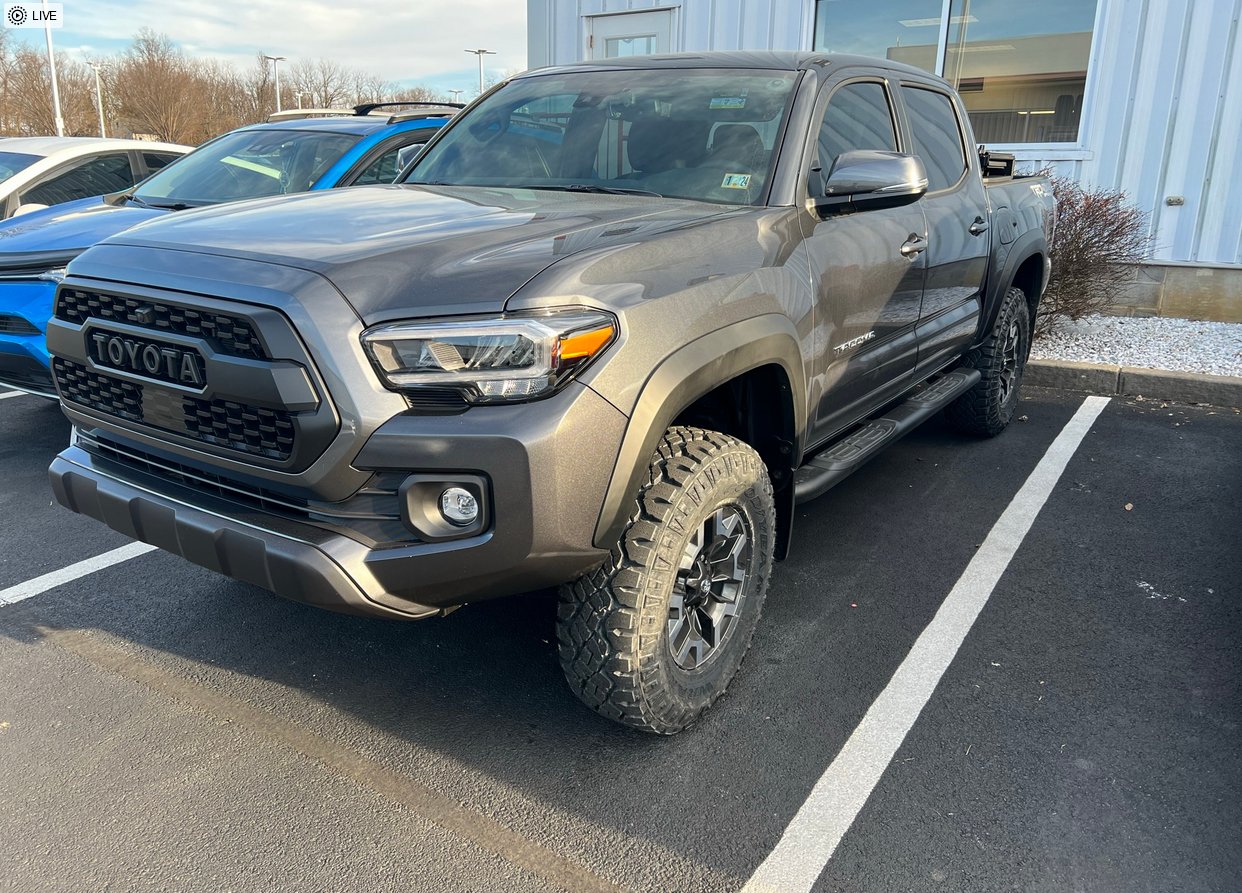

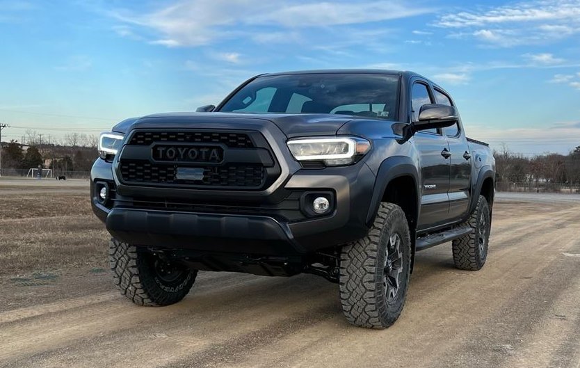

    Got mine done yesterday along with 265/75/16 Goodyear Wrangler Duratrac tires.
    At the dealer when it was done...
    And at my favorite local quick picture spot...

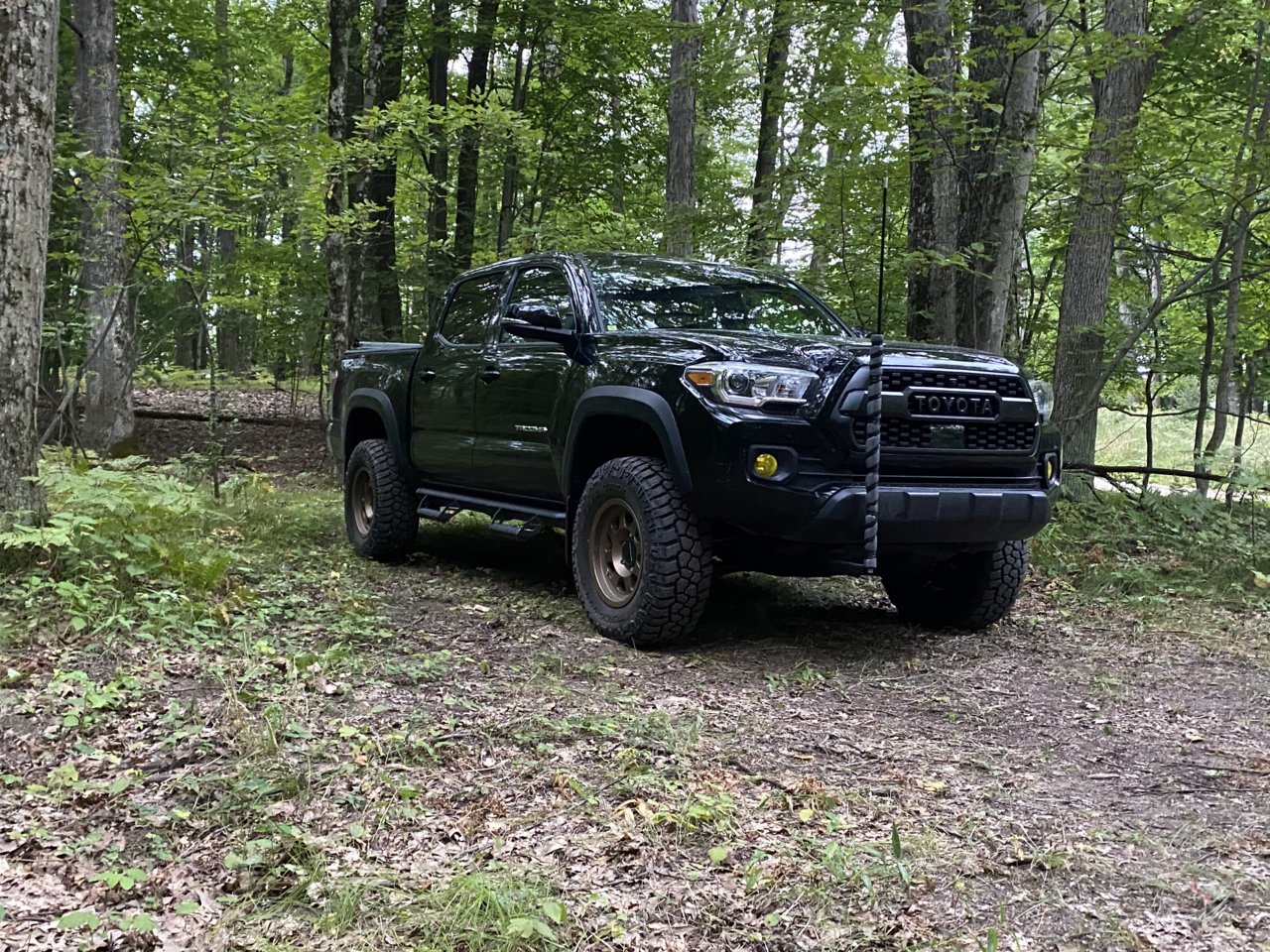

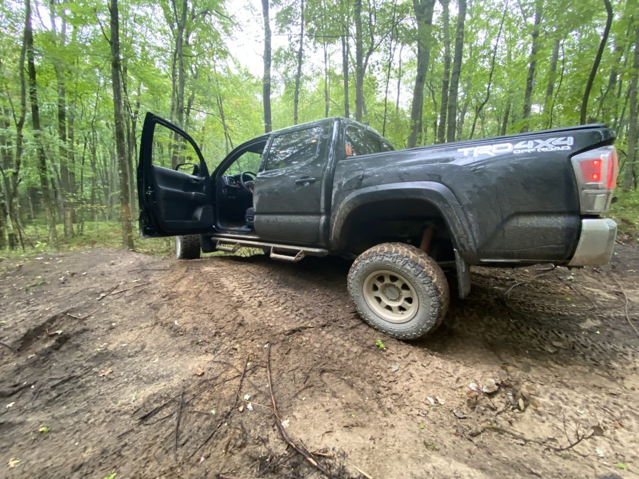

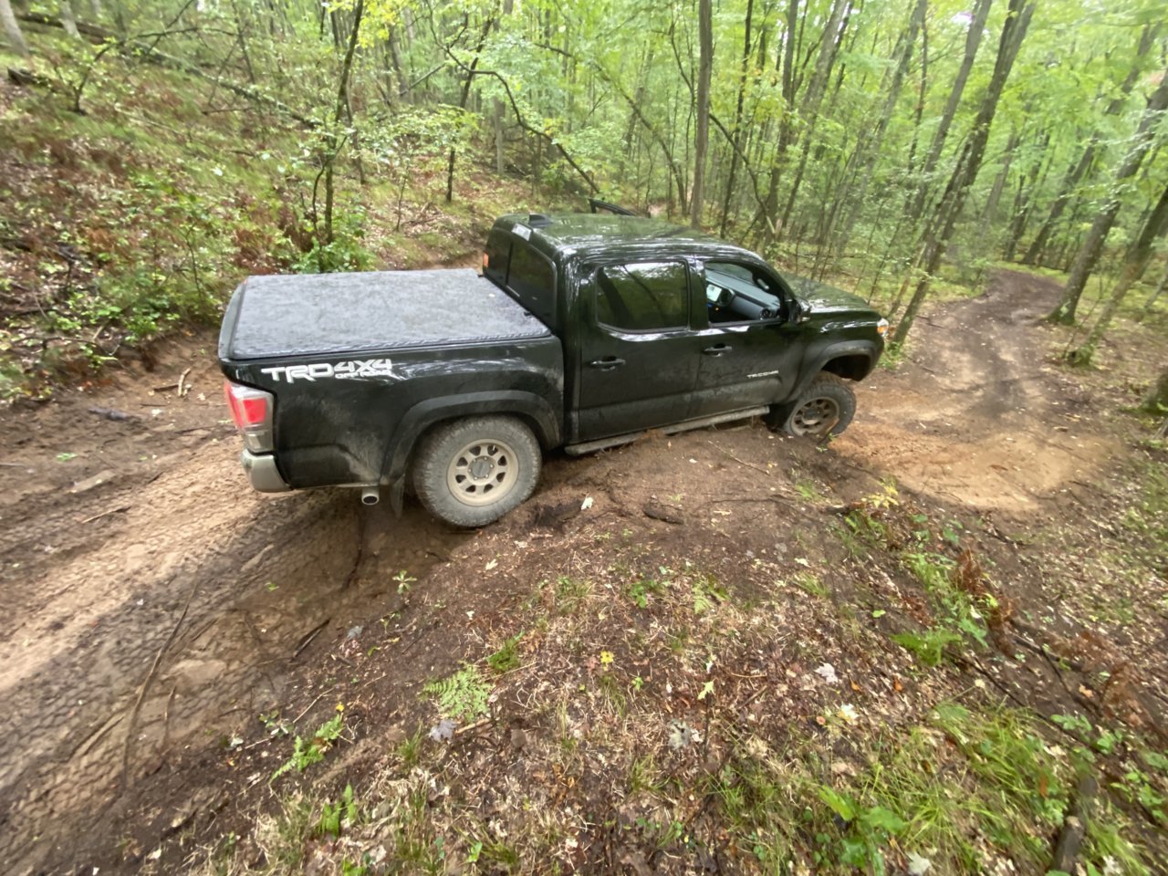

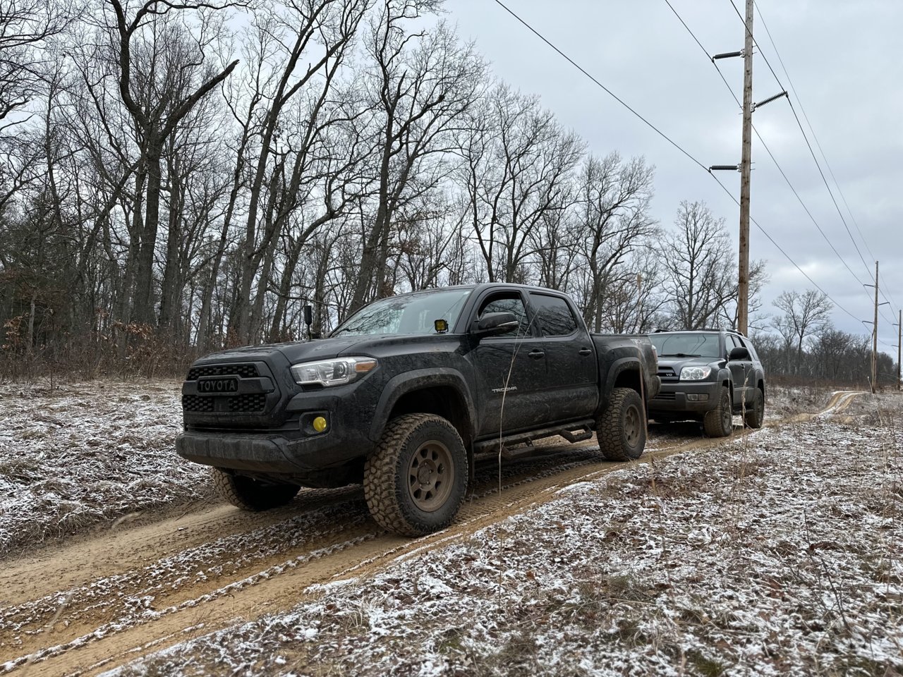

    I ordered the lift from a Toyota dealership on eBay back in June 2022. Me and a friend of mine where able to install it on a Friday night after work. One thing to also note. The TSS sensor that comes with it when I plugged it in was saying that it needed to be calibrated. I plugged the one that came on the truck back in and have had absolutely no issues since the install. Multiple off-roading trips and camping trips I can't complain and am happy with the lift. I could feel a difference over the original Trd off-road shocks. I could see potential doing an add leaf in the future. To my understanding if you have the correct add a leaf you will be able to remove the rear blocks but I may be wrong. I have included a few photos of the current set-up. In the photos I am loaded down with all my camping gear and extra firewood.
    BTW.... The rear locker was a life saver in the last two photos!
