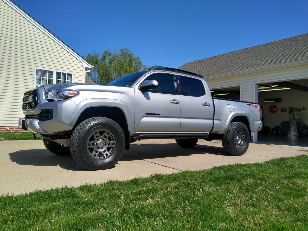

    TRD lift, TRD SEMA wheels, TRD skid plate, TRD Pro fog lights, TRD Heritage Grill, OEM bed cover, LT275/70/17 Falken Wildpeak AT3Ws, OEM bed lights, OEM all weather floor mats, OEM door skid plates, OEM mud guards, OEM bed mat, Black lug nuts
    Same here. Fortunately my 275's don't come close to rubbing, plenty of room but still nervous about 285's. I know a lot of people are running them with no issues, but that's not my luck ... lol.

    Honestly, those 275/70r17's look amazing and a great compromise between 265 and 285. Are those WildPeak SL?
    Thanks, I thought so too. Those are Wildpeak AT3Ws. I ran BFG KO2s for years but changed things up this time and went with the Falkens. I like them a lot so far.
