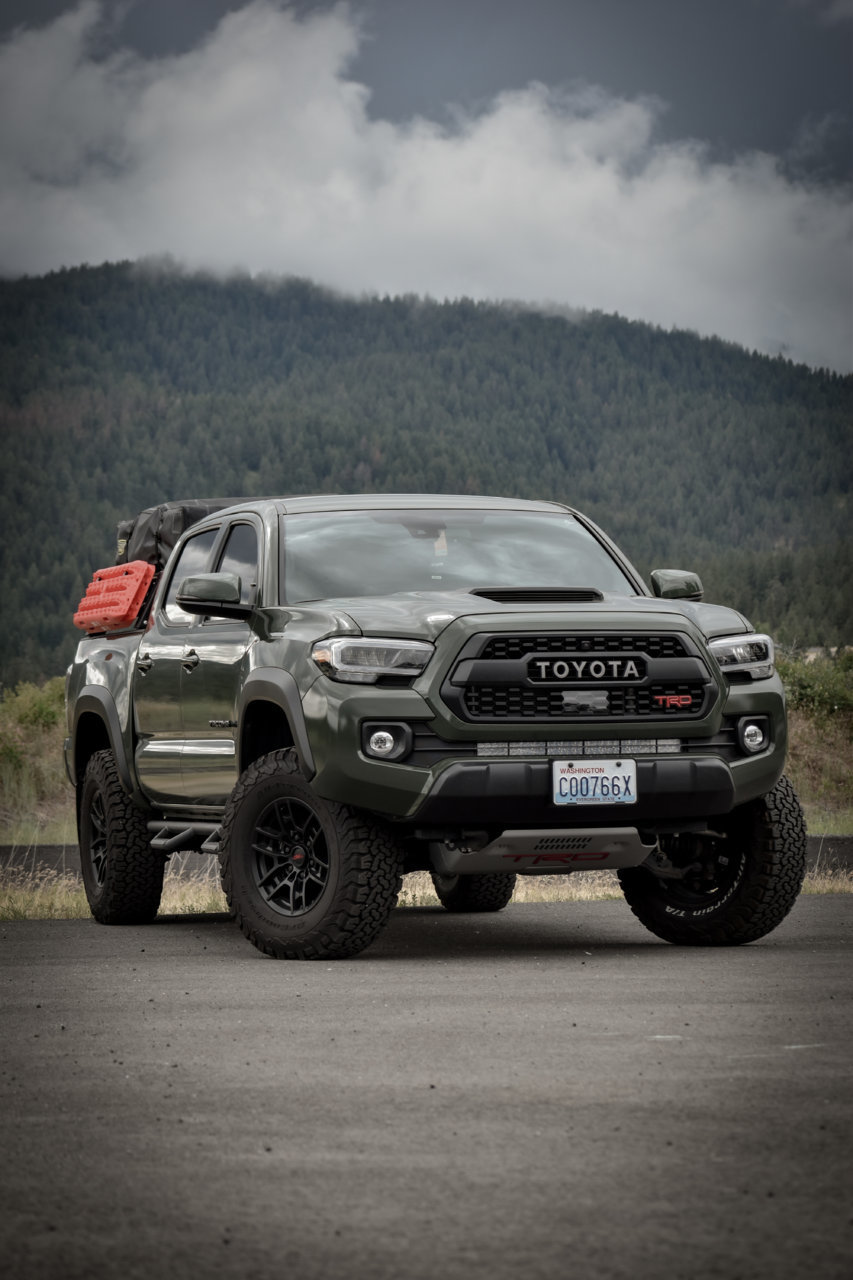

    Just did the lift on Thursday/Friday. Only did the shocks/struts and hardware… Already had a pro grille on it. Pretty straightforward, front was honestly easier than the rear using the method mentioned here without a spring compressor. Got an alignment afterwards and trucks looks great with the 2/1” lift. 22 AC OR so did the second circlip groove as mentioned in the instructions. Post a pic up soon, wheels next…

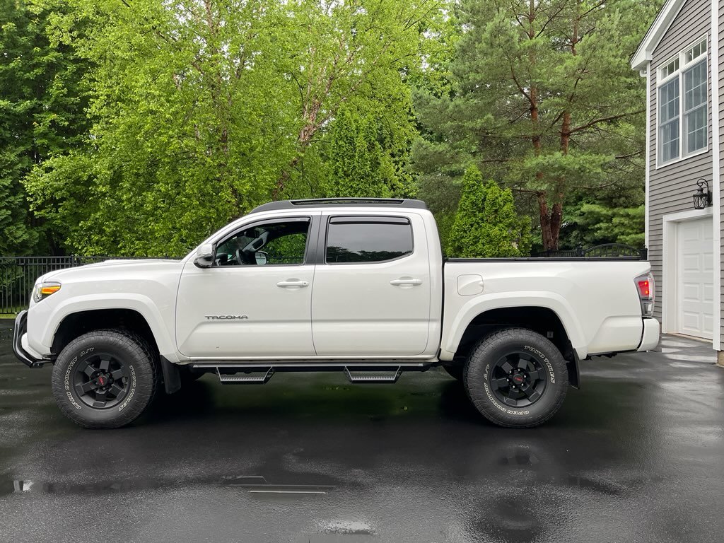

    I have this lift installed in my 21 Sport. It settled quite a bit after a year, and honestly it doesn't even look like my truck is lifted. :\

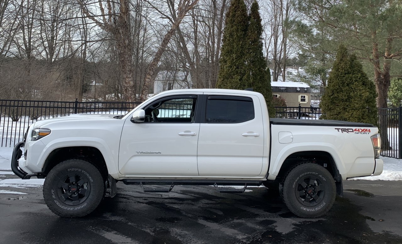

    Can you measure to the top of one of your fenders, when you have a chance? This is my truck the day I got it done about a year ago. I feel as though it's settled a fair bit since then.
    Tires are 265/75/16 Open Countries.

    Hm, maybe I'm senile, lol. Pic from today. I don't feel like this looks like a lifted truck at all...
    Just shy of 37" at the middle of the front fender, about 37.5 at the back.

    Definitely looks lifted compared to my stock truck.

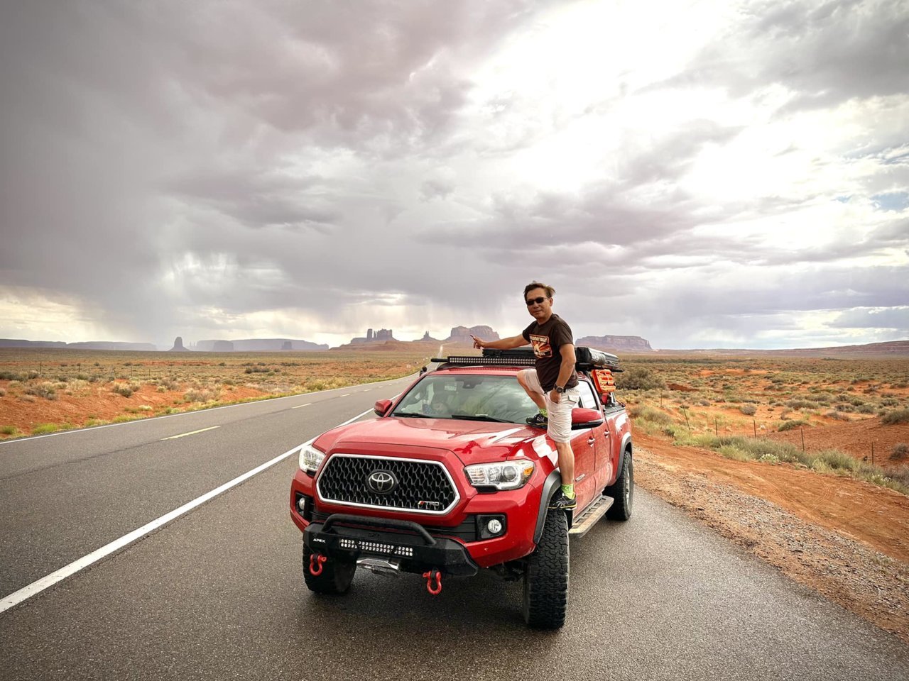

    One more pix when the truck is loaded with camping stuffs, I have AAL on the back springs with no spring spacers with 285 tires:

    I don't see why it wouldnt work, you would revert the clip back to the lowest setting and put the spring on.
    That said I'd probably leave it intact and put the 886 on a fresh 5100 and sell the TRD on its own. You're going to be removing the rear leaf spacer as well.
    And at that point and given your load out, I'd go bigger than 5100's.
    Something like this.
    https://www.headstrongoffroad.com/s..._Kit_with_OME_Dakar_Leaf_Pack_-_HS16BK-3.html
    Just an idea, rather than making a lateral move, do an upgrade.
