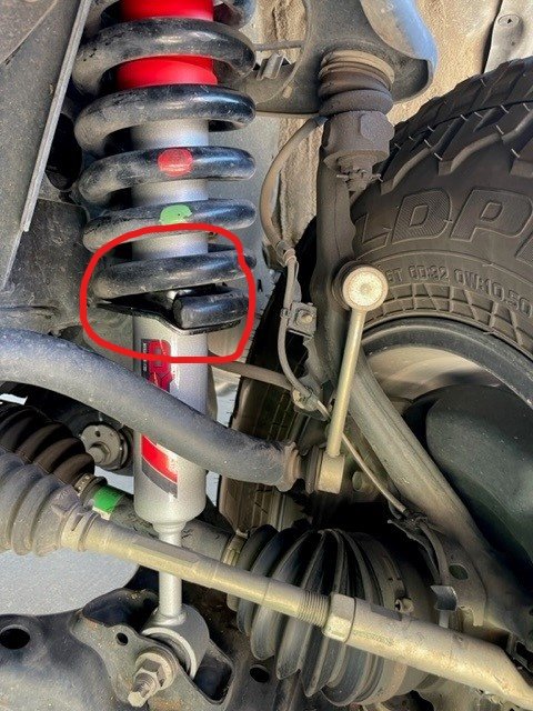

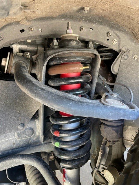

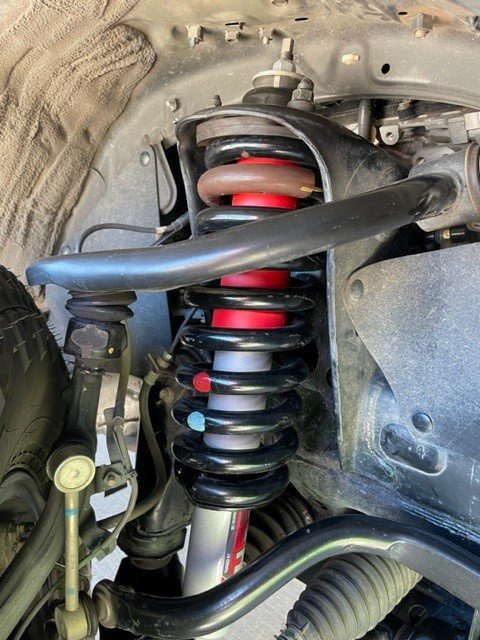

    Hey all, long time reader of this thread. I finally pulled the trigger and got the TRD Lift kit installed by one of my local Toyota dealers. I love the look and ride of the truck a lot. However, I noticed just the other day that the coil springs/coil seats are installed in the wrong orientation. The left/drivers side is completely 180 degrees of where the base of the spring and spring seat should be according the installation instructions of the TRD lift kit (should be facing the rear), and the passenger side is about 90 degrees off. My question is if this is cause for concern or nothing to worry about? Is it even worth my time to go back to the dealership and have them turn the coil springs to the correct orientation? I was told multiple times that the shop foreman installs these kits all the time.

    Welcome and congratulations! Not sure that there would be any long-term issues, but if you're like me, it's always going to be in the back of your mind. I would absolutely take it back to the dealer and have them make it right. Just because they install them "all of the time" doesn't mean the tech that did it ever did it before. It's not a big job so it shouldn't take very long. Just show the service manager your photos.
    Let us know how it goes and post some pics of your rig when you have time! ;)

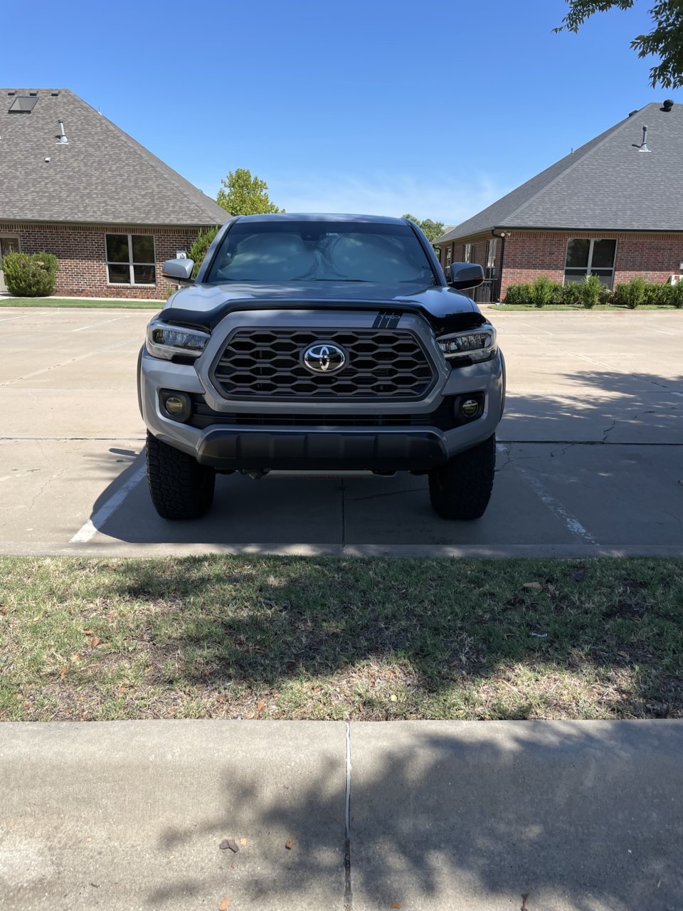

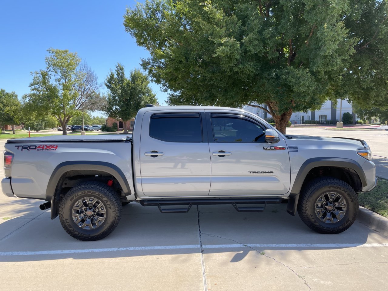

    Thank you @TRDRed! Indeed, it will be on the back of my mind for sure knowing it's not correct, so I will be contacting them soon to hopefully get it remedied. Here's a couple pics of the Taco with the TRD lift kit installed!Tacoma Side Pic.jpg Tacoma Front Pic.jpg

    I personally would get it corrected ASAP before it starts making the popping noise. So yes get it fixed and don't wait.

    I went out to double check I did mine correctly... Phew!
    I don't recall reading anything about that rearward facing requirement, I just made sure the springs lined up with indentation they had left in those top hat buffer thingies (anyone got any of them technical terms?).
    Is there a particular reason they need to be oriented that way? First though is that forward facing gap looks like an ideal place for some gravel or debris to fly into and get all crunchy.

    Thank you both for the recommendation to get this fixed. I just had the dealership remedy the incorrect spring/seat orientation this morning and they had it completed within a couple hours. No charge, as it should be since it was on them. I also provided the kit installation instructions specifically pointing out the correct way ( page 7). Definitely will have the peace of mind knowing its done correctly this time.
