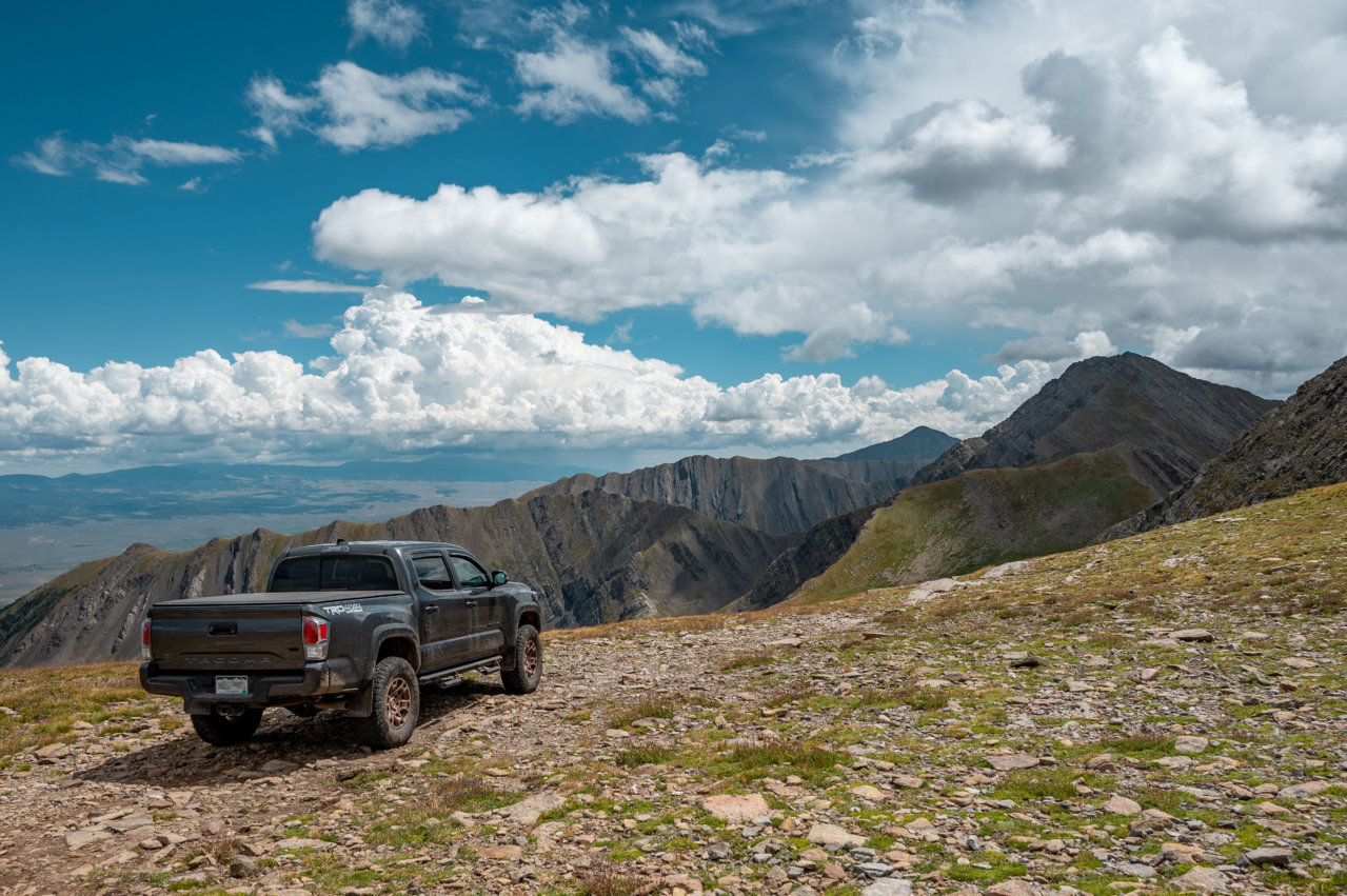

    My OEM lift (+Headstrong 3LAAL) has fully settled and I'm really loving it with my 285 Maxxis Razr ATs. It got me up Hermit Pass last weekend to 13,000ft no problem! Loving how it handles on and off-road.
    RCrumb, rybern, MTB58 and 2 others like this.
