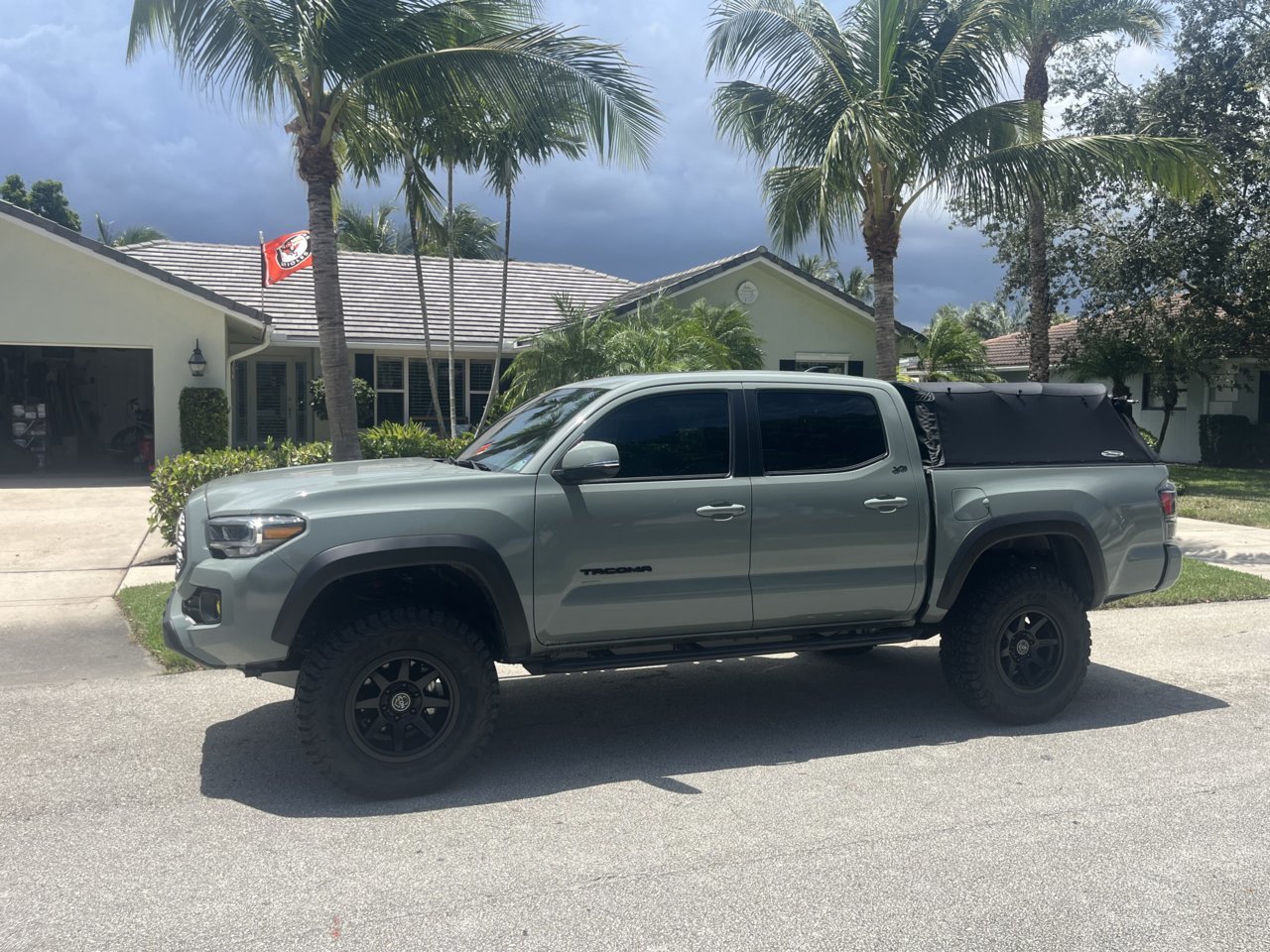

    What rims are those?

    Brilliant - thank you. I am putting a canopy on my new truck and this is the first place I have read that the amount of lift is adjustable. I like the 1" rake the truck is delivered with, so I was concerned that 2" in the front was the only option. Now I understand why the lift kit is advertised as "the package offers up to a 2-inch front and 1-inch rear lift". I thought Toyota was simply covering it's bases in case somebody's came in at say, 1.75", after installation.
    I am new to this forum and it's one of the best I have ever been on. The information is unbelievable and the user interface is well designed.

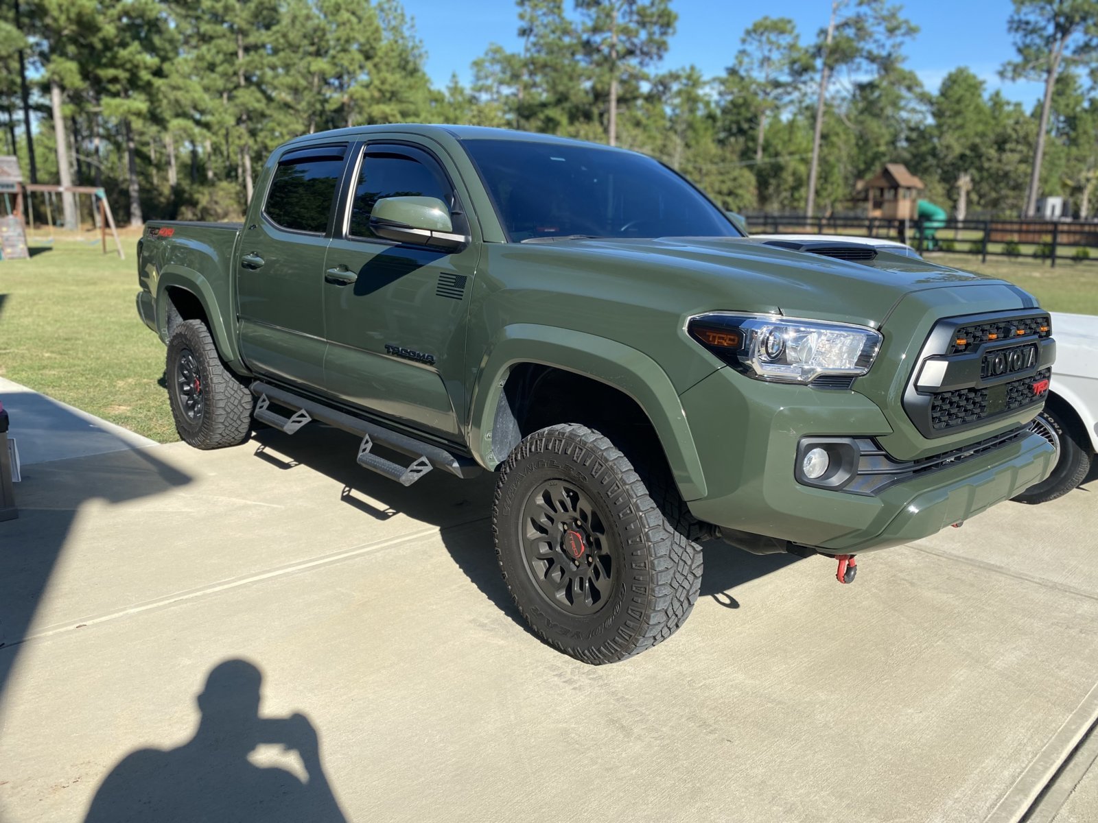

    I have scoured this thread and many others and would like some input for my specific situation rather than assemble bits of ambiguous data from all over TW. I post here bc this thread is focused on the TRD OEM Lift (2/1) that we most likely all have.
    I would like to hear from those with similar or exact same setup (lift/wheel combo).
    Ideal new tire would be Toyo Open Country AT3s. Weight, balancing, tread wear, mileage expectancy, and overall look/performance is why I'm going with these. However, I am open to suggestions.
    BLUF:
    I am debating between 265/75R16 and 285/75R16 strictly for fitment reasons. Not for fuel economy or price considerations.
    Current Setup:
    2022 TRD Sport with TRD OEM Lift (2/1) on TRD Pro 16x7s with +13mm offset, no spacer. No mud flaps.
    Options:
    265/75R16 with a Bora 1 inch hub-centric wheel spacer to achieve desired "poke".
    *or*
    285/75R16 with Bora .75 inch hub-centric wheel spacer to match previously stated "poke" and ensure UCA clearance.
    Questions:
    Will the "285 Option" work, as this is my preferred plan? I am okay with light trimming or heating/bending/relocating inner plastic. CMC is a No-Go.
    Do the back of my TRD Pro 16x7s have relief slots for the exposed studs with use of the .75 inch Bora wheels spacers? Pics?
    Any additional concerns or questions that I've not asked or addressed?
    Thanks,
  19. Jan 9, 2024 at 8:17 AM
    #3099
    pauldotcom
    pauldotcom Well-Known Member
    Jun 6, 2008
    #7148
    544
    Paul
    MA
    2012 Toyota Tacoma 4x4 TRD Sport Quad Cab
    OEM Roof Rack, Bilstein 5100's @ 1.75", Rear 1" block, TRD 17' Wheels
    265/75R16 for me (it's 31.7inch close to 32")
    2" in front TRD shocks; rear 1.5" rear TRD shocks
    285 = those are 10 ply if your OK with that. Also you will need a cab chop for clearance.

    I think 285s will fit without issues. I think adding spacers might require a chop mount but plus 13 you may get away with it. I have the 5100s which is the same as your lift but with more settings. I run 285s on a 2/1 lift on 17 inch wheels with+4 offset, I still have the factory mudguards. I have Toyos AT3, super light, been running them for years on my other vehicles. They are a top rated tire.
