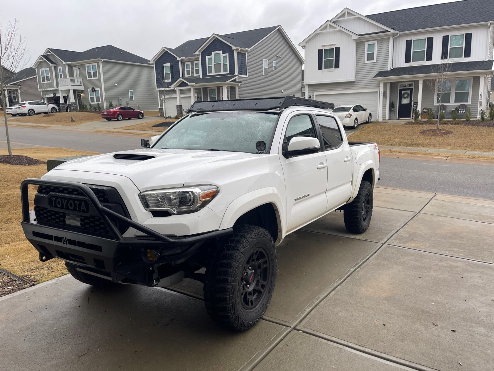

    Because I am lazy and don't feel like reading through 156 pages. Has anyone gone with aftermarket springs in the front? I have added a C4 Hybrid bumper and the front has gotten squishy so before I add a winch I figured I would see what everyone else is running. I am leaning toward OME Heavy springs up front but want to hear from the gallery... PFA

    Lots of folks have swapped springs to compensate for extra weight. Reach out to one of the vendors here on TW to help you figure out what will work best for you.
