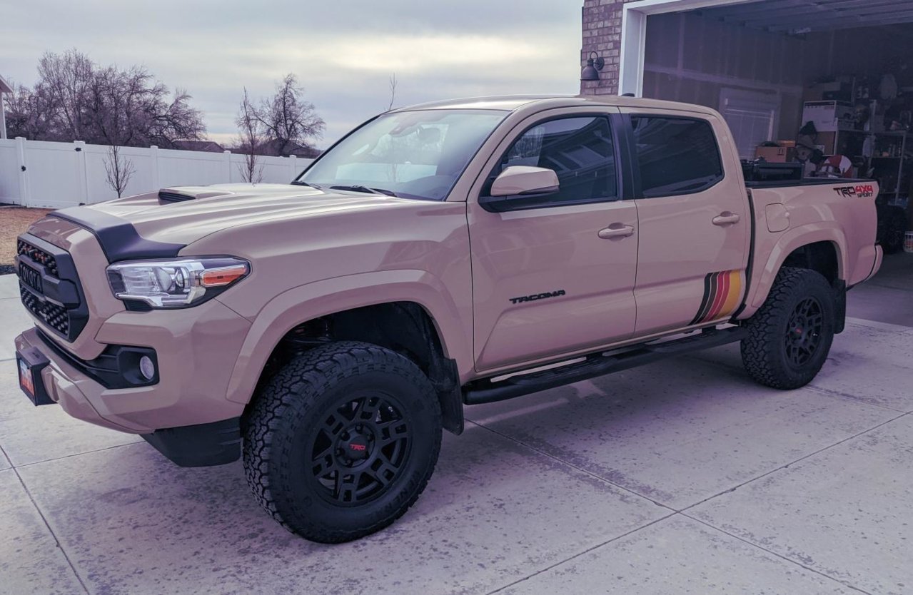

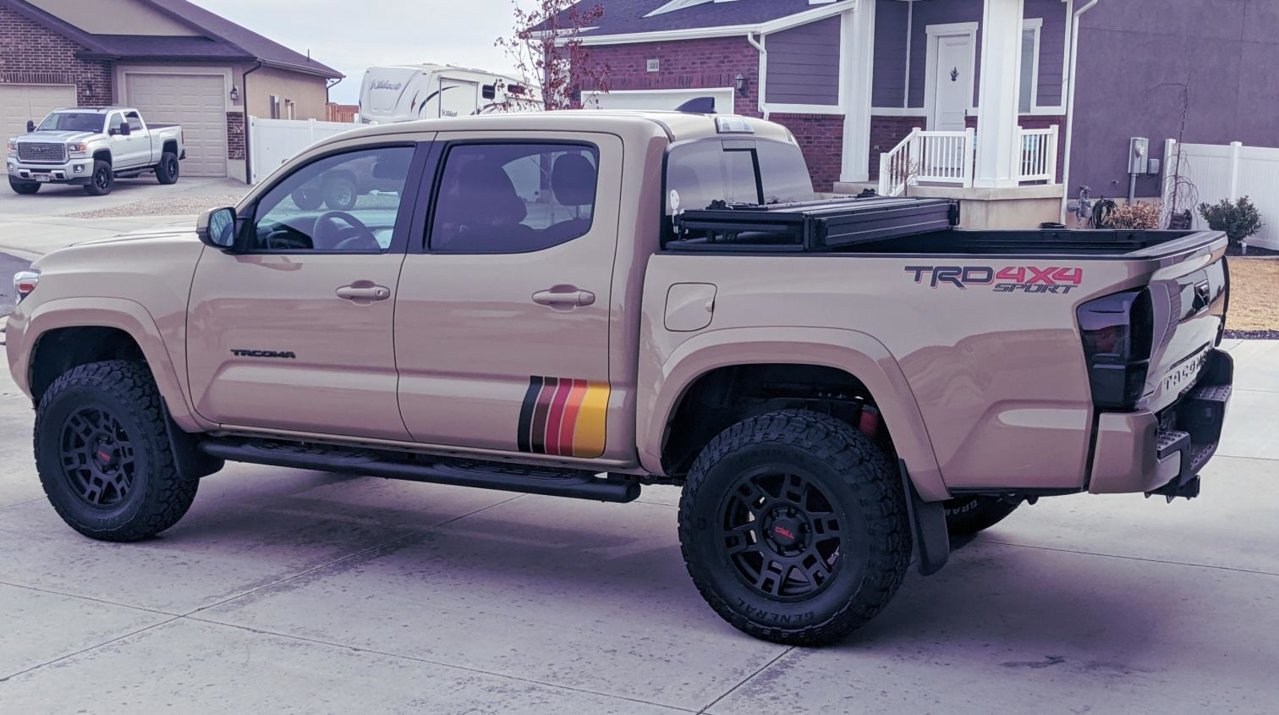

    New wheels and tires (General Grabber ATX 265/70R17) to go with my TRD lift. Nice and modest. Still plenty of power. Rides soft.
    4-BA98982-03-D5-4785-AA05-FE9-DF5-BB456-_1c0ec76b01daa78a35275363340f0984a00fdf87.jpg
    FF3-FCA5-F-F22-D-4-A2-E-B84-B-80547-CAC3_0ea2032abee55f8f6500d6258d27cdaf14cd920a.jpg

    cspcrx
    cspcrx Well-Known Member
    Aug 24, 2009
    #21686
    510
    21 TRD Sport 4x4 Cement
    Like those tires and wheels, fits the stance nicely
    TacoOggie likes this.

    Looks great . Any drive line vibration with lift ?
  17. Mar 25, 2021 at 5:56 AM
    #717
    TacoOggie
    TacoOggie Active Member
    Feb 23, 2021
    #357148
    32
    Og
    2020 QS TRD Sport
    No. Knock on wood. But my dealer added a clamshell bushing (I thin that's what they called it) to the install.
    I took it on an 800 mile roundtrip (freeway, city and off-road) mountainous adventure last weekend and it was silky smooth. Drove as high as 90+MPH on I-15 in Southern Utah where the limit is 80.
