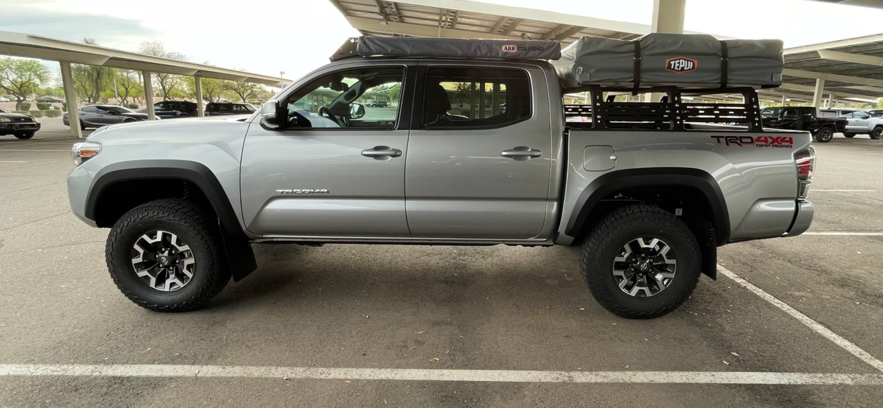

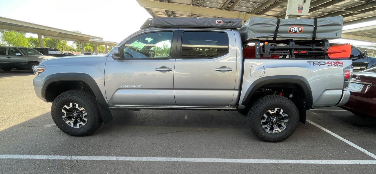

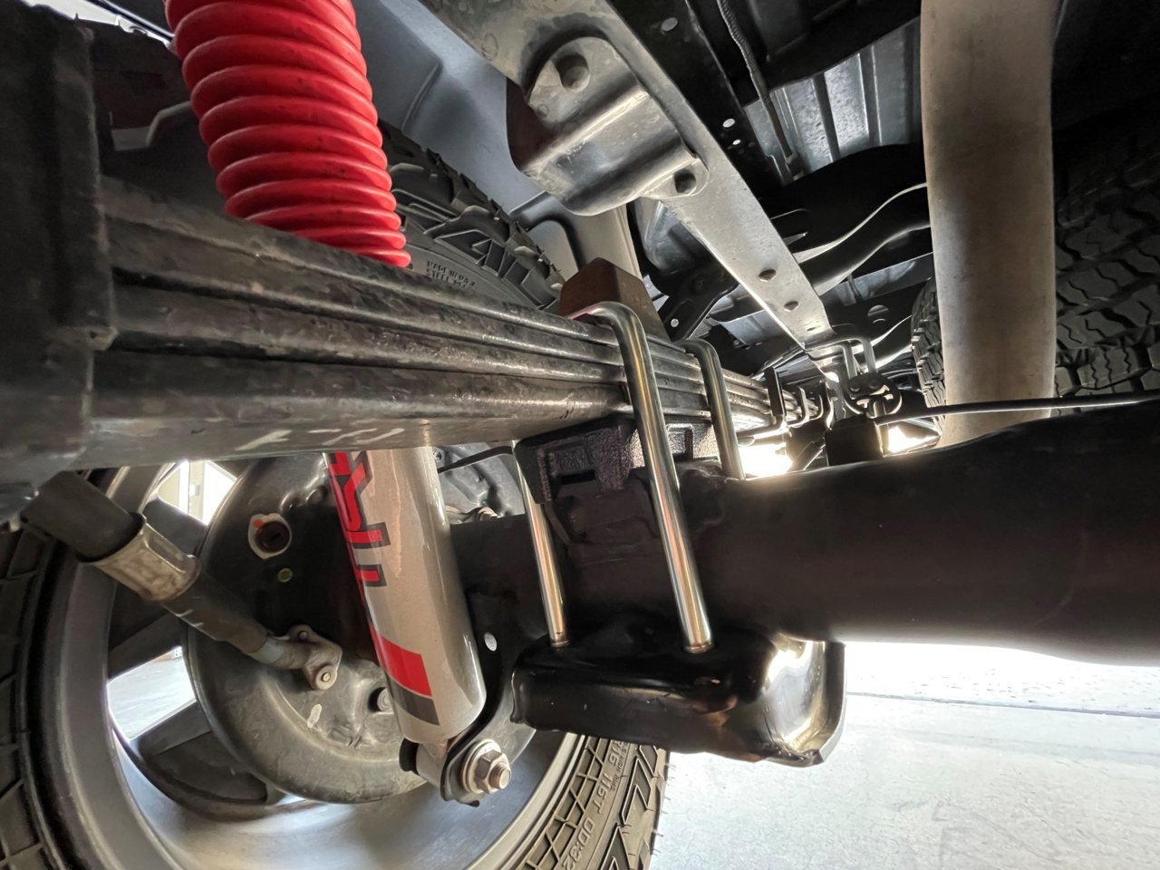

    I ended up getting the TRD factory lift with Pro grille, Pro skid plate, and New Falken Wildpeak tires for 3416.25 out the door..
    I had to add the torch add a leaf kit to support my RTT/ bed rack. My leaf springs were sagging really bad after the added weight. attached some before and after pics.

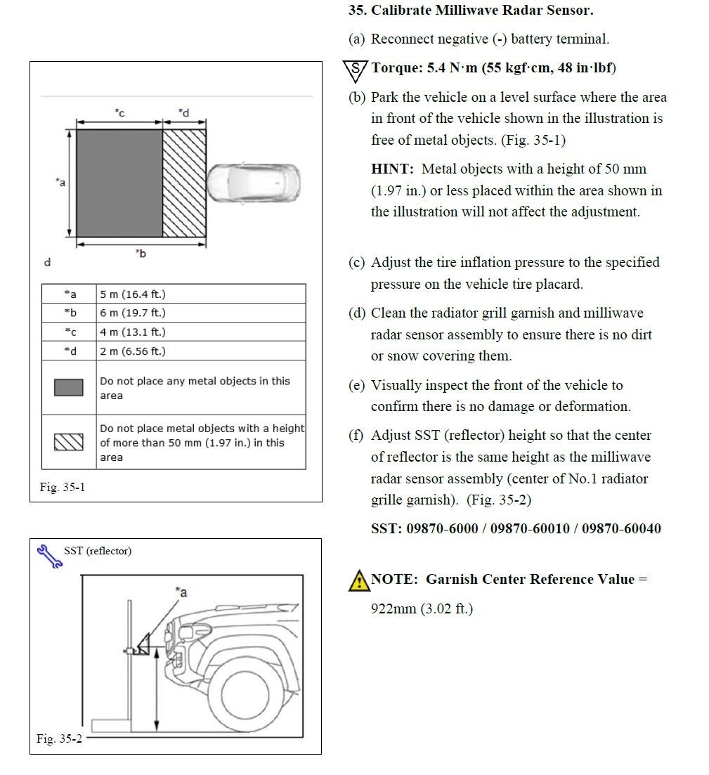

    Yea I dont think they can calibrate it with software its just a physical thing. As you can see here in the directions of calibrating after install. They are just positioning it "adding a washer probably" so it sees objects correctly in the new location and lift

    What in the world, so you put the reflector in front of the sensor.... and then what? Does the tacoma see the reflector (09870-60040) and know to calibrate? Is there more steps?

    they use the techstream to check the settings it gives off

    yea it has been out there when others upgraded from the factory grille to the Pro. when they move the sensor to the location usually a 1mm washer is used on the screw to adjust the angle to the sensor so its reading correctly because of the new location.
    Thats what i did with mine and have no issues.
