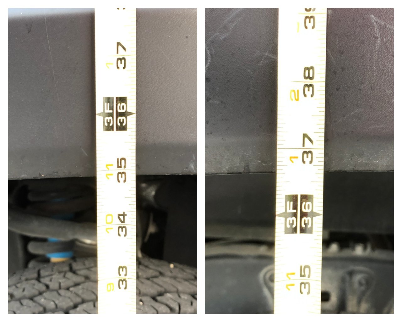

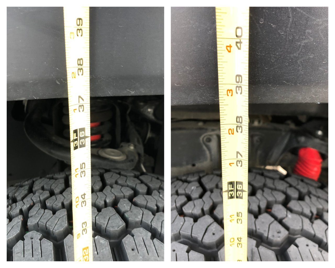

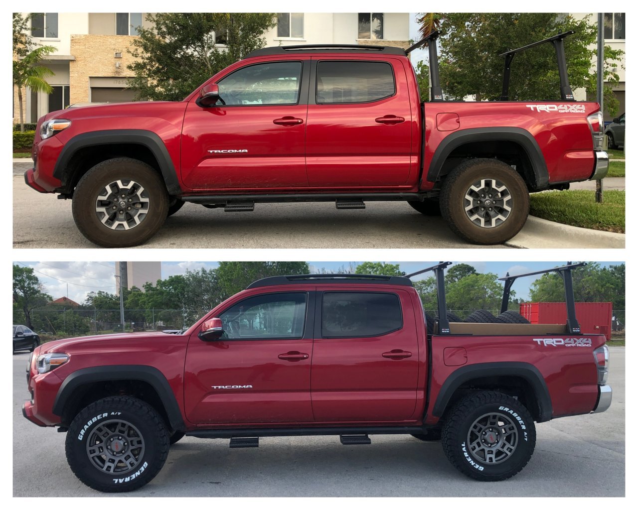

    Just got mine installed yesterday...the ride quality is about the same as stock, with one difference: there's a significant reduction in nose-drop. The truck definitely stays more level at braking. It's also a bit stiffer in the turns, less roll. After some measurements, at the bottom of the fender, along the center of the wheel, I went from (approximately) 34-7/8" Front and 36-5/8" rear to 37-1/4" front and 38-5/8" rear. Very small rake, without measuring, it looks perfectly level. Overall - I like it.
    $1350 for the kit, $1148 for the install (+Uncle Sam's cut) - which included mounting & balancing on new wheels (4Runner TRD Pros). West Kendall Toyota treats their customers well. If you're down here in South Florida - highly recommended. The obligatory before & after with some measurements:

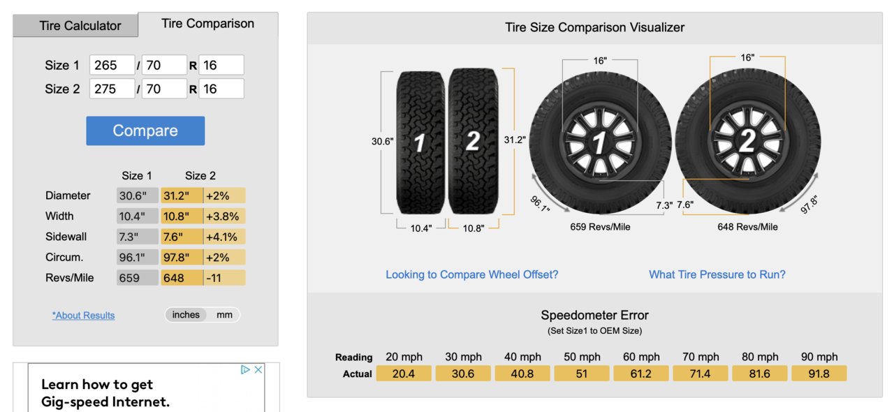

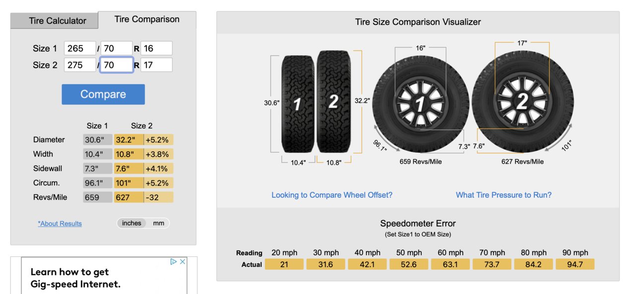

    Closer to 2 sizes bigger. Stocks are 265/70/16 so I think the "next" size would have been 275/70/16. I went with a 17" wheel, so the 275/70/17 are just a little bit taller and wider. Any tire guys out there that know exactly what the increments would be?

    Ya, technically ur right. But that 275/70/16 size isnt very common. A 265/75/16 or 265/70/17 would be the considered the next size up most of the time. Your size is about 1/2" taller and a 1/2" wider than a 265/70/17.
