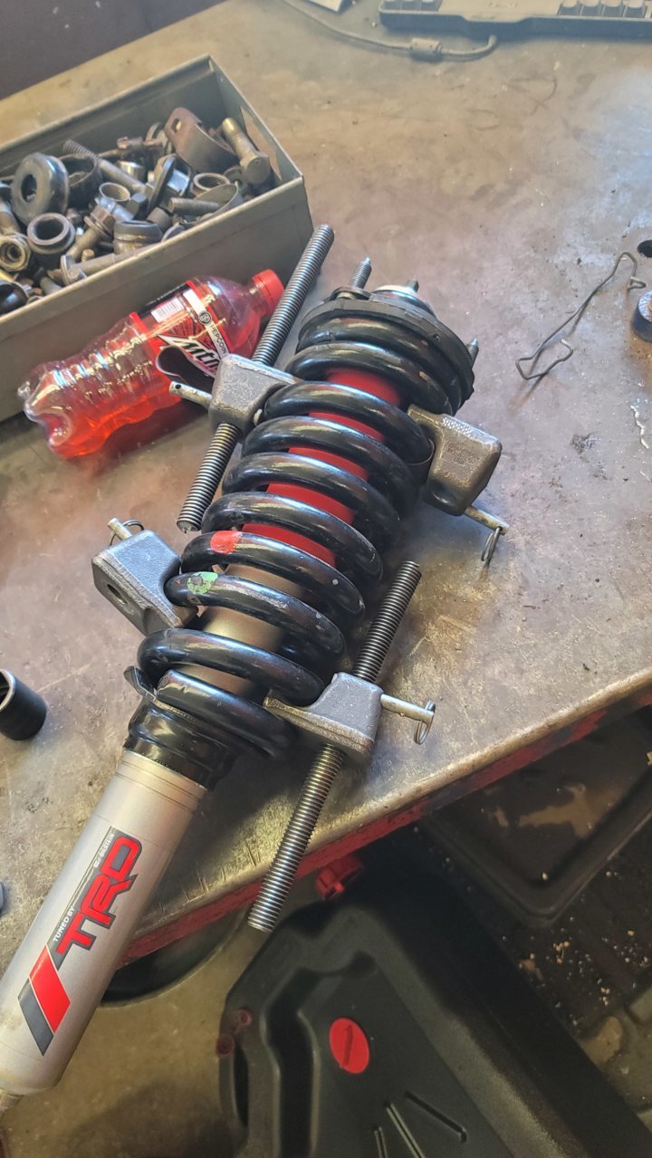

    Dealer installed OEM TRD 2" Lift on my 2020 DCSB OR today. Got it back around 6:45 tonight. Definitely seemed higher in the front than I was anticipating. Then drove it out of the dealership and immediately noticed a bounce on the front. Drove it around the block and right back to dealer - everyone was gone already for the night. Left VM and txt. After some research it looks like they placed the spring perch on the front shocks upside down - sigh. Drove it home and taking it back tomorrow.
    Question for those of you that know more than I - I noticed the UCA was hitting the spring and there were other non-normal sounds and vibrations around 60 MPH. What should I be concerned about damage wise and require they replace? Springs overly compressed, UTAs hitting springs and at very steep angle, bearings, seals, Circlip, shocks?
    Thanks!

    Yep. Defininately upside down on the spring perch. I think it might b a good idea for anyone getting the lift installed at a dealer to print out the instructions yourself and give it to them beforehand. This shouldnt b happening.

    I would make sure the cv boots and joints get checked and also the bearing in the transaxle where the drivers side axle slides into. Be a good idea to get something on paper with a description of the mishap even if everything checks ok for future reference

    Most kits do not come with instructions, mine didn't.
    Your dealer followed the IPB and mimiced the OR struts which have the perches upside down (I was using a public service manual from last year). I'm surprised and WORRIED that they were able to get it on like that. I could not line up the strut with it backwards (using the non-spring compressor method) for the same reason and one side of the spring compressor I used broke when I went to decompress the assembly because something just felt wrong. I ended up throwing the hat on because I knew the second was going to break and it kept me from Yeeting my strut.
    Like seriously, I bench 235 and curl 65 on a triple dozen rep set daily. Installing those with the hat backwards (ignoring the face that the spring would not seat correctly) required such wrenching that I pulled a muscle in my wrist. Whatever mechanic has nothing but retard strength and desperation going for them. I would just for good measure DEMAND that they install all new springs hats, and bump stops just because it's their fuck up.
    Also I would not drive it any further. I noticed the spring had maybe half of it on the perch on most of the surface. It can run the risk of slipping off.
    Actually now that I think of it. I would be not only demanding they install all new components but refund you the full labor fee because a certified Toyota Mechanic and Dealership not only have some mechanical skill to know that something ain't right, Toyota should be providing them with the proper information and they should know where to find such information to do a proper install the first time.
    Pic related.
