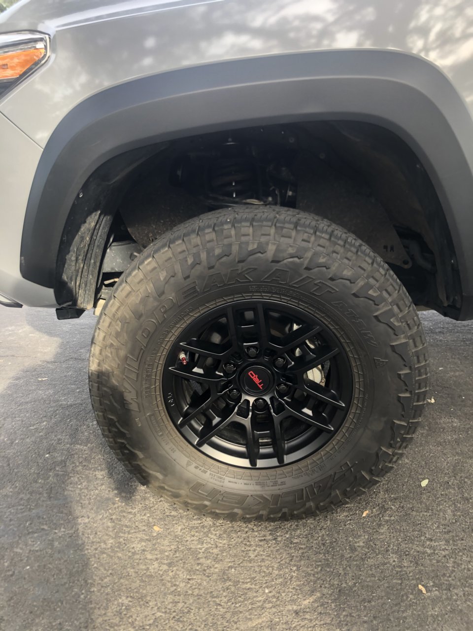

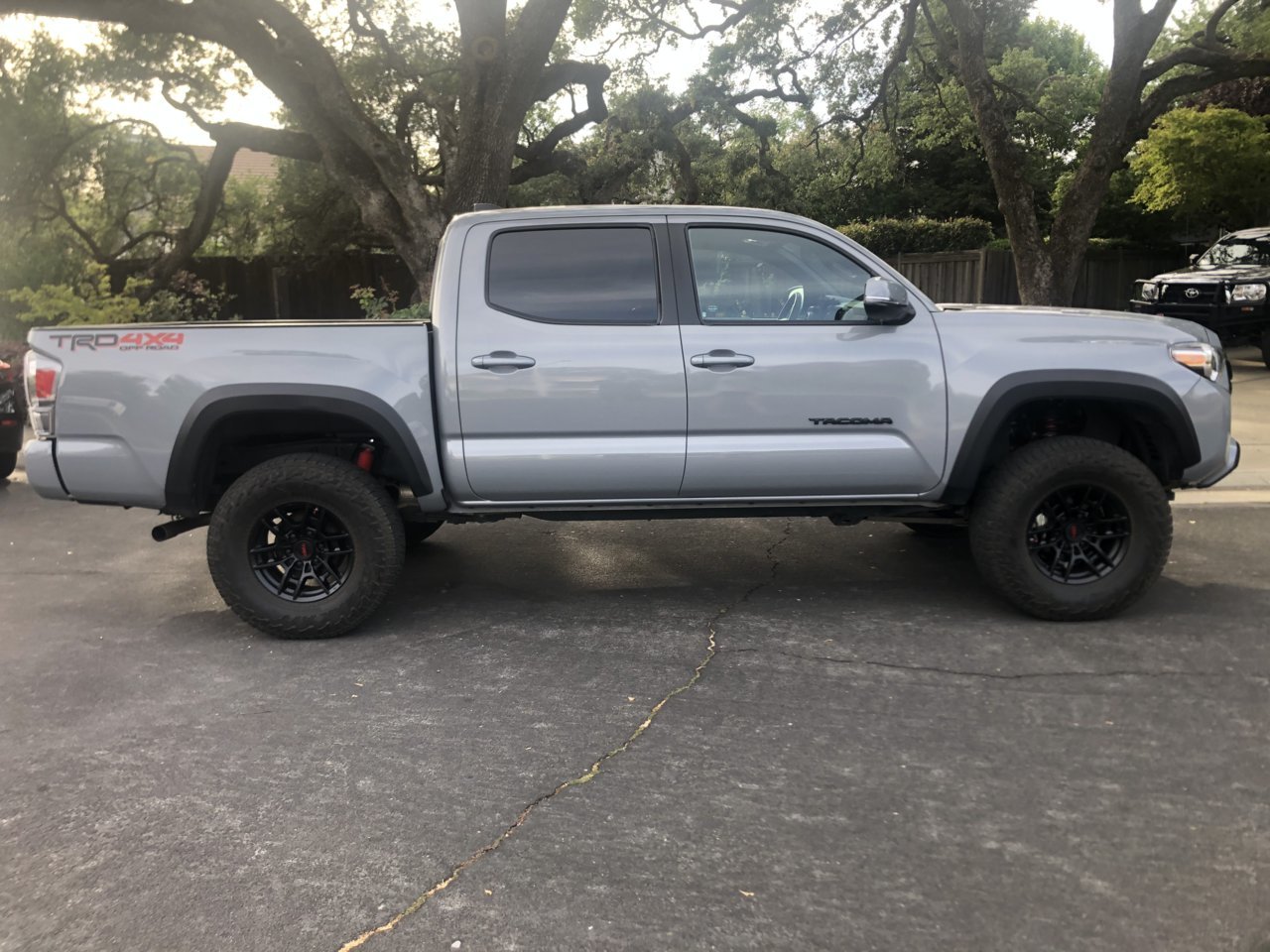

    Thanks guys. I felt pretty good after talking to both service managers and the mechanic this morning. They were pretty pissed and embarrassed. They ended up giving me a warranty and no charge alignment for two years. They did spec it all out and said everything looks good.
    Really drives nice now. As many have stated in this thread (when installed correctly) the kit feels very similar to stock but tightens up the brake dive and corners some. I love the look - I think this is how all TRDOR Tacos should come. I have a .5 inch rake still. Super happy driving it home tonight. :thumbsup:

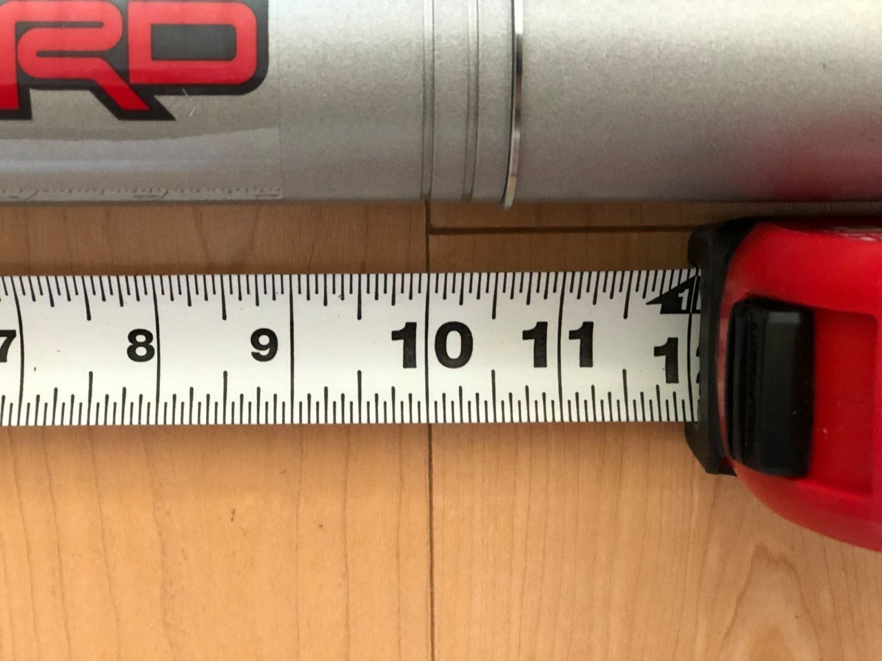

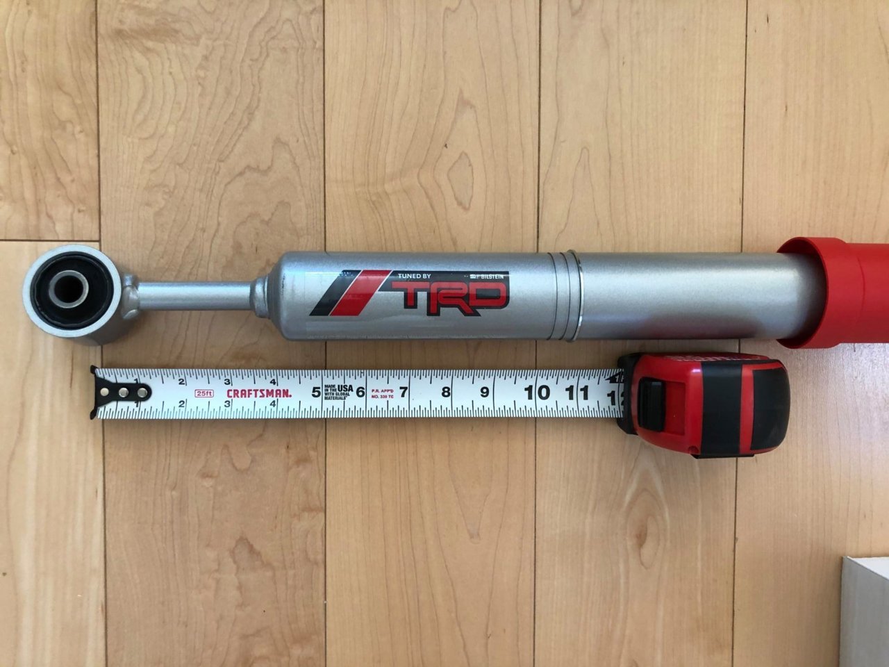

    Has anyone run these front shock with OME springs instead of stock springs, looks like the TRD shock has 3 circlip positions and the Bilstein 5100 shock has 5 circlip positions. To run OME 885 with Bilstein, I would use the bottom circlip position. I wonder even if I used the bottom position on the TRD shock, would that be too much preload? Anyone knows???

    You or someone would need to measure the distance between the two spring cups where the spring rests (top and bottom) for each assembly on the different clip positions you are interested in comparing when the dampener is at full extension.
    That should provide the key distance (top of spring to bottom of spring) of the spring cups to compare for a preload comparison.

    I just measured. It is 6mm between each ring

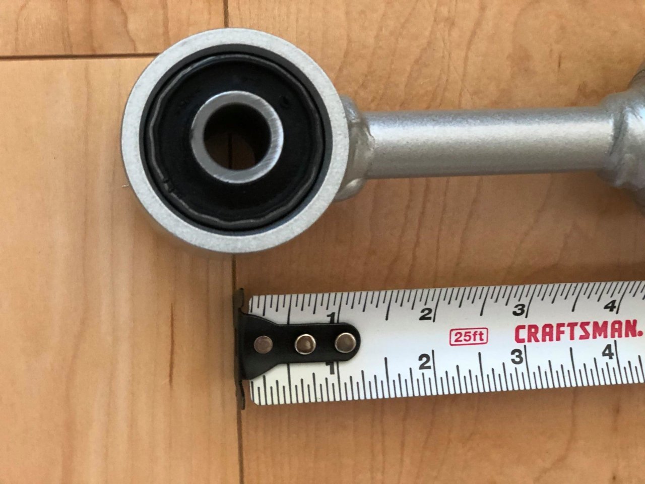

    OK, I measured it. From the center of lower shock eye to the 1st circlip is almost exactly 10 inches. Who ever has the 5100 laying around, can you please measure your?

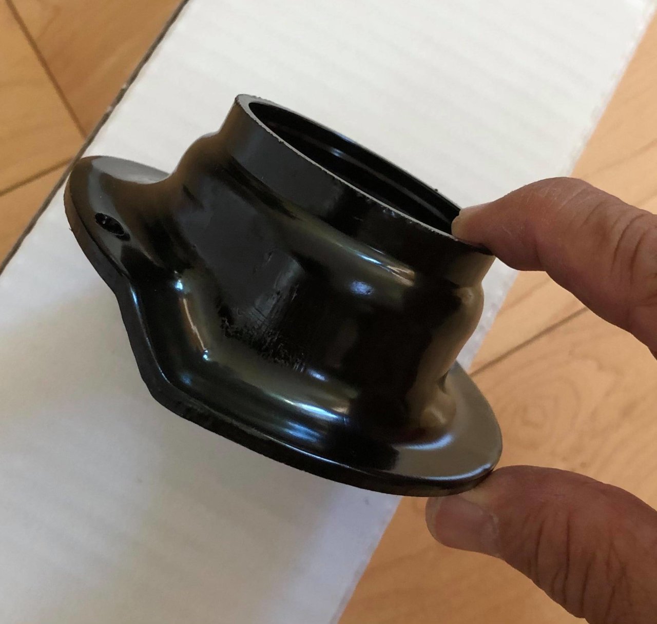

    And this is the shock hat of the TRD, is it the same as the one on the Bilstein 5100 so it can fit the OME spring? Thanks!

    OME springs will sagg, so use you stock coils. Plus OME will make it ride like shit. Bilsteins were designed to be used with the stock coils. One thing is Bolstein gives you a lifetime warranty for the 5100s as long as the stock coils are used.
