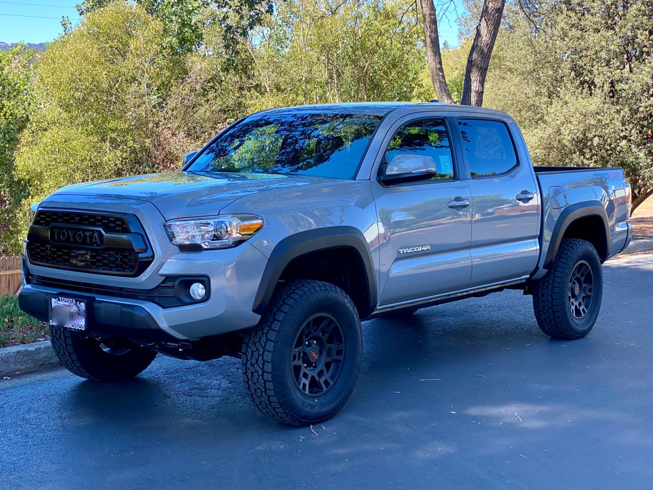

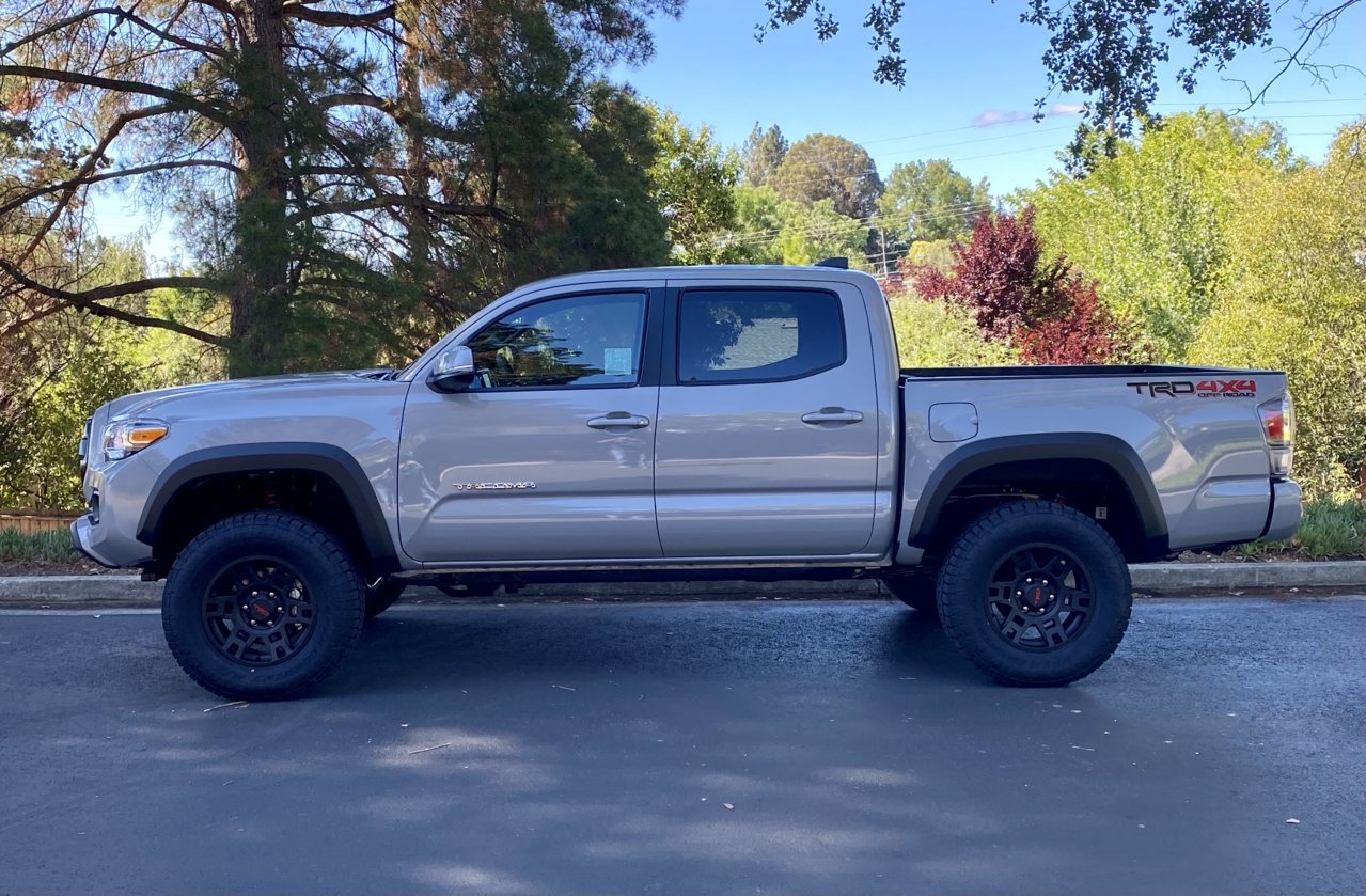

    Hi all, I’m new here and thought I’d put up a couple pics of my 2021 Off-Road I just got last week. Had the dealer install the TRD lift before I drove it off the lot. They honored a Memorial Day sale price on the lift for me, $1050 and I couldn’t pass it up. So far I couldn’t be happier with it.

    Nice looking truck...
