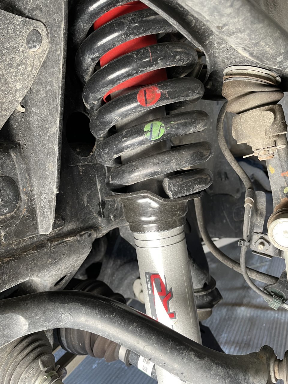

    Howdy,
    Long time reader, first time poster. I just got this lift installed on my 2020 TRD-OR a day ago, and I noticed a few things seemed off. The nose seemed a tad high with the level, but off road it seemed nice if a little bouncy. However, hat bouncing translates pretty significantly when I hit a small bump on the road. Basically after a small bump the nose bobs and the truck rocks front to back slightly ~3-5 times before settling out. Is this normal with a lift like this? This is my first pickup and first lift, so I'm not familiar with what should be expected in ride change with a small leveling lift like this.
    I did a little digging to try to answer my own question, but I think I'm just accumulating them now. My latest is from looking at some posted images in this thread of other installs. I think the dealer installed my front coil perches upside down, but I honestly don't know. Again next to no experience in this. Here's a pic, are they flipped? If so, it would certainly explain why the nose seems a tad high.

  12. Jun 27, 2021 at 11:33 AM
    #1352
    16TacomaSport
    16TacomaSport Well-Known Member
    Mar 2, 2016
    #179972
    748
    Jon
    Pittsburgh PA
    2022 Camaro SS 1LE 6spd
    yep, thats upside down. the screwed up the install

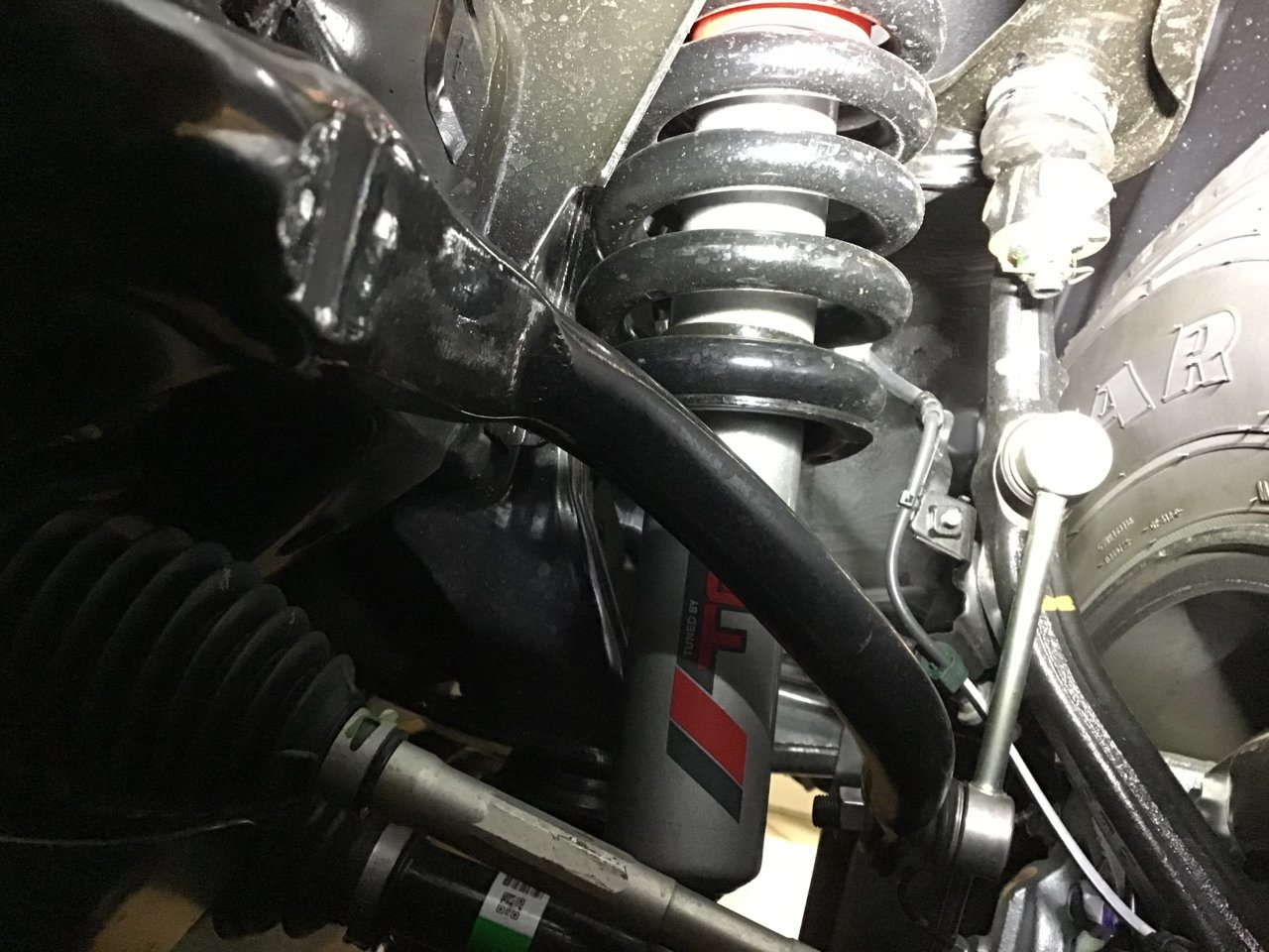

  13. Jun 27, 2021 at 11:33 AM
    #1353
    EL Taco Verde
    EL Taco Verde Well-Known Member
    Mar 29, 2017
    #214751
    142
    2021 TRD Off Road
    Factory lift kit. Lomax tri fold Tonneau.
    Look upside down, mine looks like this, ride is not at all like you describe. Rides close to stock, in my opinion better.

  14. Jun 27, 2021 at 11:47 AM

  15. Jun 27, 2021 at 9:56 PM

  16. Jun 28, 2021 at 4:16 AM

  17. Jun 28, 2021 at 4:59 AM
    #1357
    Paulndot
    Paulndot Well-Known Member
    Apr 22, 2020
    #325488
    493
    2020 TRD Off Road
    Looks like a photo illusion. There's a light reflection in the same shape (but opposite orientation) right above the mark you're referring to.

  18. Jun 28, 2021 at 6:57 AM
    #1358
    Commander Waffle
    Commander Waffle Member
    Jun 27, 2021
    #369742
    18
    Alex
    SE Idaho
    2020 Cement Grey TRD-OR or the Grey Off-Road Taco (GORT)
    TRD Lift Kit, CBI full skids and rock-sliders (steel), DiamondBack HD Tonneau.
    Can confirm; just a glare artifact in the photo. No rubbing in the sticker region.
    I’ve just dropped it off to get the install corrected.
