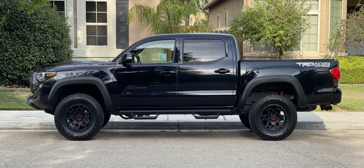

    I replace the rear with a 1.5inch block and work out fine. No issue with tss whatsoever over 5k miles.

    where did you get your 1.5” block?

    Got it from Amazon. Now the rear is almost 1 inch higher than the front. I only wanted 1/2 inch rake.

    looks good like that just my $.02

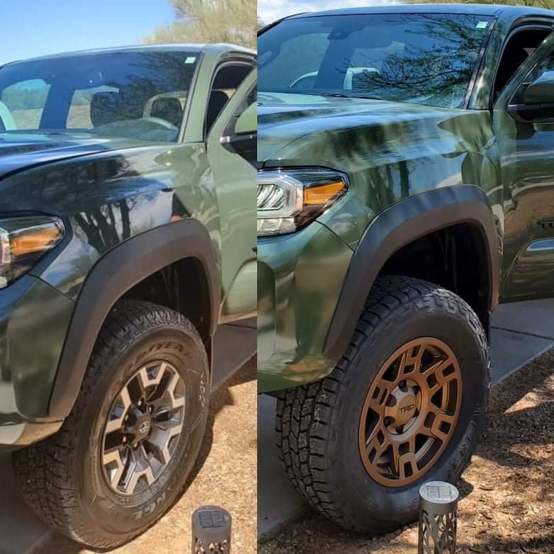

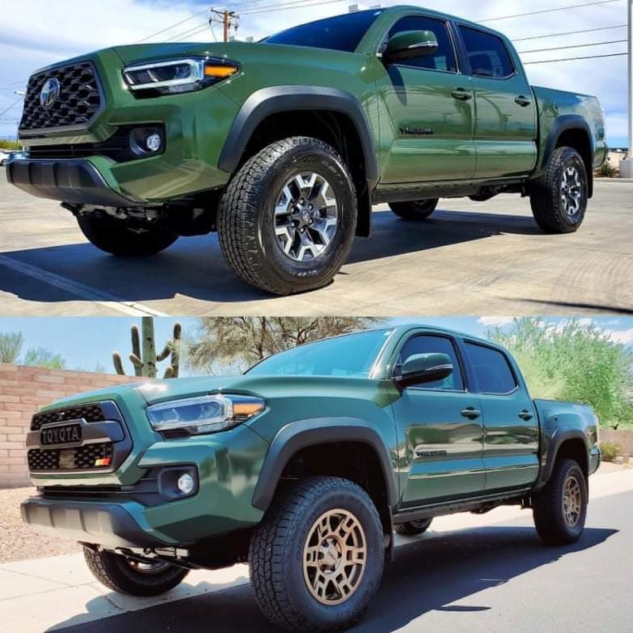

    Before and after.

    What tires?

    265/70R17 Cooper AT3 4S

    Very nice!!!!

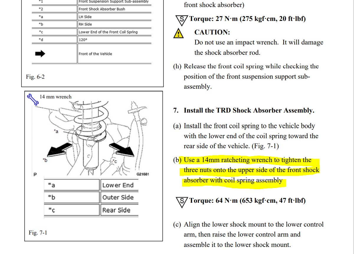

    Don't you just re-use the top nuts off the factory OEM front shock after you remove it from the truck?

    you can but they are locking nuts and once you remove them it is not as proper of a locking nut anymore. If you reuse them I would just check them every so often to make sure they say tight or use some blue locktite

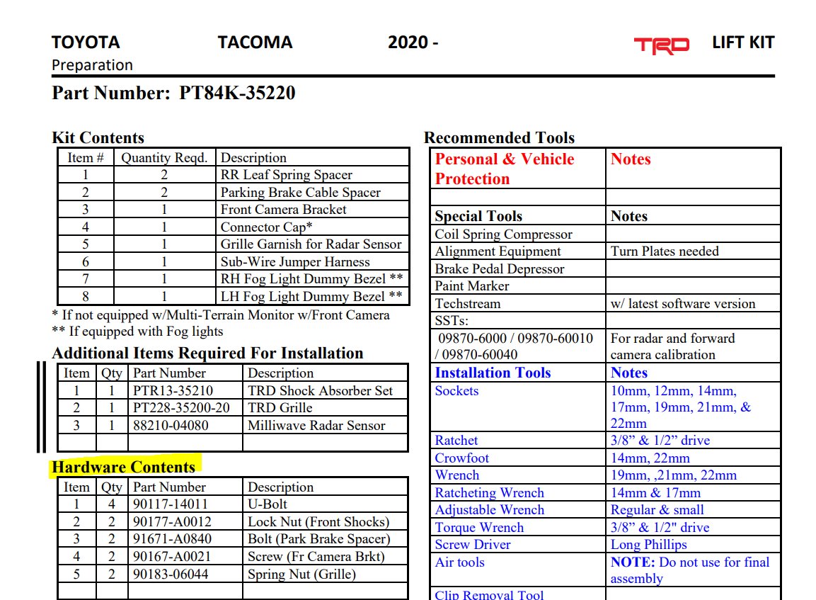

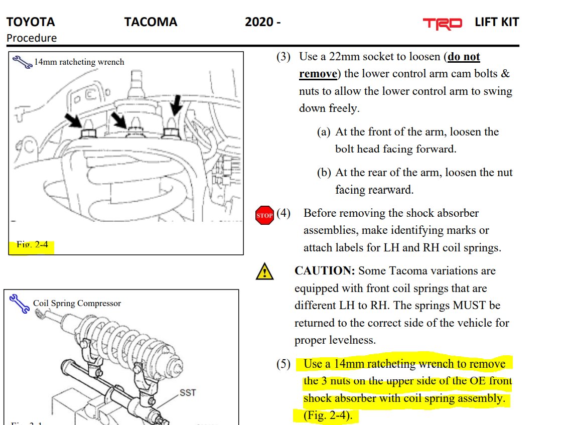

    Unsure how you came up with this??
    The TRD lift kit does not come with new nuts (hardware contents) to secure the shock assembly top plate studs to the frame plate.
    Directions even indicate the procedural process that should be followed by a tech.
    Remove the original three nuts to remove the factory shock and re-use them for mounting the new shock.

    I am going by what I have seen for installs for other lifts. Then don't use it not my problem. I was just saying it's good to replace a $2 nut.

    and I'm only providing you the directions right from Toyota. Re-use the nuts removed from the factory lift.
    I re-used the three top suspension nuts from my factory removed junk when I installed my new Bilstein 6112s and Bilstein springs. No problems what so ever.
