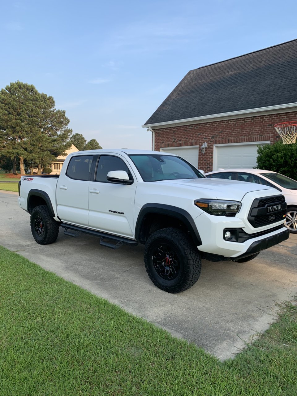

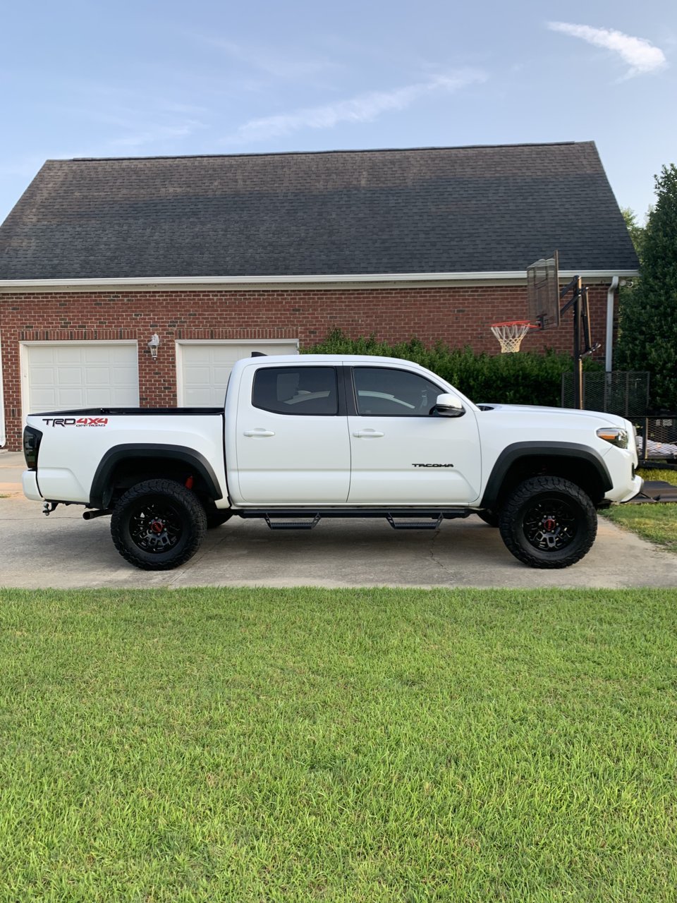

    Did the TRD Lift Kit yesterday on my sons truck. Found it at a local dealership and picked it up. Got it for $1173.00 and they were offering free shipping!
    Before
    A9F9EB88-4AF6-4770-A8F3-8EDC506CF39B.jpg 92137F31-F212-4619-93FB-14E04FB20190.jpg
    Unframed, mosccat and Goatfrog like this.
  12. Jul 6, 2021 at 3:41 PM
    #1432
    Socom71
    Socom71 New Member
    Jul 5, 2021
    #370447
    4
    This is after we were done
    DogStar84, RCrumb, Taco_chip and 8 others like this.

    We put a thin washer on when we were putting it together and the warning light did come on after a short drive. It stayed on for maybe 50 miles then went out and hasn’t been back on since. Gonna switch to the grille that came with the kit this weekend but just gonna transfer everything over. Won’t change the sensor out . He will be headed to get alignment in the morning. It drove very well with no noticeable change or pulling one way or the other. Installed it myself in the driveway. Wasn’t to bad at all. Very satisfied with it.

    Sorry, the fist pics I posted said before but they were the only ones I had pre lift. They actually are the pics we took when we brought it home from the dealership. Didn’t want to misrepresent.
