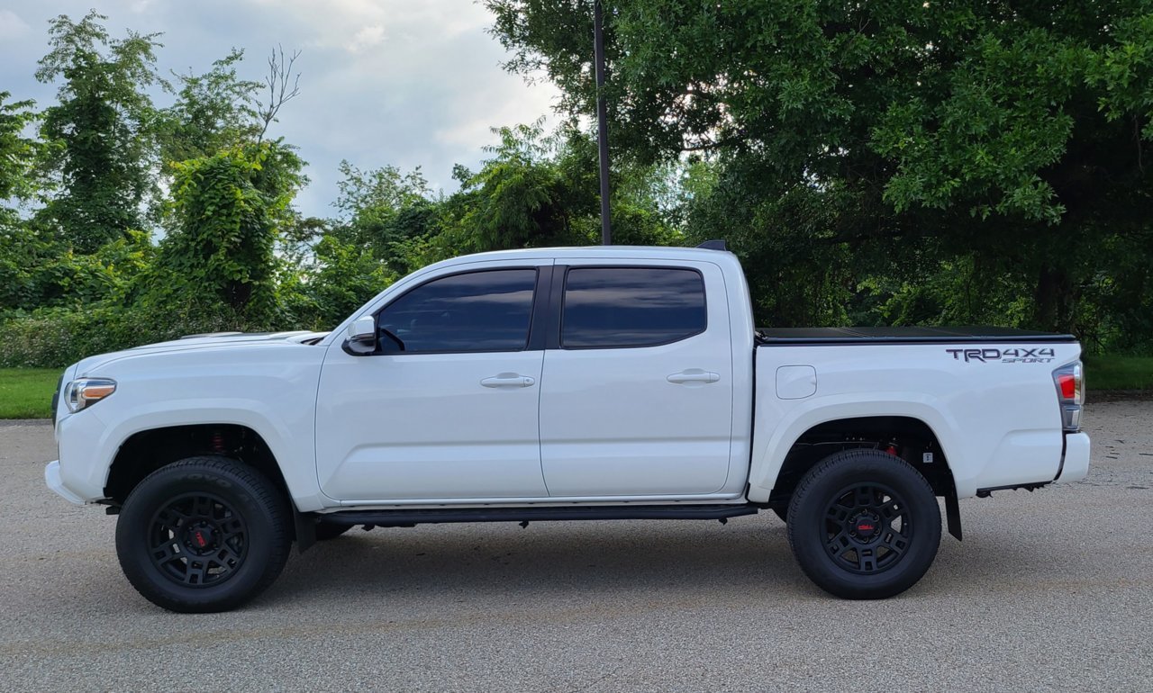

    So got my rear 1" blocks in. So truck has about 1/2" of rake now. I am done till I need new tires.
    Well until I get around to putting the ECGS in come fall or so. I want to see how it feels now the 1" rear is done. A quick ride around the block and I didn't notice the vibration as much as I did before the rear was done.

    When you raise the back up it puts more weight on the front end and the lift amount actually will decrease on the front suspension which most likely minimized the vibration you experienced prior to lifting the back end up.
    If you would have know in advance you could have checked the inner CV boots on each front axle to see if they (the fins) were rubbing prior and then again after the rear lift to know. You can look right now and see if they are slightly worn at the ends of the fins on the inner cv boots with a high power light to get an idea of what transpired prior to the install of the 1" block.

    Well at normal speeds the vibration is the same. So it didn't reduce it. Still isn't a huge deal so I will love with it now till I feel like swapping out the bushing. I'd say for anyone don't let that hinder you if you want to lift it
