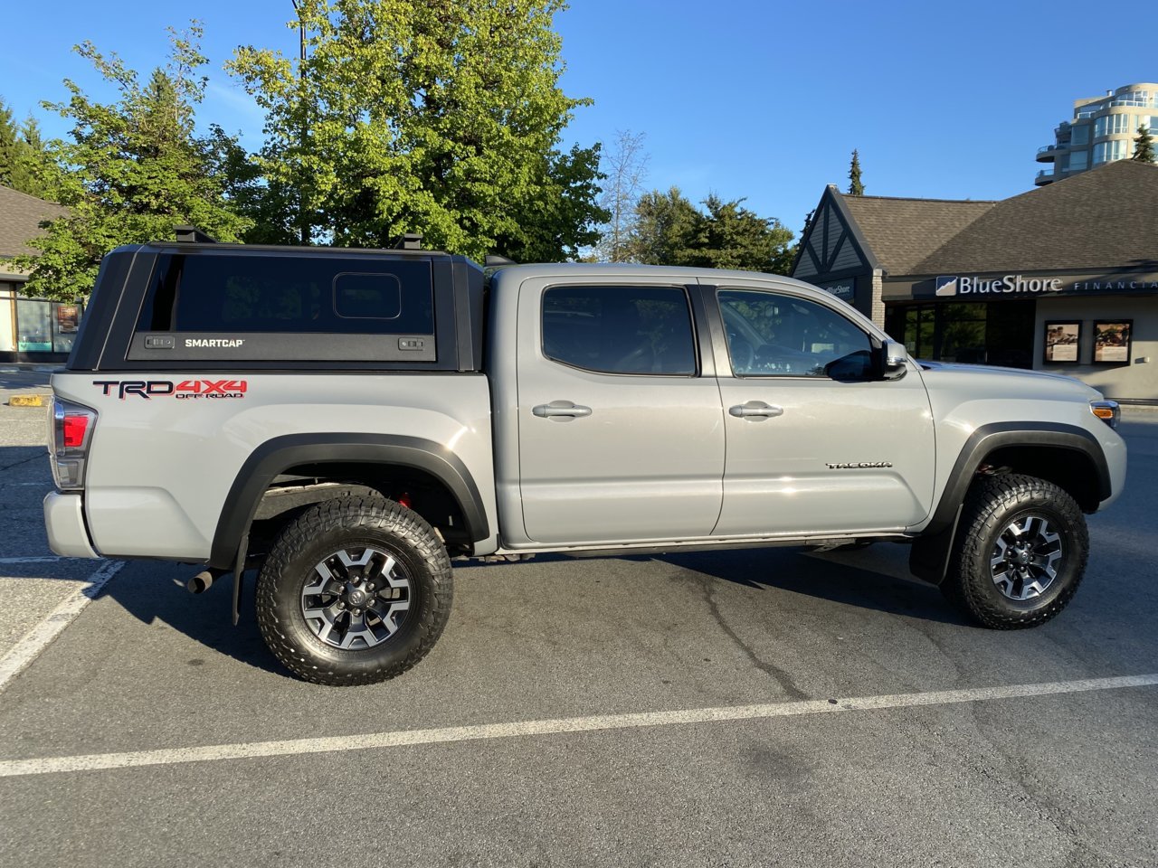

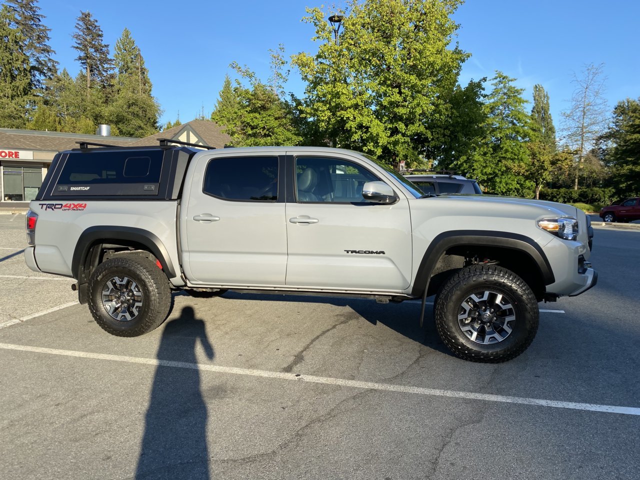

    I just had the Dealer install the "TRD Performance Suspension Upgrade Kit". They needed two days to do the install, I'm in Canada and with all fees and taxes dropped shy of 3K$. But for me they fold the suspension into my extended warranty; as well, it included the grill/sensor swap and of course an alignment.
    Now I have all of the stock parts and suspension, so my wife will know what I did. lol.
    I can say that the 2" in the front makes a noticeable difference for visibility, as and the tuning of the suspension feels tighter, the brake dive in the front end is gone too!
    So, I know I overpaid to some extent, but alas... it is done.

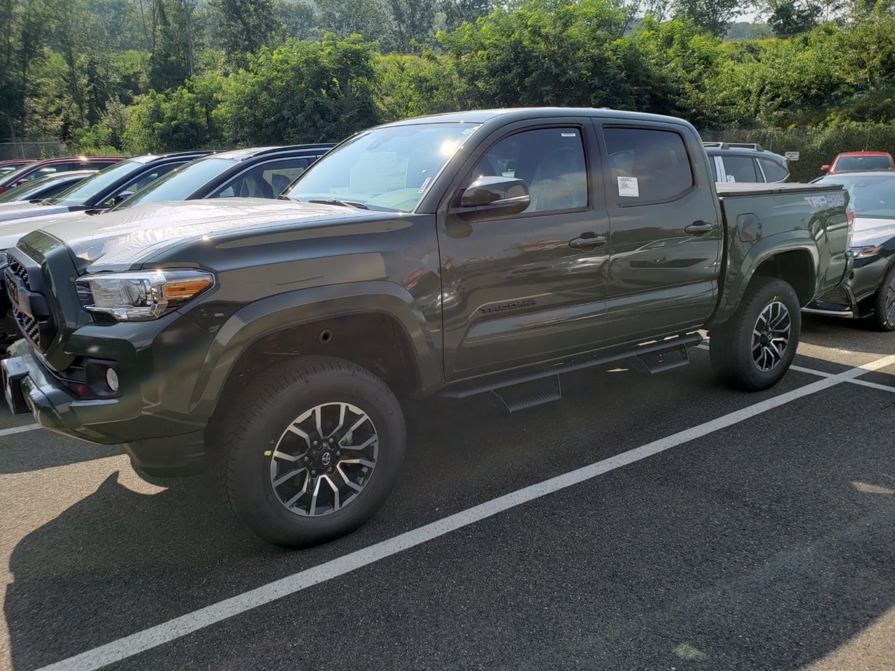

    Lift on stock wheels

    Looks awesome!!

    Pics be here:
    4CE0EDA3-FD6E-4FAB-9D5F-F02443AD3D69.jpg B33E0BBC-C828-4BD7-AEA1-E0ADC7CA134C.jpg

    Looks great!!

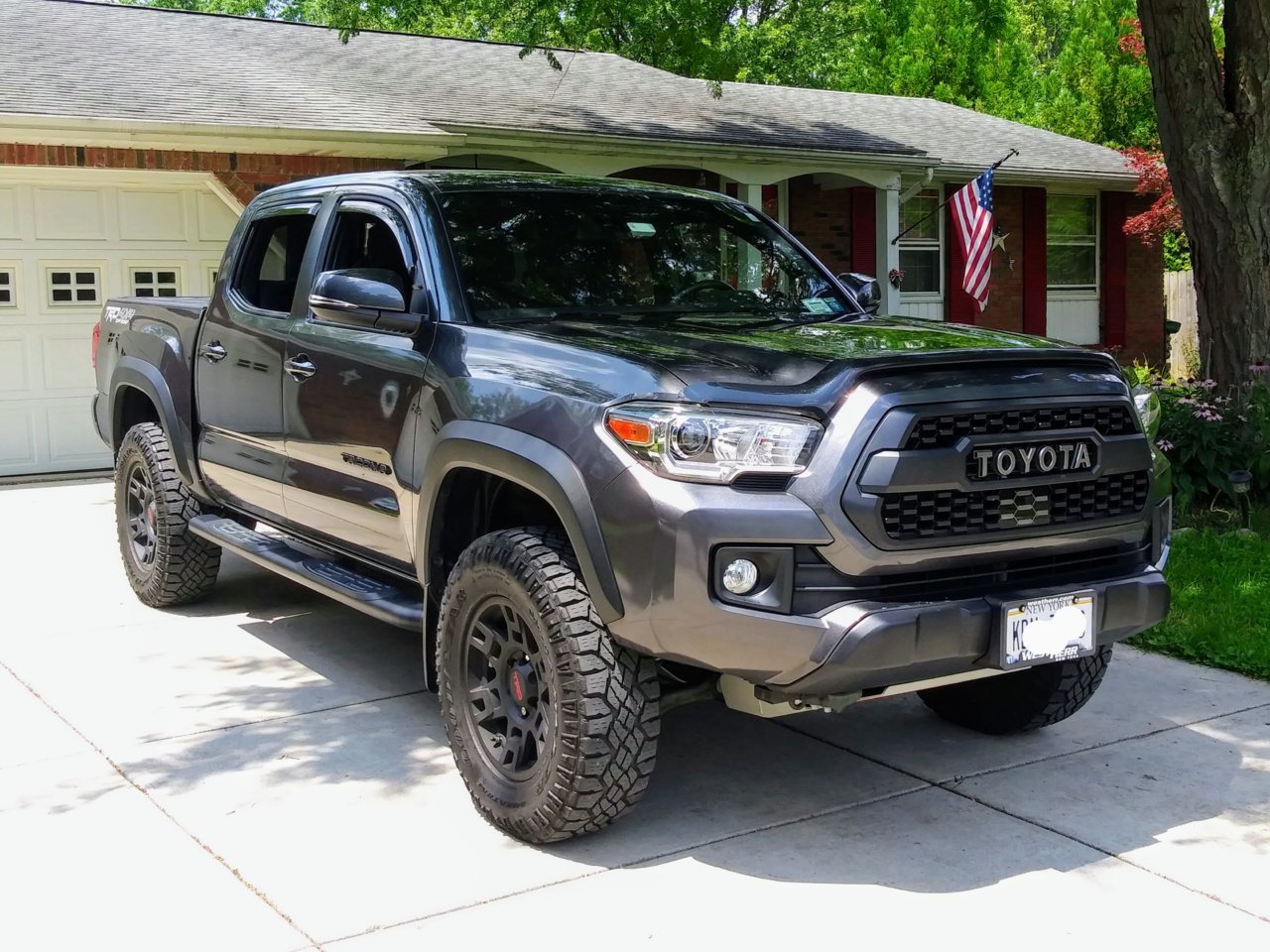

    Just a quick review: So after few weeks driving with the TRD 2" lift I really like it. For the back I used add 3-leaf springs instead of the Toyota 1" block and I removed the stock overload leaves but plan to put them back to the spring packs to carry heavier load. It's bit firmer on the road and pretty comfy off-road. I'm running 285/75-R16 BFG KO2 AT with stock UCA. The TRD lift with rear add 3-leaf spring cost around $550 and I did the installation myself, here's a video of us doing off-road testing out the TRD lift.
    The Taco is not too bad compared to my FJ40:

    Nice! What wheel spacers are you using to clear the UCA and not rub the Cab Mount? Thanks!

    Since I use the stock wheels, I'm using Spidertrak 1.25" spacers, also the front mud flaps were removed
