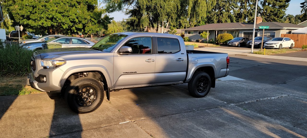

    Is that silver or cement? Looks great.

    that’s exactly what I have. The 4Runner folks love them… and they are making their way to taco’s now.
