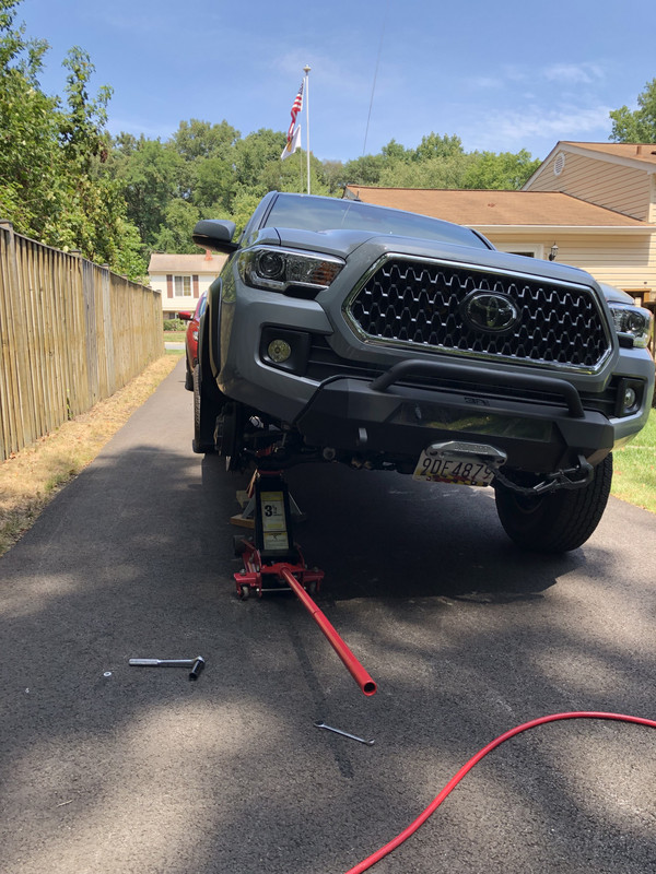

    Little interesting bit of info here. The TRD OEM lift kit rear shocks; they will hit maximum extension when the rear suspension fully droops with 2" AAL's installed. I thought these were extended shocks?
    Only got the AAL's and rear shocks done. The AAL's kicked my ass. Compressing the AAL's in the leaf pack bent both of my Harbor Freight 8" C-clamps. Keerist! Going to take those back tomorrow and see if I can exchange them for another set of cheap Chinese manufactured crap.
    Installing the AAL on the left rear was a bit of a challenge with the brake lines. I ended up dropping the axle on that side as far as it would go without stressing the brake lines, and then I braced the bottom axle shock mount with wood blocks. Then I moved my floor jack to the front portion of the rear leaf spring and compressed it upwards. This gave me enough room to insert the overload spring with the AAL on top of it, and the leaf bolt so I could feed that up through the leaf's above it.
    Tomorrow I will replace the front shocks and MAYBE remove the needle bearing for the ECGS Bushing installation.
    I'm getting too old to be crawling around on all fours doing this shit. Hot, sweaty, greasy, but I love it. And I'm saving several hundred dollars doing it myself.

    Finished!
    Had to jack the shit (compress the spring) the new shock on the passenger side. Not sure exactly why. Everything was lined up properly. The driver's side went with no issues.
    Have an appointment with one of the 'Taco dealers this Tuesday for the required alignment.

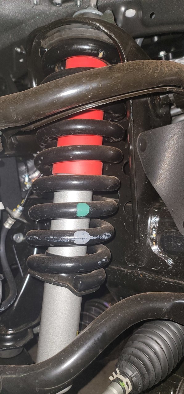

    Hey guys, is my TRD lift kit installed incorrectly? This is a pic of my front spring.....

    That looks like your right passenger side shock/coil. The bottom end of the spring needs to be facing the rear. Yours is facing the front. It needs to be rotated 180 degrees.
    Truth be told, when I installed my TRD OEM shocks using my OEM spring, the bottom end of my passenger side coil spring is not perfectly pointing to the rear of the vehicle, as the installation manual states. I'm not sure of what the ramifications are if the bottom end of the coil spring is not facing the rear of the vehicle.

    The pic is actually the driver side. However, it does seem "off" by 90 degree. However, the images online show a similar configuration. I am not sure which way is right...I'll stop by a dealer and check.

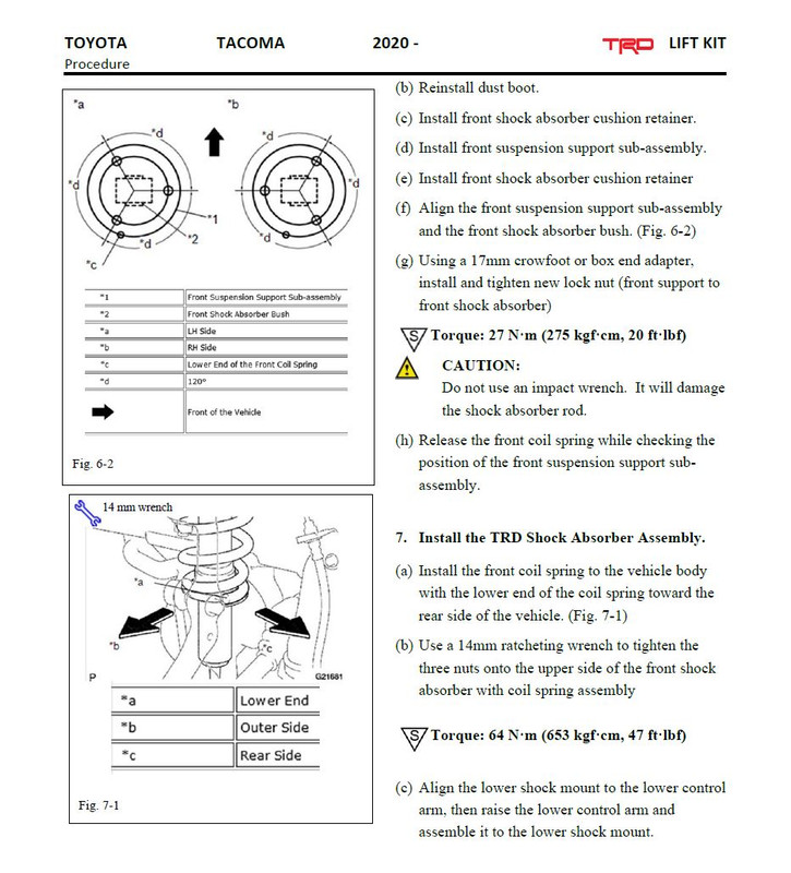

    I have the installation manual for the TRD lift kit. When I get home later, I can post the page that indicates the bottom spring end should be oriented to the rear of the vehicle.

    I know the general manual mentioned that the spring must be in rear. This also applies to the trd lift kit as well? If so, please post so I can share with the dealer!

    Screenshot of page 7 of the TRD Lift Kit installation procedures. Specifically item 7(a) below::

    Looks like my passenger side is correct, but the driver side is off by 90 deg....
