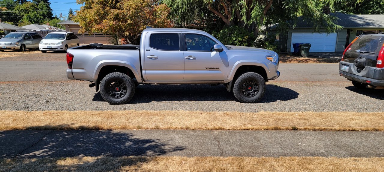

    The Bilstein suspension feels leagues better than my stock SR5 suspension. And it gave me room to fit 17x7 TRD Pro Sema wheels with 275/70/17 Falken Wildpeaks on my truck.
    For me, I'm satisfied with my rig.

    Looks good

    Thanks. No rub at all.
