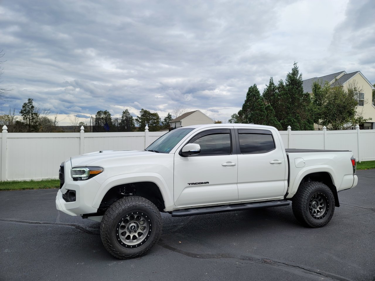

    I was thinking of getting the trd oem lift but i opted out and got Bilstein 6112/5160 with headstrong rear AAL with 1/2" shim for 2" lift. I don't have any issues with my TSS20211030_154301.jpg
