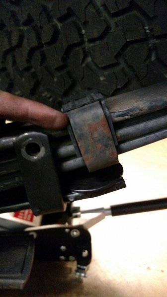

    Been a while since I posted. I installed the 3 leaf AAL from Wheelers and 5100's. I was sitting at 22 1/2" from center of the hub to the fender and I retained the overload spring. After the install I'm at 24 1/2". This should really help when I have the RTT mounted and all of our camping gear. Shouldn't have the saggy rear end disease anymore.
    I ran into a few snags along the way. For some reason the location of the brake cable mount was in the way of the new AAL clamp. I had to remove it, trim it up and weld it to the new clamp. Attached are some pics of the install. I will add a profile pic of the truck unloaded and loaded later on this week.
    Goodies
    I cut this clamp off as you can see it will interfere with the new spring.
    Driver side almost finished
    Then I had to remove this bracket as it was hitting the new leaf packs clamp.
    I needed a place to mount the brake cable so I used the part I cut off, trimmed it and welded it up.
    The bracket wouldn't reach
    Quick fab and perfect.
    Passenger side
    A little primer and paint and I was good to go. The ride is a huge improvement!
