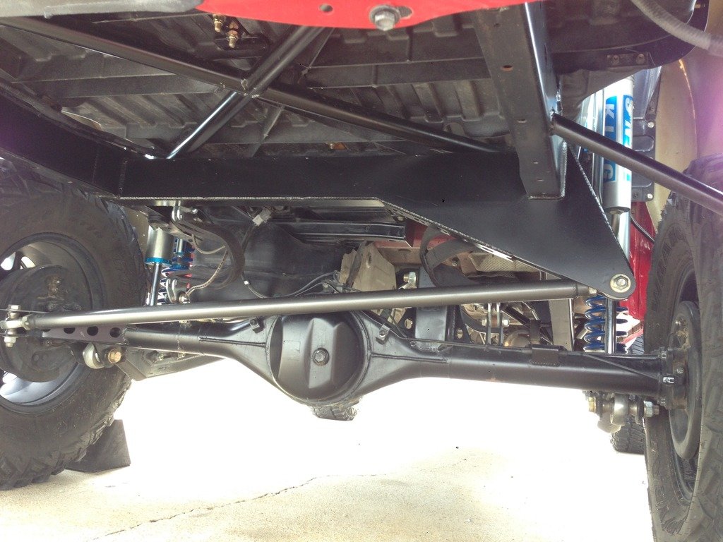

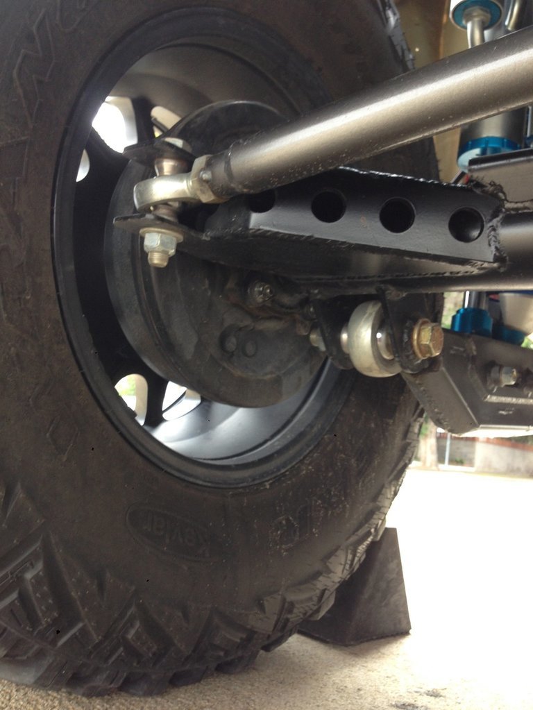

    Can you post more pics of your links please, having a nearly identical 3 link set up built right now...
    * being built

    Issue is the driveshaft would be way to long as a 1 piece or else I would. Yours being 4x4 would be at least a foot shorter. Do you have any pictures of it though? And what pictures do you want of the link setup?

    Ah my bad you are right amigo I forgot you were 2wd...Tom Woods shop did explain that issue to me which is why they felt better making even my 4wd one out of larger dia tubing...with the larger drive shaft diameter they can go a bit longer and the double cardon joint itself is quite
    huge...maybe it could work on a 2wd ? It is pouring down here right now but when it stops I can snap you a couple of pics.
    I was curious to see a side view of your finished links please , thanks !

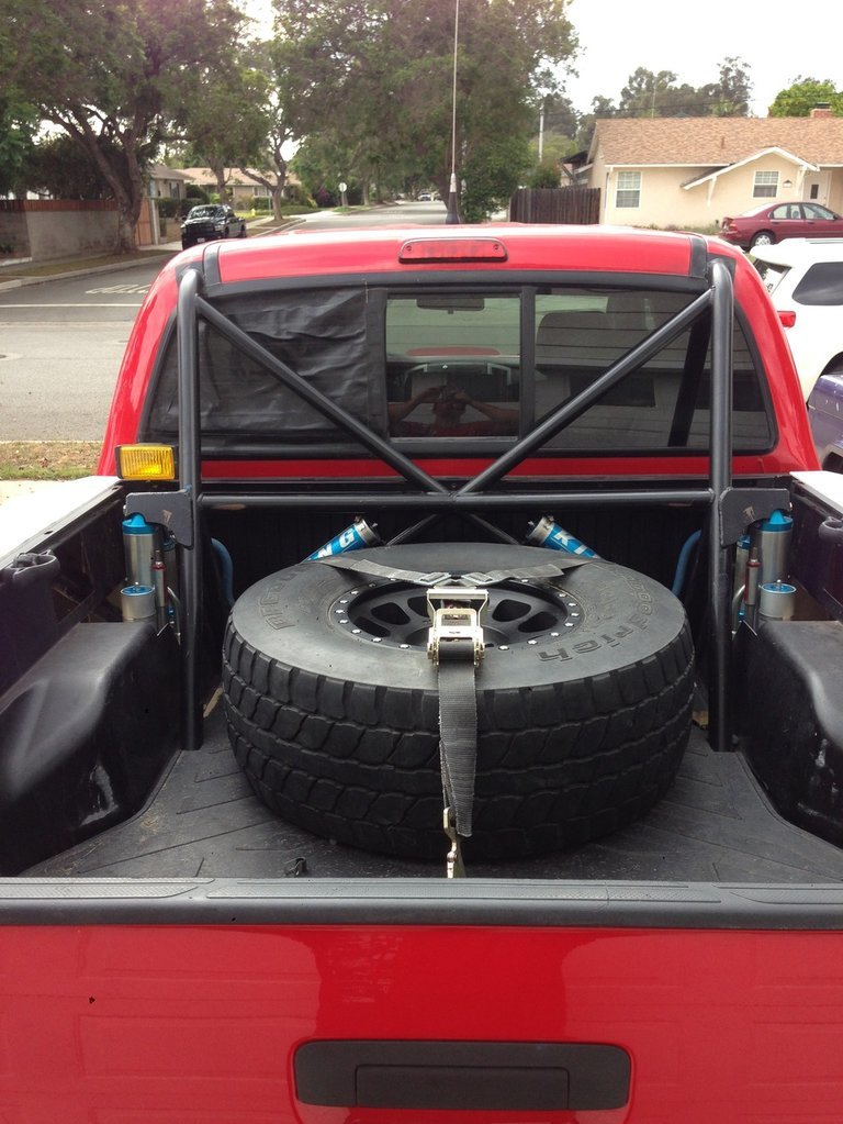

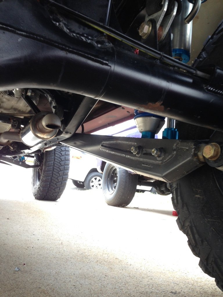

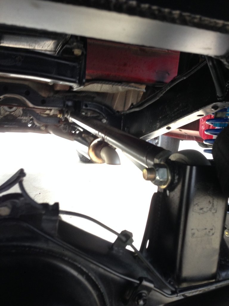

    Don't mind the broken window. When I pull the spare out it has full bed space. Lost only a couple inches in the corners
    Panhard
    Panhard axle mount
    Best I could do of the lower link with the tire on.

    Upper link

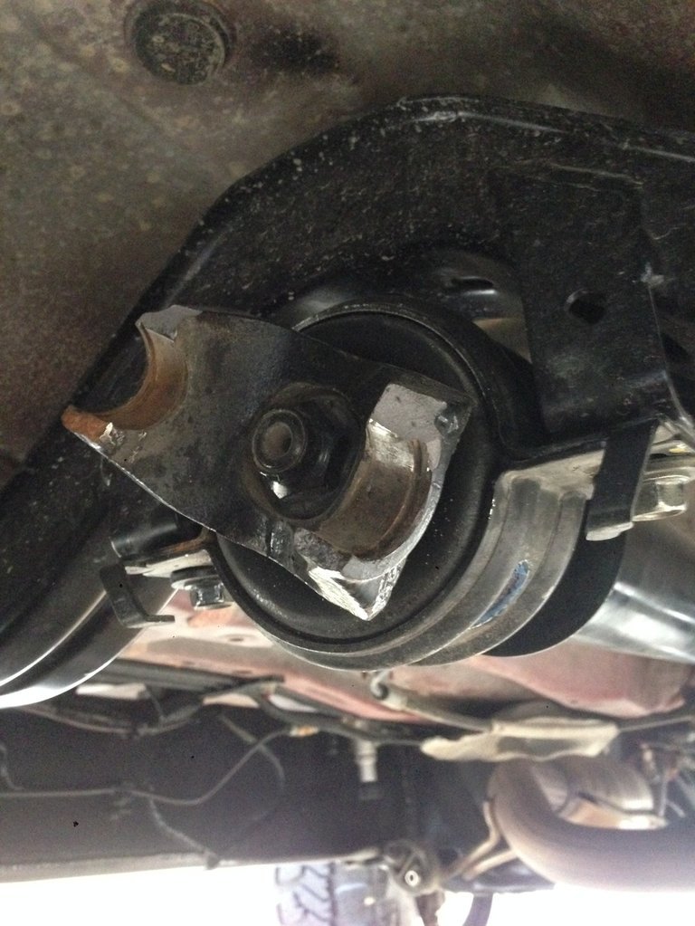

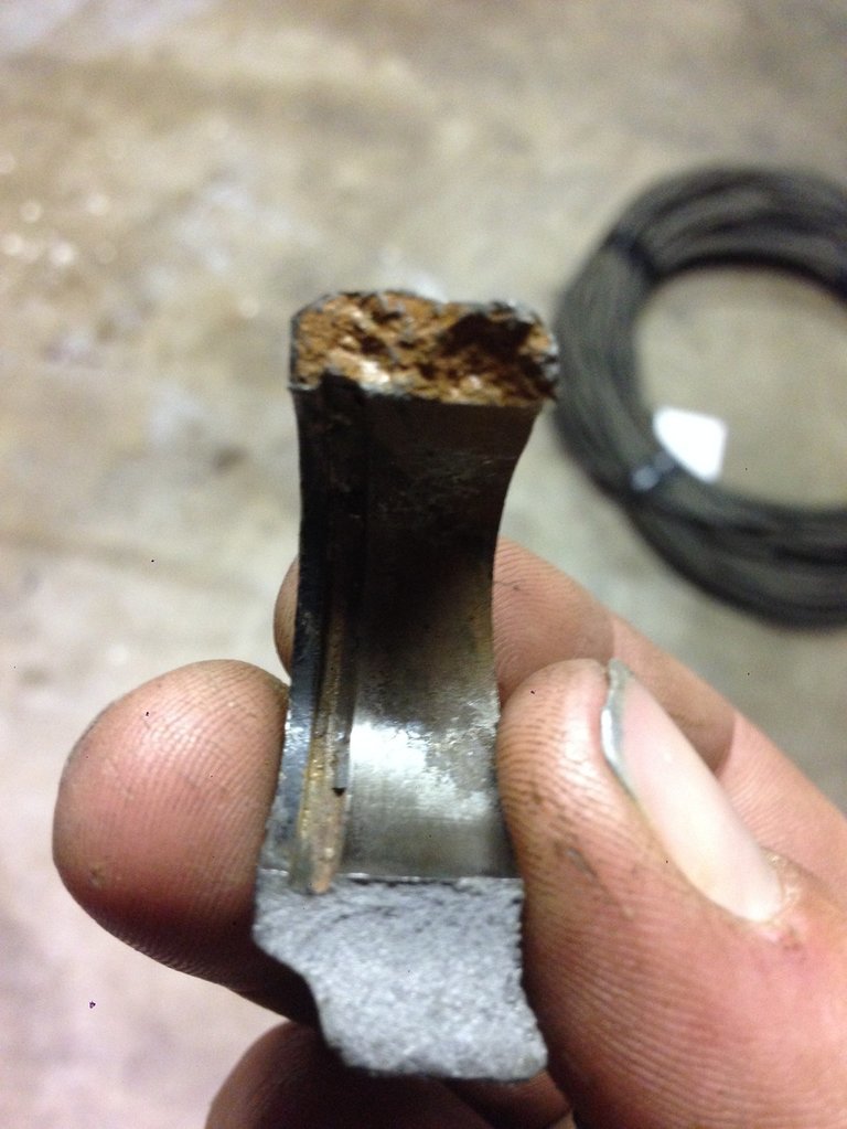

    I agree with your assessment. I think a visit to the driveline shop is in order. That rust tells the tale. I definitely would not be happy:frusty:

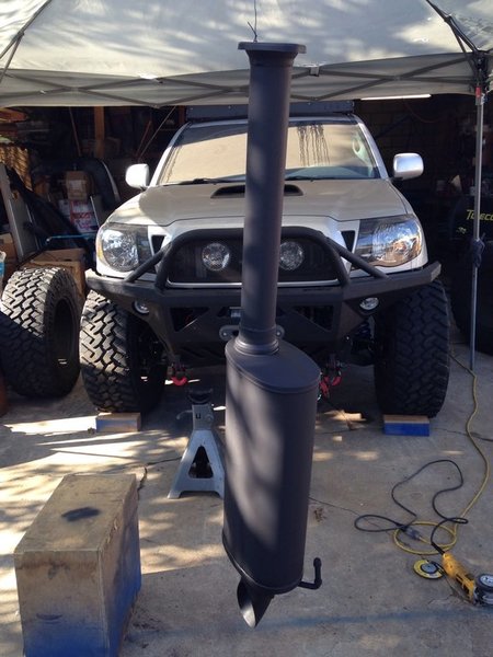

    What muffler did you use ? I had a Magnaflow ( oval style ) that I reused, I shortened the pipe before the muffler to clear the third at droop and did a small dump tip too but after driving the truck for the first time yesterday discovered that it is horribly loud...the drone inside the cab is so bad it sounds like it is coming through the stereo at max volume :eek:

    What series Magnaflow? Maybe add a resonator to help calm it down.

    I'm not sure of the model # it is just the oval style one that came with a cat back kit I bought years ago. I think you are right, I will probably have to use a resonator to knock down the drone. I would need to find pretty short one because this is all I have left for an exahaust, same issue that you can see in Brian's photos I just installed a 3 link and the 3rd is right in the way.image.jpg
