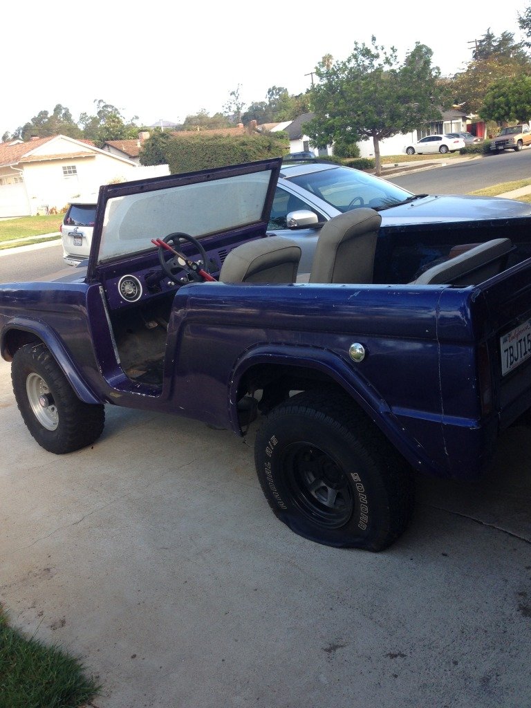

    Walked out front today and my 69 bronco had a flat. Might have to put a cage in it now.

    Yeah you do. And a lot of crap in the streets around your house. Can I drop off my truck and you get a flat and I'll pick it up in a month or so.

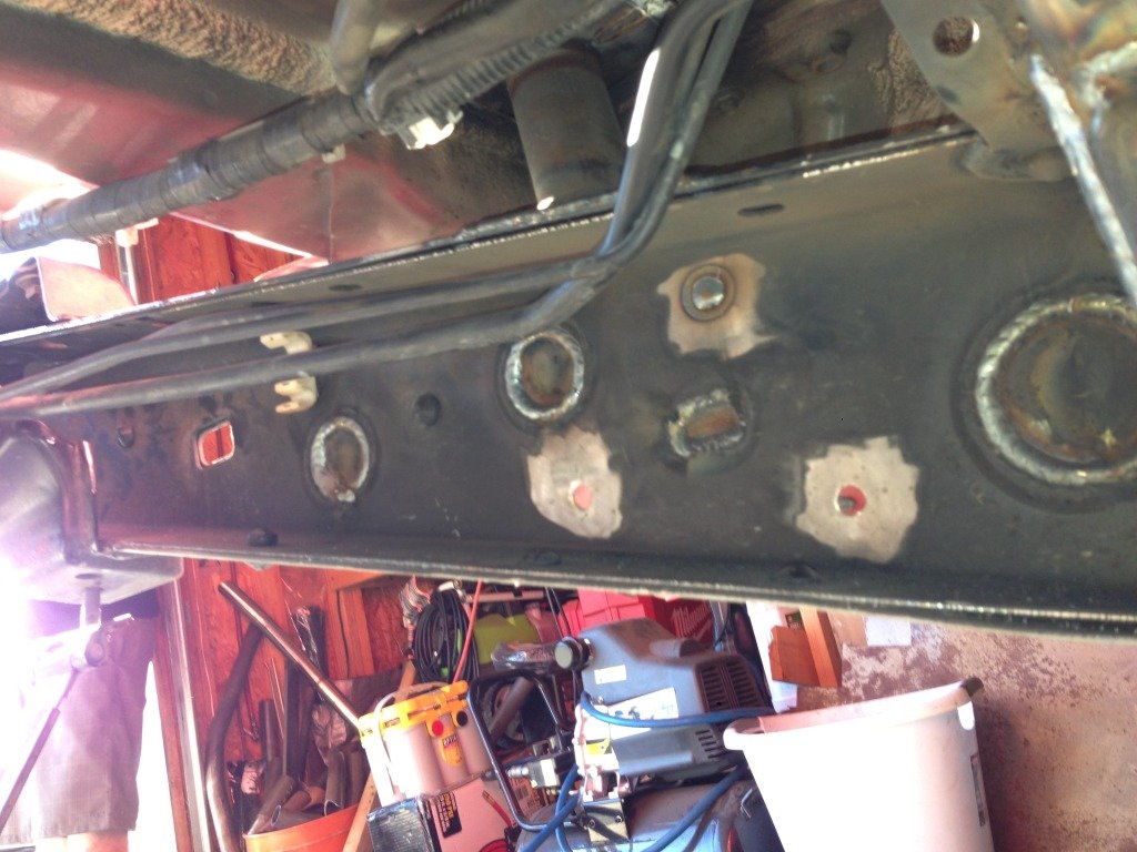

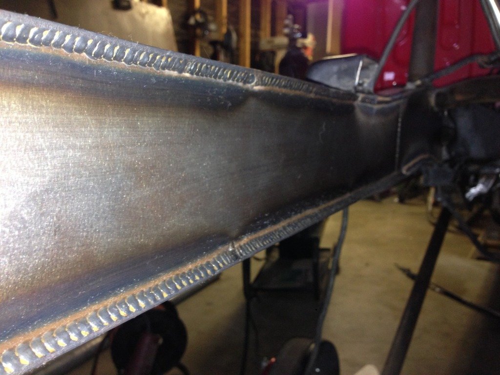

    So plating the frame = way to much welding.

    Mine was easier. Bent it first. Just chop it off and use 2"x4" steel. Lol

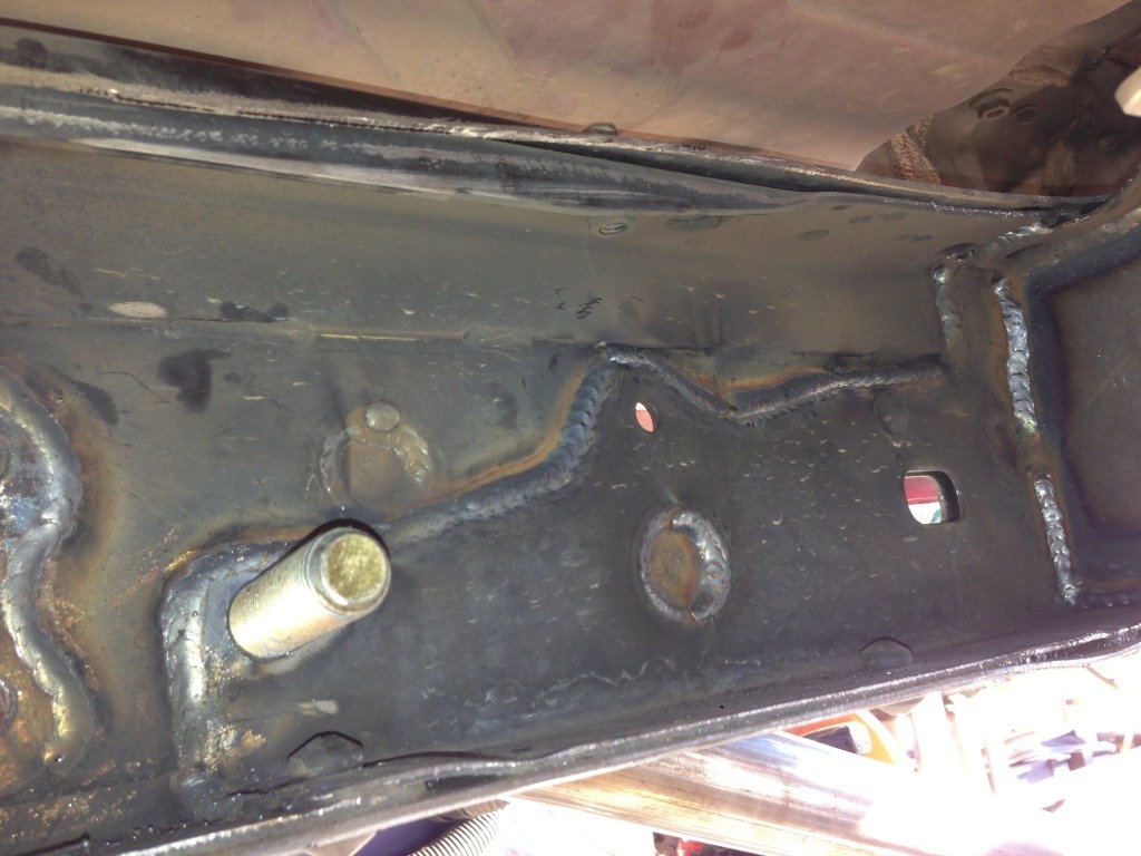

    Also welded the 2 sections of frame together before boxing it in

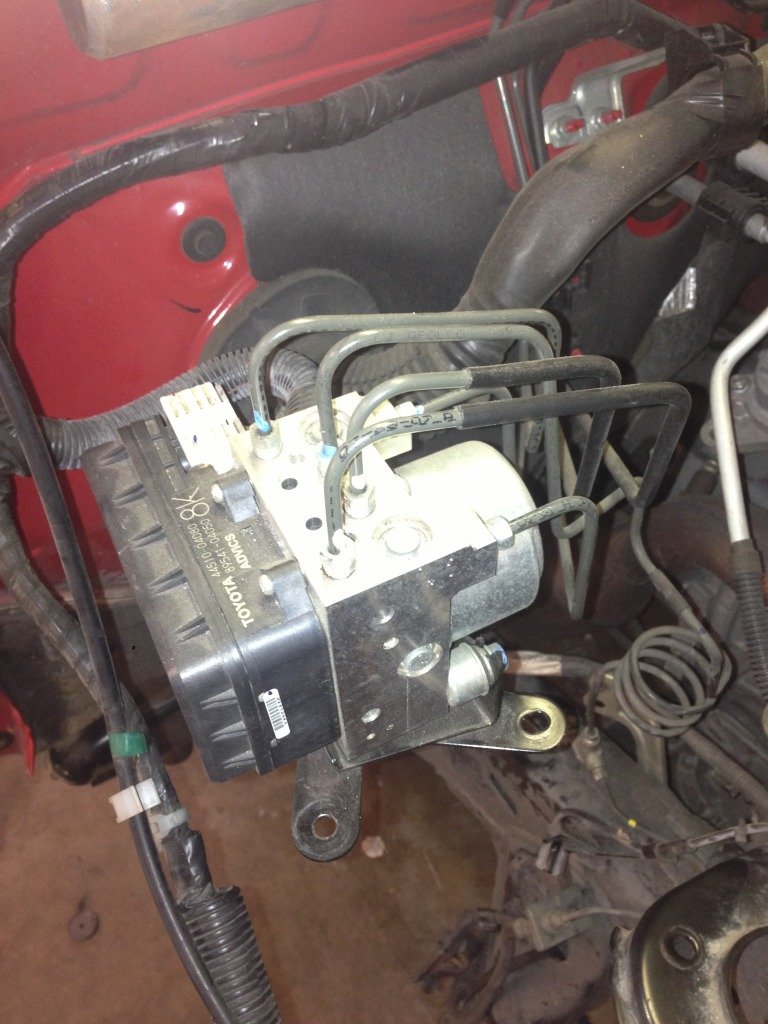

    So question? Has anyone removed the abs module?
    66F8E604-043D-4E1B-A2B3-2956DCCC2B32-773_3b42b33b5b460d39ff239998be4c70580027d543.jpg
    I'm really wanting to ditch it and run new lines. It would clean things up a lot and I already won't have abs on the front because of the dana 44 hubs. I just want to make sure it won't screw with the speedo or anything else with the ecu and normal operations.

    So after unplugging a buddies module on his truck, you do lose the speedo so it has to stay, but it does seem like you can pull just the brain of it. That would make mounting a lot easier and clean it up a lot so I will be trying that.

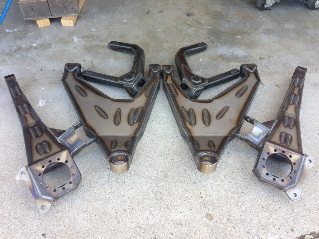

    Also picked the frontend up from the guys over at TRAC performance. I'm extremely happy with how it turned out. They are awesome guys to work with and do really good work too. I should have the kit fully on in the next few weekend. I'm currently beefing up all the lower mounts.
