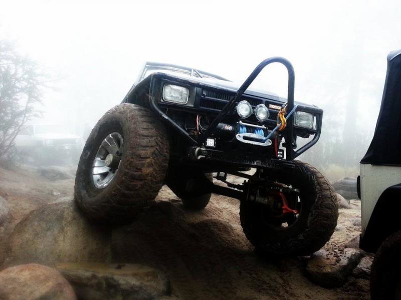

    Congratulations on the new truck! I'm taking study breaks and checking out your build - two nights ago I went through your mouse build from start to finish...
    I really liked it lol - one thing I'm curious about is the winch mount. My friend / fab guy is adding one for me to a prerunner bumper he made and is getting rid of now that he's caging the front end of his truck. We're adding a winch similar to the way yours is - I saved all the pics you had of it and showed him. If you have any up-close pics of how it's mounted and how you get to it to remove it and work on it that you don't mind sharing that would be awesome. Any tips are welcome as well! Here's the bumper:
    https://www.tacomaworld.com/threads/tube-bumper-with-push-bar.525898/
    Much appreciated!

    Thanks dude!
    Basically to pull the winch gotta remove skid plate in front, then hellas. 4 bolts and that's it... To be honest haven't pulled it since i installed it [​IMG]
    Over and out
    E
    Dalandser[QUOTED] likes this.

    Got it - so you have enough space above the winch with the lights out to pull it through the space above it between the bumper and the truck. I was thinking the bolts by those two vertical bars in front of the winch might have had something to do with it even though I saw the plate that the winch is mounted to is welded into place. Awesome design. Thanks brother. Hopefully I'll be out there on the trails by next fall and maybe see you guys out there!

    What winches did you guys use? I have a Shittybuilt XRC8 on my rock donkey and remote mounted the relay/control pack on my core support, would make getting it in and out for your setups.
    Are you talking about the 4 bolts bolting the bumper onto the front crossmember?

    Yeah that was my bad - it's the four bolts on the plate that the winch is mounted to. I wasn't sure about the ones that bolt onto the crossmember being something related to the winch.
    I've got an xrc8 from my old bumper that came with the truck. I wanted a synthetic line so I'm looking to buy a new one and sell the xrc8 due to the price of synthetic lines being a good chunk of what a new one would cost.

    The actual guts of an XRC8 for the control pack inside that plastic box is like 1/3 the size of the box, so super easy to remote mount the control pack behind the core support, then put the controller mount somewhere easy to get to, mine is in my grill. Makes the packaging of the rest of the winch really easy. Ya the diff between the "comp" and normal XRC8 is well worth the synthetic line since most syn line is generic china stuff anyway, and a standalone line is way too much money. I added a trail gear line to mine, it's meh. Nice syn line is nice.
    You can kinda see the plug for my controller on the left corner of my grill here.
    2081993d1452530814-big-boned-toyota-buil_cd967efda69791610aec127182c6cb9279d76b4c.jpg

    The 4 bolts on the bottom there so you can removed the TC sub frame. the winch is just off the 4 bolts attached to the plate....
    I have had 2 super winches
    SuperWinch EP9.0 winch With 100ft Synline on my rover.
    Superwinch 1145230 Terra 45 4500lbs on the mouse. Its actually a UTV/ Overland quad winch lol but my truck is so tiny it works
    Both have worked well
