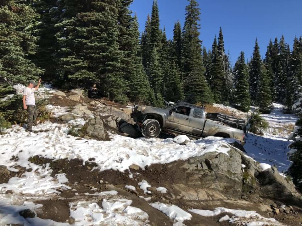

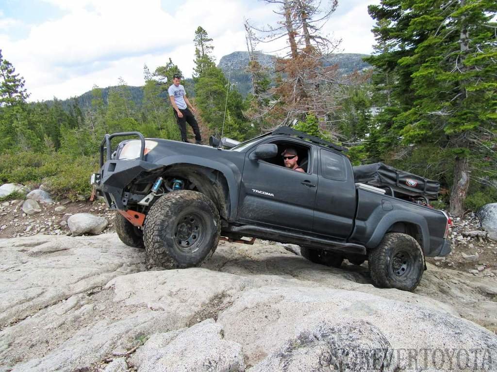

    been on a 1" BL for like 3 years. I've run all kinds of trails from easy Sunday drives to go check out a new fishing or shooting spot to Rubicon. never had a problem with it. I got the BL for two reasons.
    1. the bumpers I scored off a part out were made to accommodate a 1" BL
    2. I want to run dual cases and having that little bit extra room will be nice when the time comes
    this did not save my fenders from trimming with 35s.
