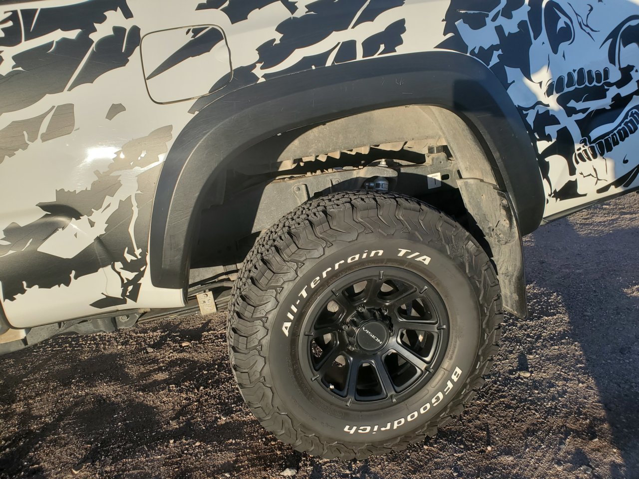

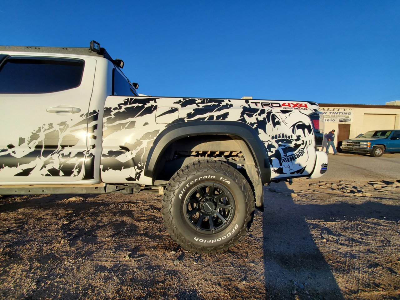

    Okay so I have bit the bullet on a lot of new stuff and have learned lots from you all on Tacoma World. I have had this truck since 9/2017 and its a 2017 dclb. I love my long bed and would do it again in a heart beat. So the new thing I am going to experiment with is putting a Toytec 1" body lift soon on this puppy. I run a very clear problem with the front bumper as it is a low pro I got from BA. I already chopped the front end up to fit the Body Armor bumper and may get a good gap now with the install of the Toytec lift. I will update you all on my project once I complete it.
    I have the bilstein 5160 6112 set up with the OME leaf pack. I am running 31.5 tires which rub hence the want for the Toytec body lift.
    UPDATE: Finished after 10 hrs....you do need the radiator drop brackets. Just loosen the 4 radiator support screws let the radiator sag a bit and attach the drop brackets. You have to modify your mud flaps after as well as the cab mount shoves them forward. Frustrated but done!!! Message me if you try this Toytec 1 inch body lift as I may be able to save you some time for the 3rd gen Tacoma install. I love it after it all!!!

    Great info. Your truck looks good. I am considering getting a 1” body lift, but haven’t fully committed. Can you send me a side shot of the rear wheel? I want to see what the frame gap would look like. Haven’t seen any gap guards for 3rd gen Tacoma’s for the rear. Thanks!
