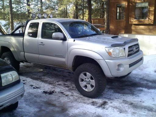

    Is anyone on here only running the Toytec 3" Front Spacer? Any things that are notoriously bad with Spacers? They are around $140..Here is the picture below...
    Also, who has Spidertrax wheel spacers? They only offer a 1.25" Wheel Spacer and I think I might be able to get away with a 0.5" or 1.0" spacer with my stock 16" Alloys and 285s. Thanks![​IMG]
