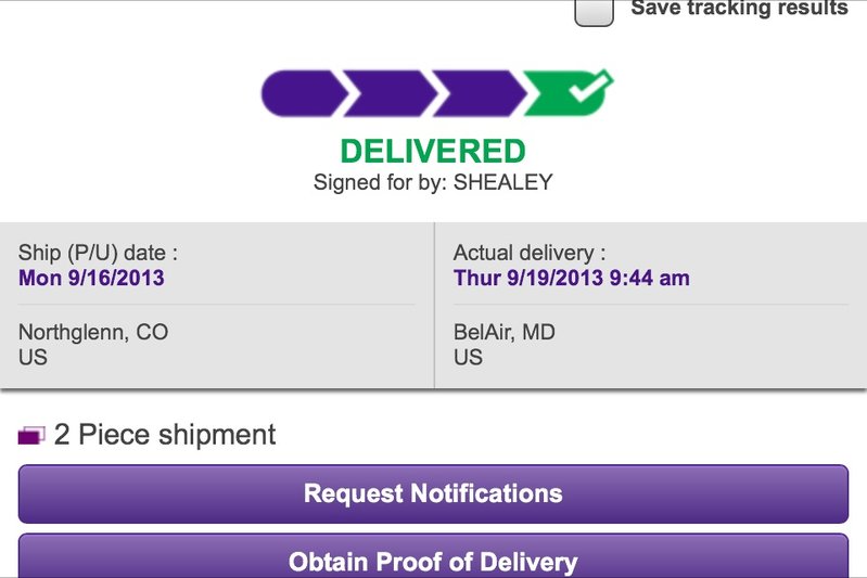

    lol. 3 days from the other side of the country pretty much.
