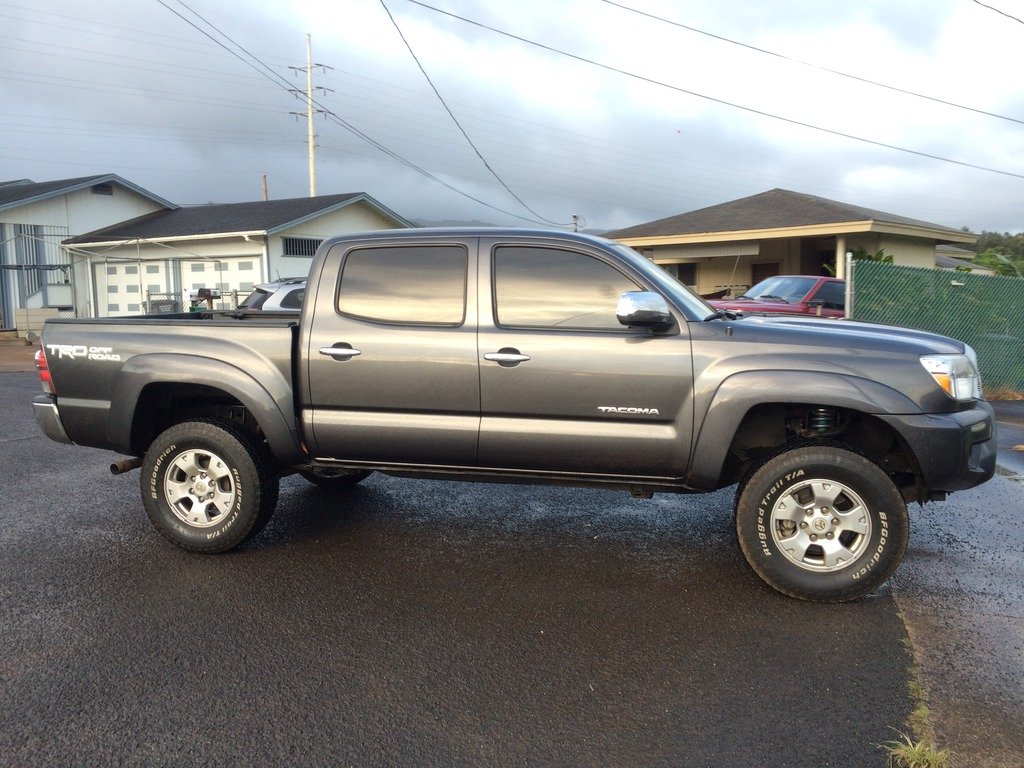

    UCAs not required.
    Ride is better than stock as is. Plusher than the stock springs.

    See original post. All the info is there. She wanted to go the cheap but better than spacer route.

    I have the 521600 with the top plate. I'm very happy with it after 50,000 miles. It's not the right choice if you're going to add front weight though. It's rather soft now.

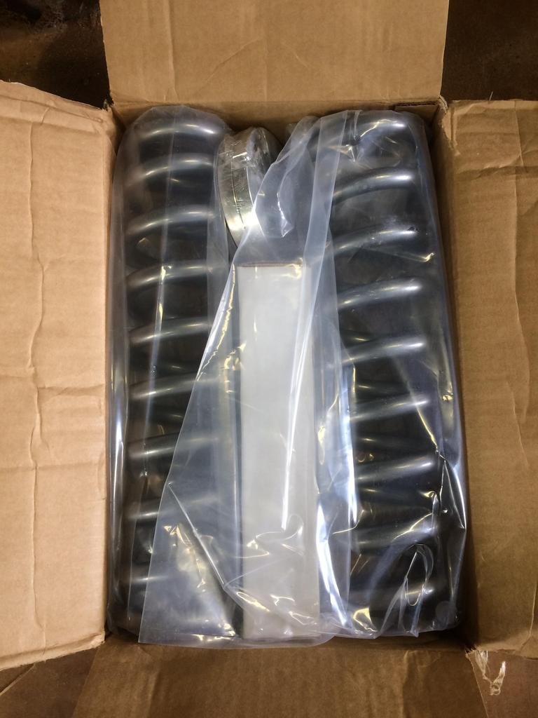

    This is the 521600 springs next to a TRD OR OEM spring when I changed mine:

    @rat107 did you use the oem top plate studs or did you have to buy extended 1.5" studs for your friends truck? thanks
  15. Jul 2, 2016 at 2:46 AM
    rat107
    rat107 [OP] Well-Known Member
    Nov 30, 2013
    #117633
    466
    Kauai, HI
    2024 TRD Off Road 4x4, Automatic DC/LB Bronze Oxide
    aFe Momentum GT Cold Air Intake System w/ Pro DRY S Filter
    The kit came with extended studs.

    @EdinCincinnati just got the 521600s in the mail. just wondering what kind of spacer you used? size and brand if ya get a chance. and whats the ride like. thanks!
  18. Jul 10, 2016 at 8:16 AM
    #18
    EdinCincinnati
    EdinCincinnati Well-Known Member
    Mar 11, 2013
    #99457
    2,445
    Ed
    Ohio
    2014 4x4 TRD OR
    I had the 1/4" spacer on both sides to achieve 3.0" of lift plus an additional 1/4" top plate on the left to accommodate the Tacoma lean. Both Bilsteins 5100 clips set at 0 - lowest. Bought the Toyteclifts brand spacers.
    Ive since removed the 1/4" top spacer and brought back down to 2.5" lift (lean spacer is still installed) because I had a roaring sound from the CV joint angle. Removing the spacer cured it.
    Ride is great IMO. Much better than using the OEM springs on 5100s. That was really stiff.
    In the rear, I removed the overload, added Deaver Progressive AALs from Toyteclifts - but I removed the smallest leaf. Have 5160s in the rear with Ride-Rite airbags.
    I also have my tires at 32 psi.

    @EdinCincinnati really appreciate the input man! Thank A lot can i ask what size tires?
  20. Jul 10, 2016 at 10:50 AM
    #20
    EdinCincinnati
    Mar 11, 2013
    #99457
    2,445
    Ed
    Ohio
    2014 4x4 TRD OR
    That picture is 285/70r17
    I've since changed to 255/75r17 to reduce tire weight to improve MPG
