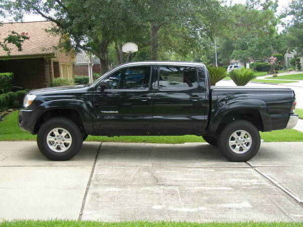

    I just install my 1.5 AAL this past weekend, but I also have the TSB. I do not have lifting coils but my 5100's are set to 1.75. I have a little rake, but that is what I wanted. Either way for you it wouldn't hurt. I personally just do not want to looking up at the sky with a heavy load or towing something. So I do not think it would look funny. Here is a pic of mine, my front looks high but drive way is slanted upward. Look at the base of my truck and you will see it is high towards the back.
