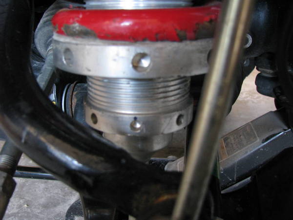

    How much of the shock body do you have showing under the small adjustment collar? I have about 1" showing.

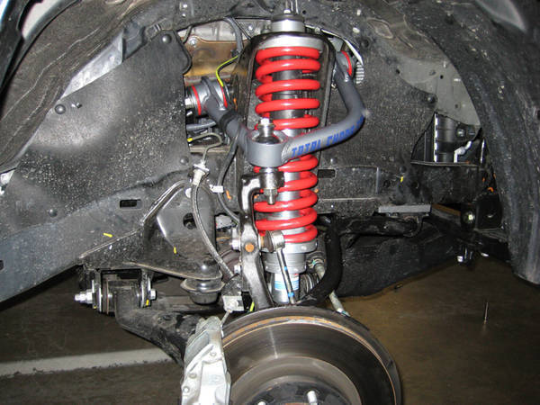

    The shock body itself or the threaded collar?
    Here's a picture of mine
    Since this photo, I've adjusted it down to where there's about 1/2" of thread showing below the adjustment nut. Also, I think the new coilovers have a longer threaded body.

    Here's mine.
    You have about an inch and a half more of your shock showing on the bottom than I do. I'm confused!!!

    No, you're good. I mistakenly set my c-clip at the .85" setting because I was given "old" instructions. That's why, when adjusted as indicated, I was sitting too high in the front and why I adjusted them down. It was easier for me to do that than to have them taken apart again to adjust the c-clip.
