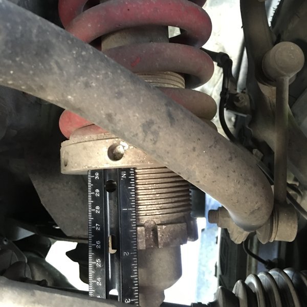

    I've been running those coilovers for 4 years, stock UCA's. Only had 1 3/4" lift dialed in. No problems at ALL which is a miracle, since I have over 1000 lbs extra weight with TAG bumper, sliders, full skid plates, camper shell, double battery, etc. It has compressed down to 1 1/4" lift, which is not surprising. Never dialed it back up, so it's a soft ride. Leaf springs are flat even w. AAL. About to replace them w. OME 886 setup & dakars to handle the weight, The ToyTec will be for sale soon.
    Then:
    Now:

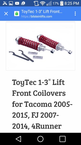

    These are the ones I am talking about I think they are different from the bossScreenshot_2016-06-11-20-25-42.jpg

    those fancy toy tec coil overs are NOTHING more than 5100's with eibach springs and an adjustable collar and a fancy top hat with a STUPID high price tag.
    You can get the Bilstein 6112's for cheaper pretty much anywhere and have a MUCH better shock AND they come with coils too...
