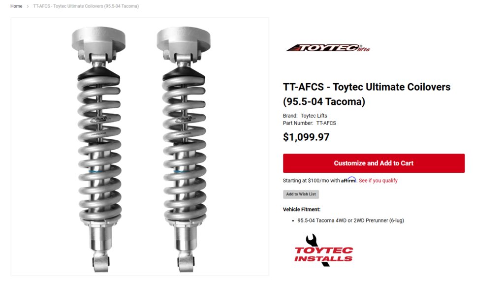

    I have emailed both respectively but just in case I don't hear back, does anyone have a part number for the threaded-bodied shocks that are found on the Toytec/ All-Pro coilovers? Mine are about a decade (or more) old and likely in need of replacement. Since both companies are selling virtually identical kits, I would assume the shock is a generic, off-the-shelf Bilstein part.
    Thanks
    I am referring to these, if anyone was wondering: Toytec almost identical set:

    This is on their website as of right now. This looks like the 24-186520, but I'm not sure if the shock top eye is able to be removed to slide the spring top mount on or if you would have to disassemble the shock body and pull out the shaft to get the spring top mount on.
