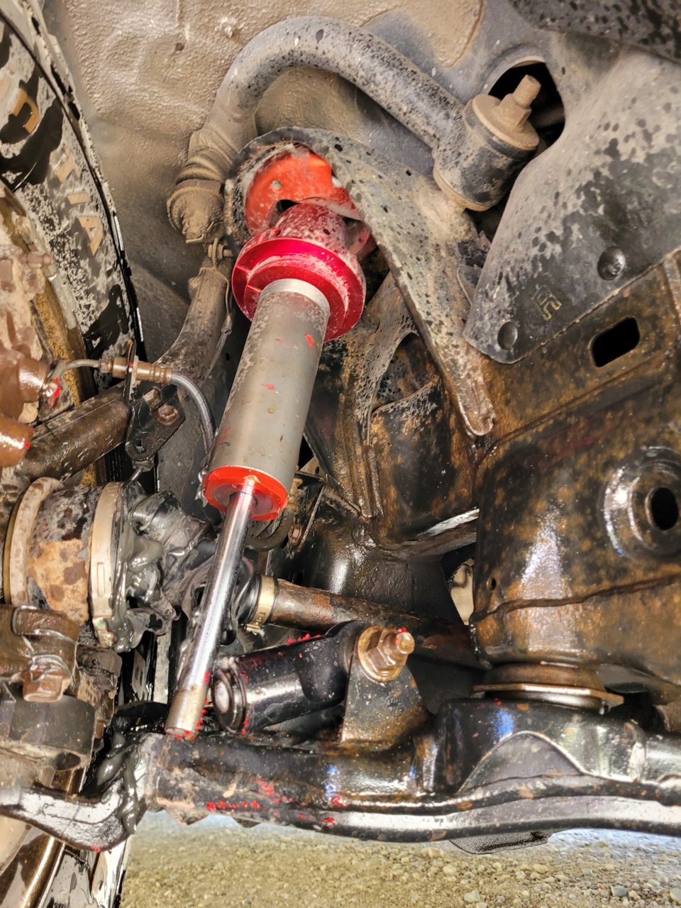

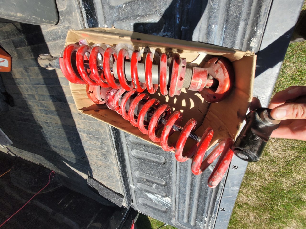

    Warning concerning Toytec Boss 2.0 Aluma Series Coilovers! These pictures are from a 2006 Tundra dbl cab. The coilovers are less than two years old and have never been abused. 97% pavement and about 3% gravel roads. Absolutely unacceptable. I would remove them from my truck immediately if you have them! Broke while driving 20mph(thank god!) on the pavement.

    Yikes!! Sorry that happened to you. That sucks it messed up the cv axle too.

    Yes, the brake caliper and axle were destroyed.

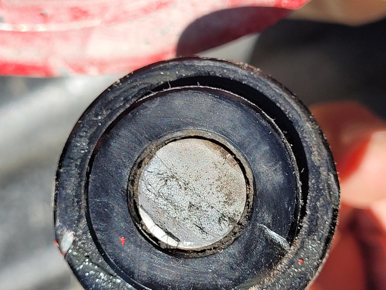

    I really don't understand how that's even possible. It looks like the shaft just sheared off at that point, but all the force on it should be compression so it doesn't really makes sense. They even have a pivoting top hat to allow lateral movement as the wheel cycles... Maybe there was a manufacturing defect in the metal shaft.

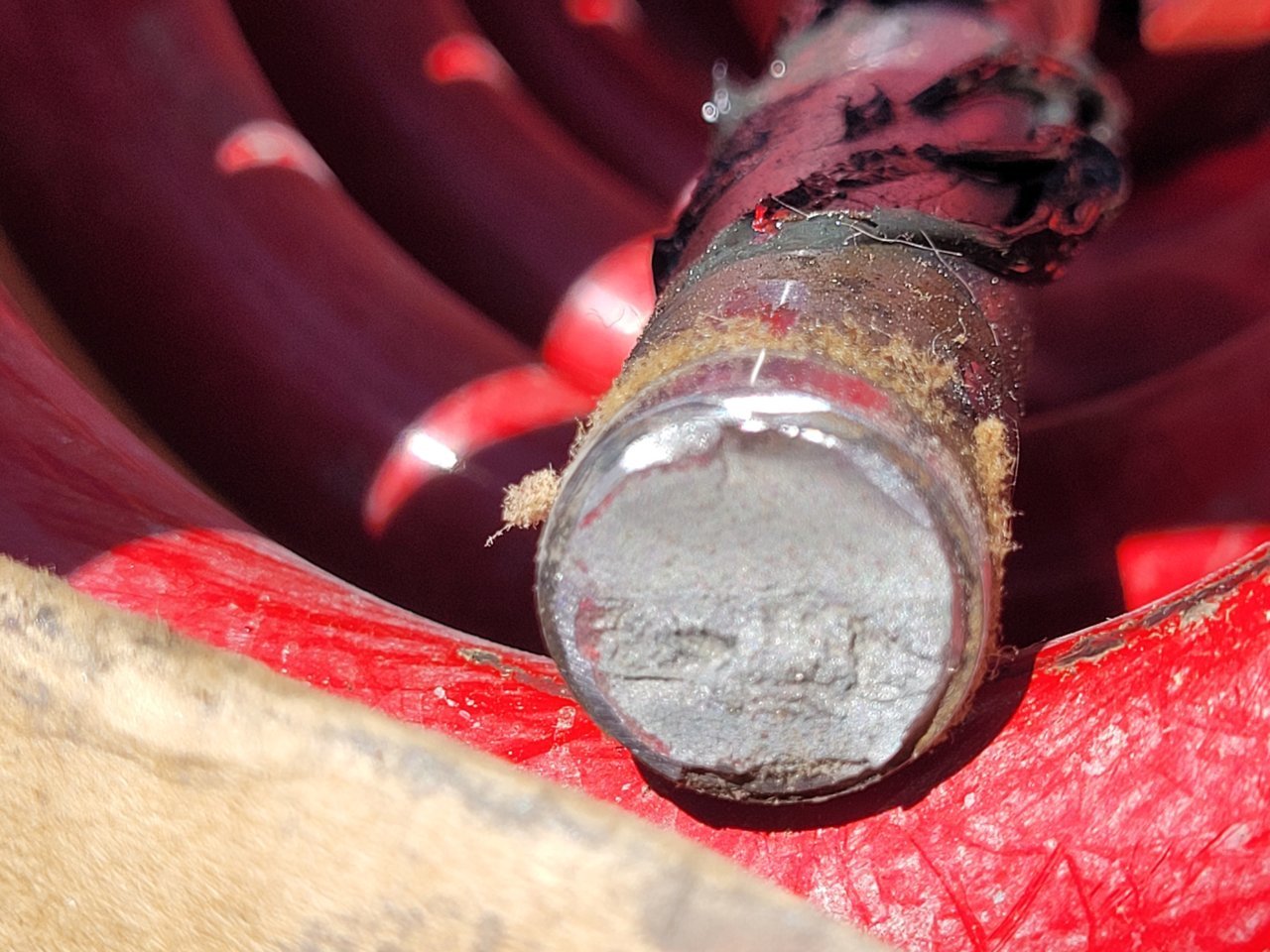

    think your right about manufacturing defect given how half of the shaft is smooth.

    The lower mount was not seized and still turned smoothly(mount bearing on black end of Piston shaft). Toytec didn't want to know anything about it. I think it's a defect.

    From a machinist perspective, I don't see any sort of relief or runout for the last thread and it looks like a stress riser started at the root of the last thread. Improperly designed.
