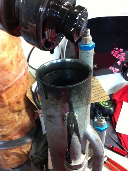

    Did you open them up to see how black the oil was?
    I'm not saying OME doesn't have a place but like any shock every made the oil doesn't last YEARS and 100K+ miles in a anaerobic environment with zero filtration and a starting volume of maybe 400 CC's of oil.
    jberry813 likes this.

    I don't work in the shock industry, or off-road industry at all. But expecting to get 40k out of shocks in an off-road rig is definitely not realistic. Oil in the shocks breaks down with heat. Heat is caused by the friction created from oil passing through valving as the shock cycles.
    Everyone's definition of a weekend warrior is different. If you are only hitting the dirt a couple times a year, then ya. 40k no problem. But if you are doing it once a week, not so much. I have to rebuild my shocks every two years because I bake the oil. Once it turns into a black frothy mess, the dampering becomes unpredictable and fades significantly faster.
    A leaky shock is not the only definition of a blown shock, especially with IFP/non-emulsion shocks. Blowing the IFP seal causes nitrogen to mix in the oil cavity creating a hydrolock. At that point you may as well have concrete in your shocks. What it boils down to is budget and owner requirements. The best part of a quality shock is the ability to have it valved for your rigs weight and your driving preferences.
    TMFF likes this.

    How many shocks have you opened up after 20K? 40K? 100k? Do you change the oil in your engine? Transmission? Differentials? Why would shocks be any different? The motor is still running with 20K on the oil and no filter change, why spend the money on a oil change if it still works?????
    I have taken enough shocks apart to have gained the experience to know how long 3 pints of oil will last in a shock. Hell I have rebuilt race shocks with 1K miles on them that smelled like a donkey die inside. And DD/weekend warrior 2.5 remote resi's with 20K that you could still see the color of the oil.
    Bottom line, the oil doesn't last forever.
