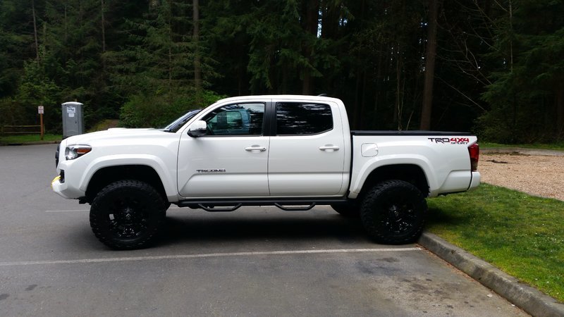

    I went with Boss 2.5 w/o resi., AAL and SPC UCAs. Love the ride, little stiffer than TRD sport stock. I'll post some better pics.

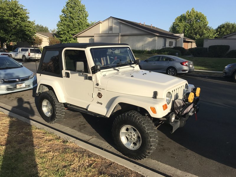

    Just thought I would post what I am stuck driving until I get Tacoma off jack stands. Two different beast for sure.

    I wouldn't mind being stuck driving that thing. Looks rad :)
