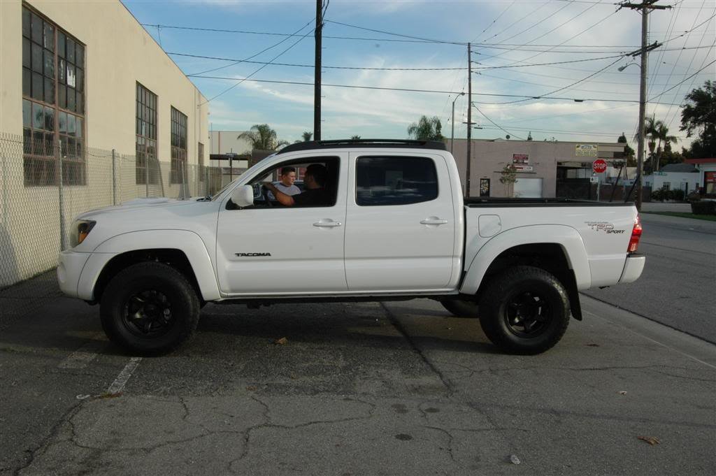

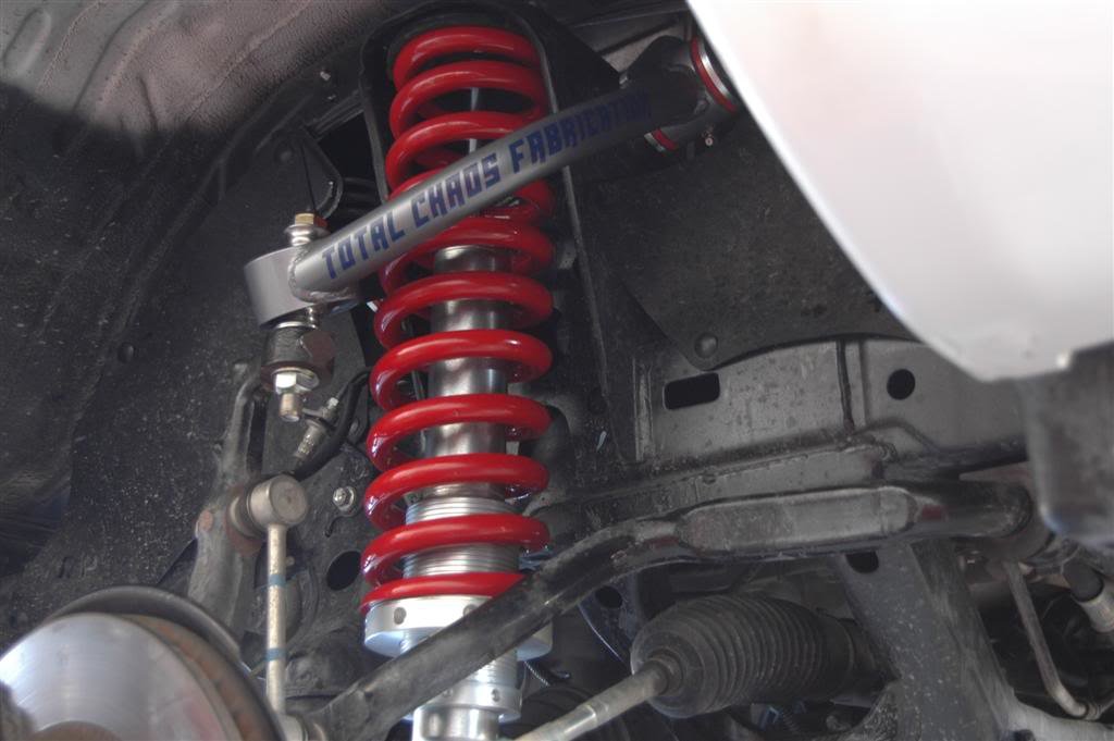

    Here are some pictures. Right now my truck looks fugly with that nose dive! BTW, the rear has the TSB + Toytec TSB AAL.

    Looks like it to me, but "something" has to be wrong. It's almost as if your truck is LOWER in the front than stock...

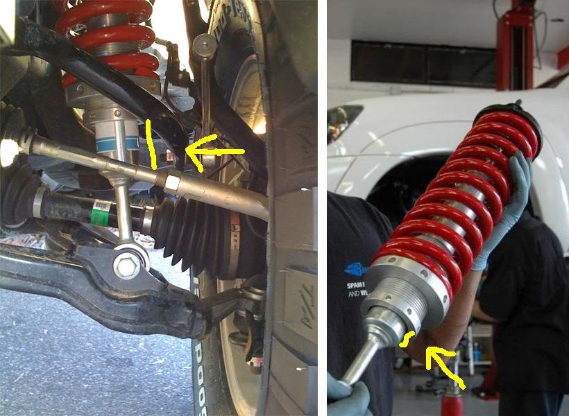

    Man... this really sucks. I have no idea what could be wrong. I know both my tires are rubbing and I also keep hearing all type of ugly noises :confused:. The tires already rubbed the paint off my inner fenders :mad:. Is it possible that I might have the UCAs installed wrong? Can that cause these issues?

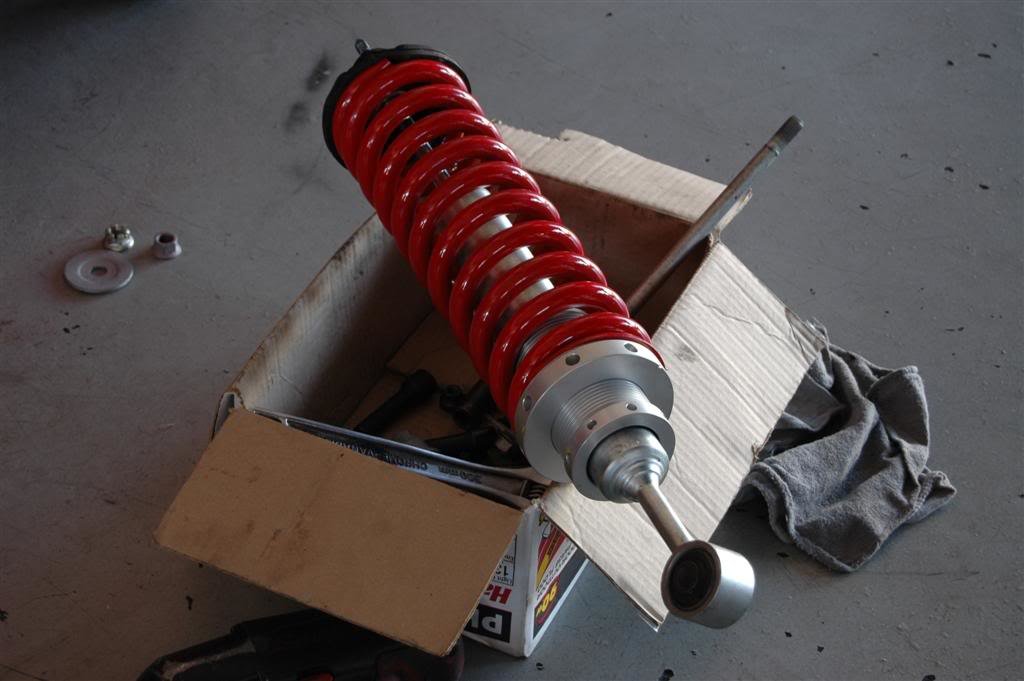

    Here is how I assembled my shocks/coilovers. From top to bottom:
    Nut
    Washer
    Rubber Boot
    OEM Top Plate
    Washer
    Coil/Spring
    Toytec Coilover Body
    5100 (Lowest Setting)
  16. Dec 7, 2008 at 12:33 AM
    #16
    dtrujillo63
    dtrujillo63 [OP] Well-Known Member
    Aug 28, 2008
    #8827
    859
    Denny
    Los Angeles
    08 Tacoma DC 4x4 Sport

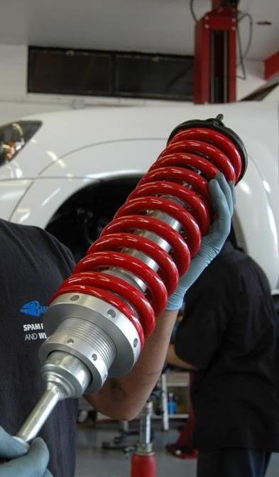

    I think I just figured it out, I was looking at loghorn's installation pictures and I noticed a huge difference!!!!!!!!!!!!!!!!!!!!!!!!!!!!!
    HOW THE #$&! did this happen? I set the clip to the lowest setting and that's where toytecs body landed.

    Looks like the threaded adjuter part is not mounted correctly. Pull them off and re do them.

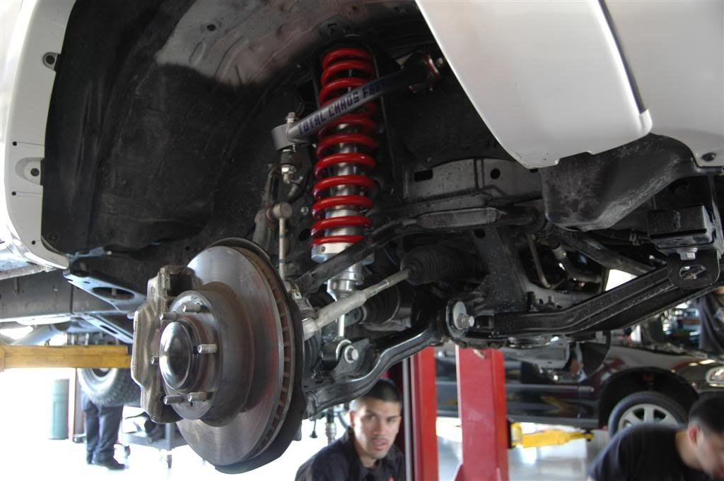

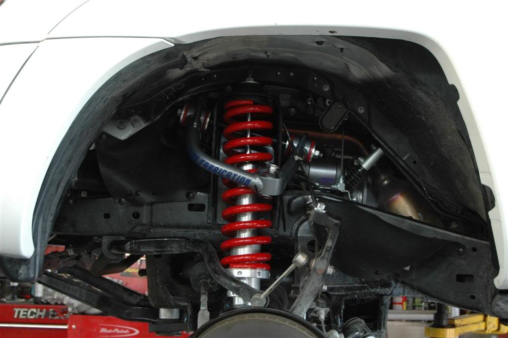

    Don't look at mine as a reference... I did mine wrong. The instructions I got were apparently "old" and it told me to set the 5100s to the second setting (.85") then adjust the nut to 1" of thread. However, this lifted my front end almost 4.5"!!! :eek: BAD!
    Anyway, I called Doug and he told me I could leave my shocks set where they were, just adjust the nut all the way down. So, rather than pay to have them assembled again, that's what I did and I've got just over 3" (~ 3.15-3.2") of lift. But, I never took anymore pictures of it after I adjusted them down.
    That's why I didn't post pictures of my setup in this thread... :p
    But, something else seems to be wrong in this whole setup for you, so I would call Doug tomorrow and chat with him about it and see what he says.
    Here are some "better" pictures of someone that set them properly (unlike me...). This is silver07taco:
