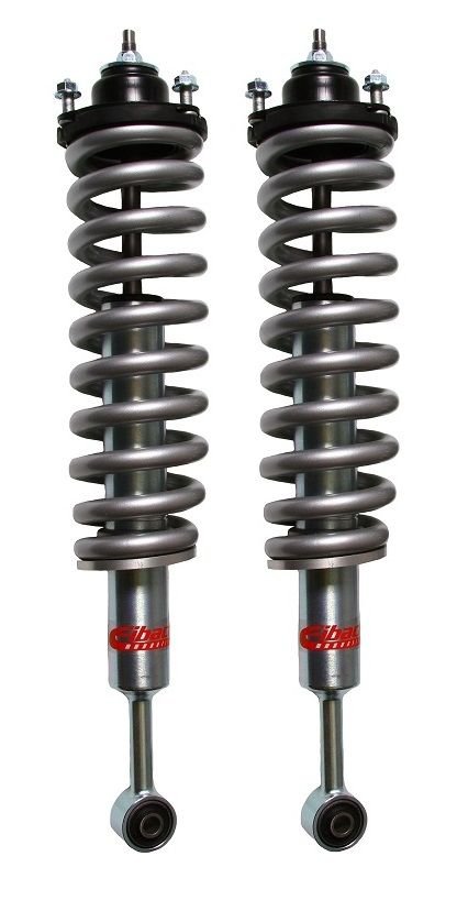

    ok...local shop gave me round around with order of bilstein 5100. so i cancelled order! theres other shops locally to do the installation. but this time im gonna order shocks myself and take them to shop to install. what do you guys think of....
    TOYTEC/EIBACH 2″ LIFT FRONT COILOVERS FOR 2016-2019 TOYOTA
    TACOMA
    price seems good all pre assembled. sold as pair. looking for 2" lift as stated in front and a 1" block lift in rear....so my front will be 37" and rear 38"

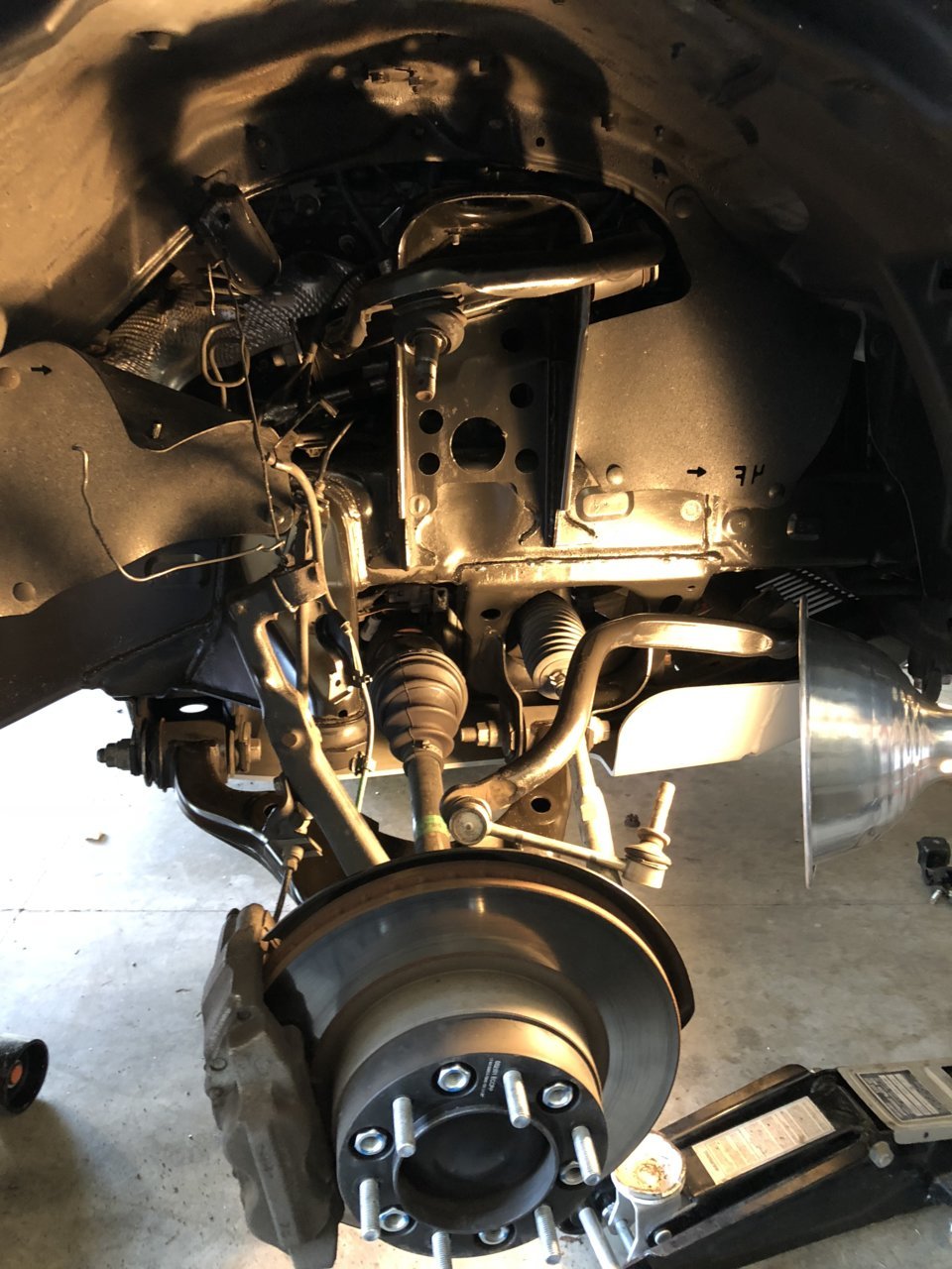

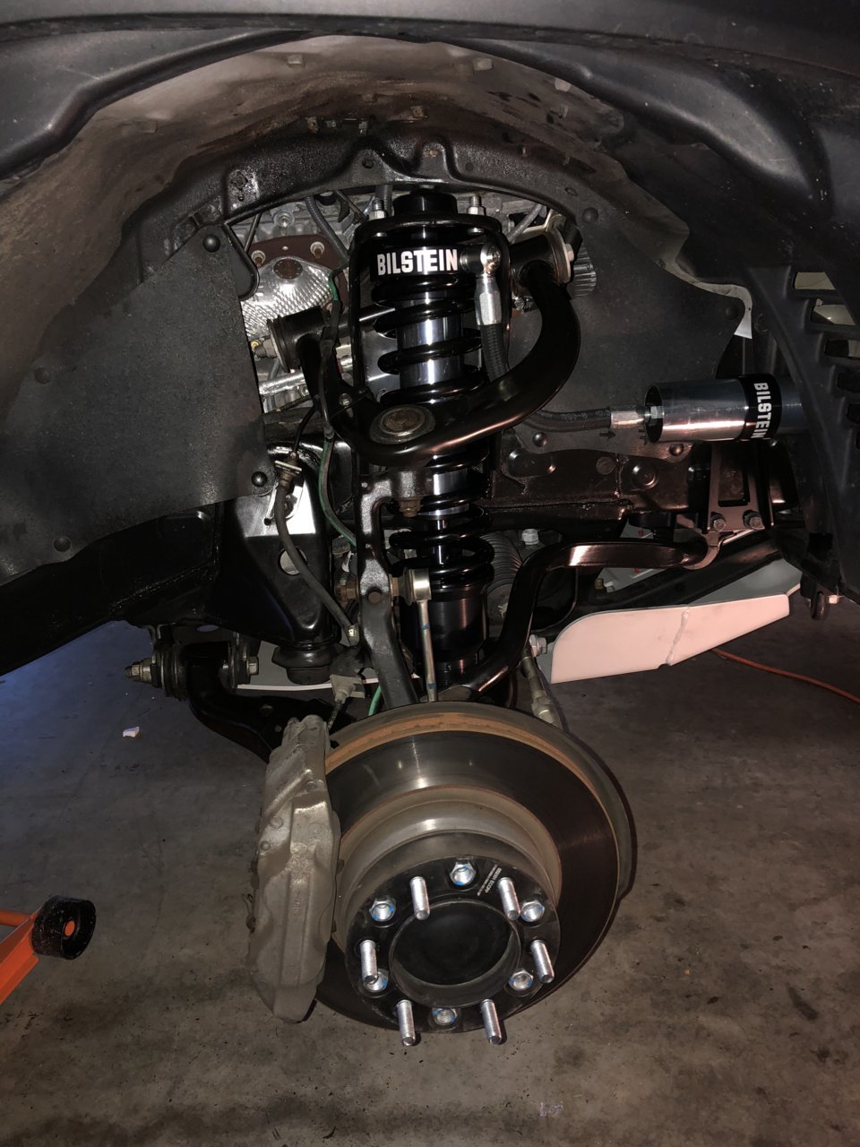

    Pretty easy to install coilovers on a Tacoma no special tools don’t even have to touch the brakes or lower control arm. I would do it yourself with the money you save buy better coilovers as $600 coilovers won’t be much better than stock.

    I installed this eibach lift a couple months ago. Did it myself in about 3 hours total front and rear. Truck rides smooth and handles better than factory. Make sure you get a good alignment afterwards.

    2.5 in the front 2 on the rear, so it still has a slight rake. I'm kinda waiting long term to see if the front settles any...none yet.

    2018 TRDOR 3.4L. Yes that exact kit, front came assembled and rear has a wedge included. Diff drop spacers, (I didn't install yet)
