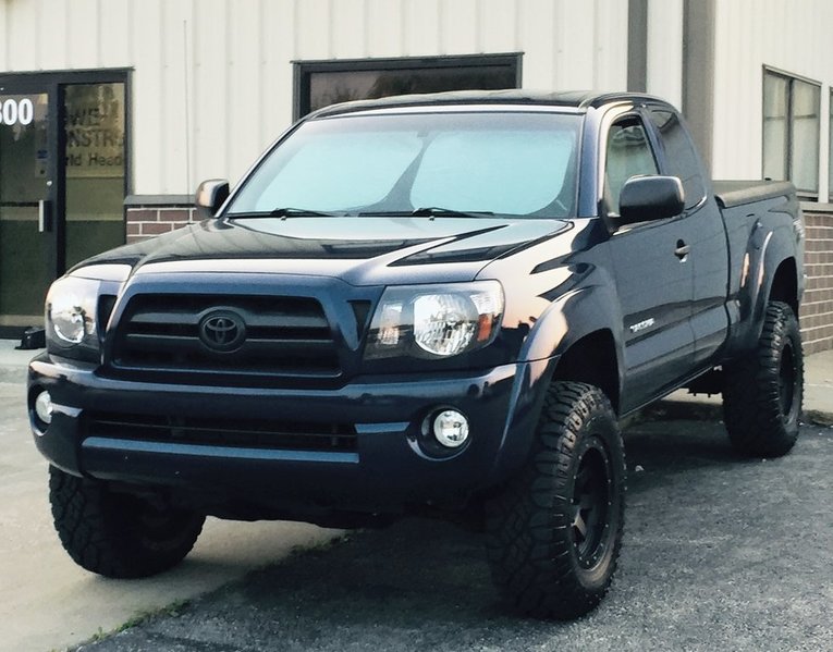

    I have the eibach spring w/bilstein 5100's set @ .85, Light Racing UCA's & 2" AAL's in the rear.
    Nice firm ride, tracks well & I get about 3" of lift with the access cab TRD ORFullSizeRender (00000005).jpg

    Nice rig @camo junkie what size tires are you running?

    3" lift OME lift 887 coils, LR UCA's, 16" Stealth Custom Series Wheels and 265/75/16 Duratrac Tires
    Tires are 265/75/16 Duratracs1.jpg
