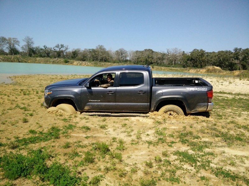

    I'm more qurious to how you got out of that mud:D:D:D

    lol I wanted to test the crawl control, but it didn't work.
    Had a tractor pull me out.
