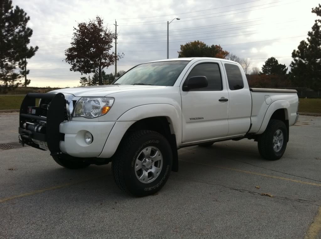

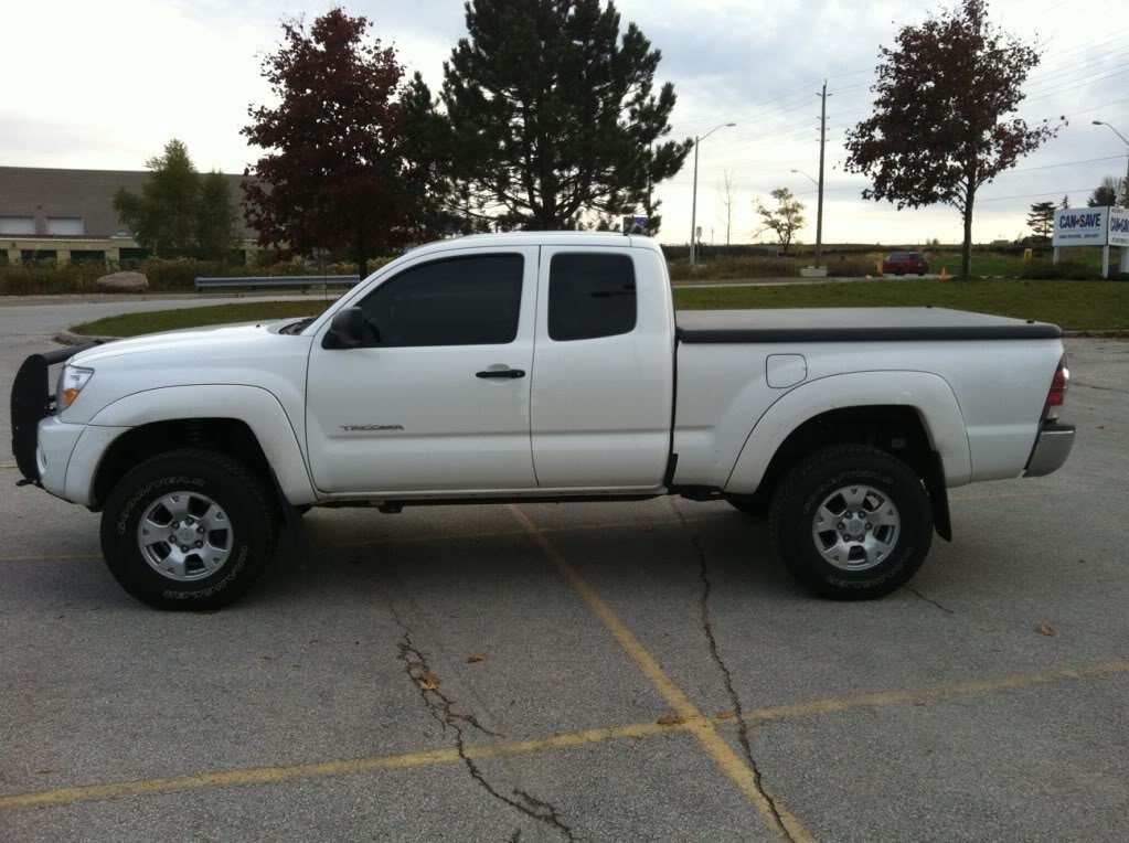

    I had Eibach's and 5100's installed a while back set at .85. I was happy with the ride but with the weight of my winch I didn't get the full 2.5 inches of lift. Yesterday I had the 1.5 inch AAL installed in my TSB leafs and one top plate spacer on the driver side and the lean spacer on the passenger side. The front is even from side to side and sits at 22 and 7/8 inches from hub centre to fender lip. If I remember correctly, I think I got 2.75 inches of front lift now. I didn't change the rear shocks yet. I'm gonna drive it like this for a while. I'm wanting a DB lift but not quite ready to pull the trigger on that yet. Happy to say it drives nice with no vibes and such.
